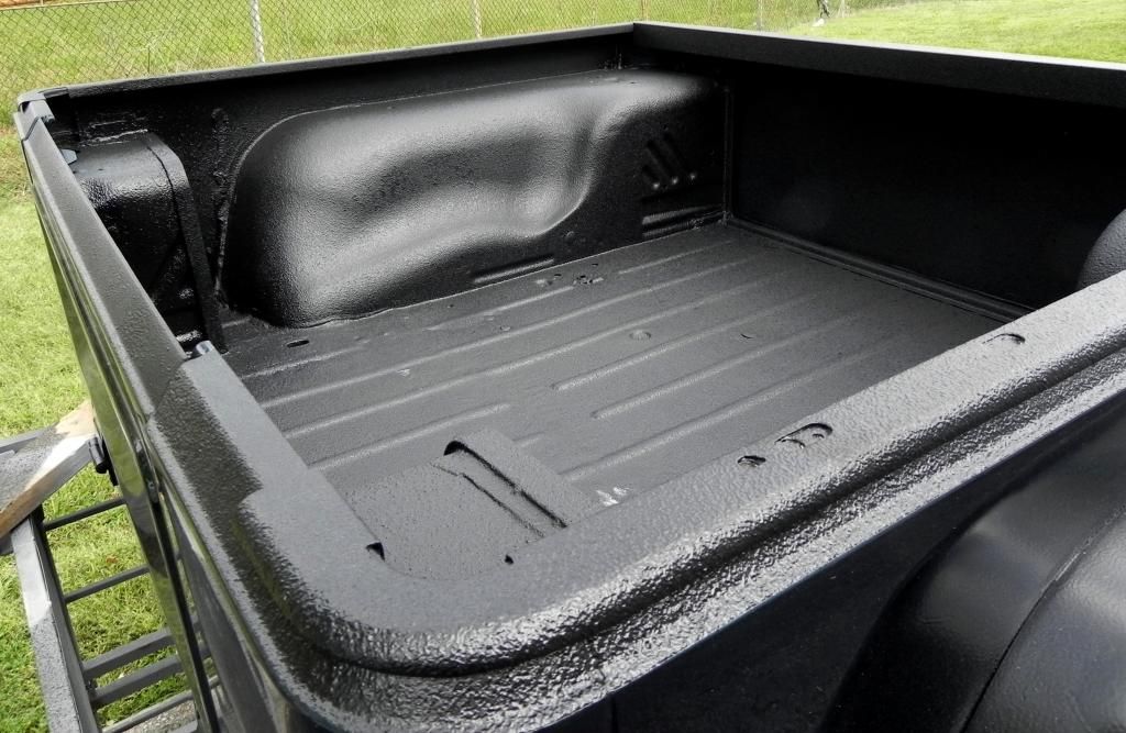

Hendrix wasnt happy with the instagramish feel of the last pics so he sent these .

what kind of liner did you end up going with? Looks like raptor liner but maybe that's just how Line X looks when new. Looks great anyways.... I just want to see it on some nice wheels and 35's now. Please tell me you have some black wheels lined up for it???

I sprayed SEM Rock It liner on it. Sprayed all four quarts of material in the kit on it. It's real similar to Raptor. It sprays so nice, smells really good too.

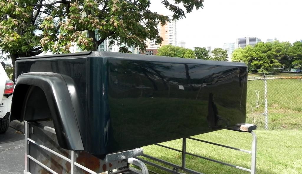

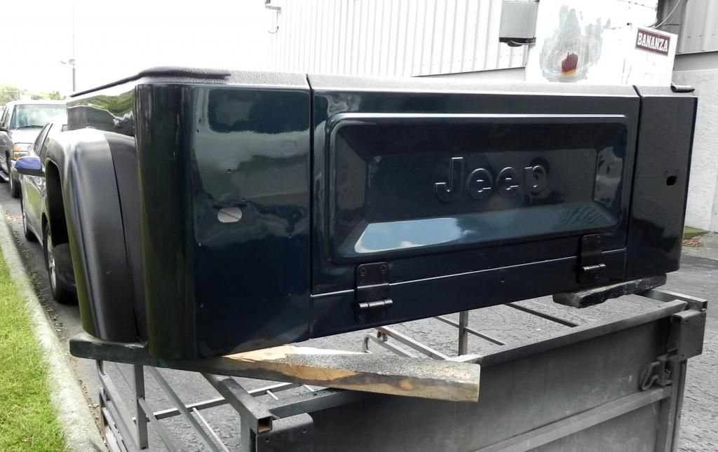

Today my wife and I broke down 5 beadlocks and manually broke the rear beads so that the new owner of the Firestones could come pick them up . Kimbo ran the impact and removed all 160 bolts and then she gracefully stood on the tire as I worked the pseudo tire irons . All told it took us two hours to get all five tires removed . After the tires pick up was completed I took Hannah out for some 4 low yard crawling . To her surprise I hopped out of the Jeep and told her to slide over into the drivers seat , so at 2 mph she drove all over the yard until Kimbo called us in for dinner . Hannah fell asleep grinning ... Billy informed me that tomorrow was his day to drive the Jeep
In between the time spent running the temporary tire store and letting a nine year old drive we cleaned up the garage a good bit . After church tomorrow the trailer tub will get offloaded onto its temporary home , which is the table saw /outfeed table . This will allow me to make a few changes to the frame and not have to worry about the paint . The beadlocks are going to get a good cleaning too , there was a bit of oxidation but overall everything looked good . It is good to be home ...

Unloading the tub today was silly easy thanks to the unisaw and the out feed table . It was the exact same height as the tailgate on the rental truck and thanks to Kimbo's donated blanket it slid right over the nicely waxed table saw .

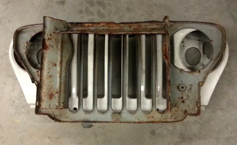

Heres the MB and TJ grilles laid on top of each other . They sure make for strange bedfellows . Not sure if I am going to pursue this or not , after talking to Hendrix I am considering notching my grille and sliding the winch back . This would allow me to trim the frame back the sway bar cross tube , and that would probably give me the little bit of clearance I need .
