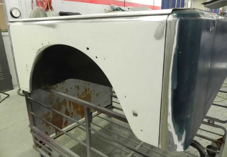

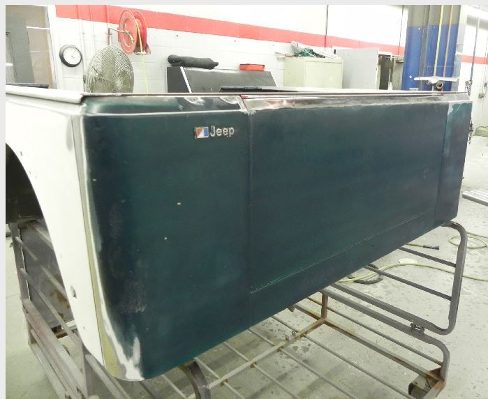

I skin coated his to make it uniform. Both sides are actually finished in 180 grit and ready for primer. I just need to skim the front panel and corners to prime it all Saturday morning. Hopefully fully painted by Saturday afternoon, if not Monday night it will be green again. The flares are getting a semi gloss Hotrod black. The inside is getting the bedliner treatment wrapped over the belt rail.

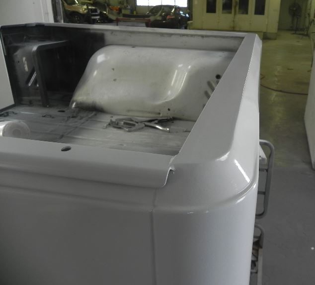

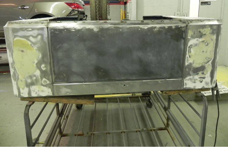

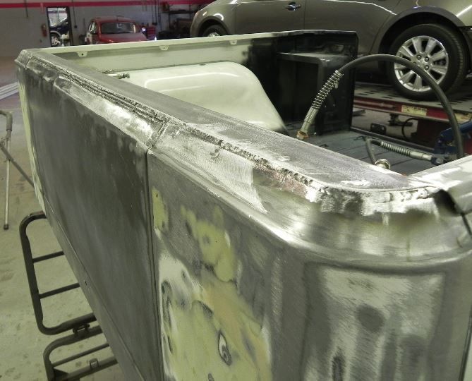

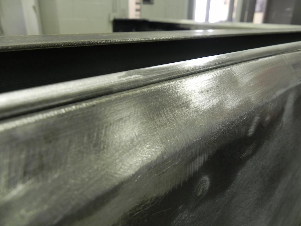

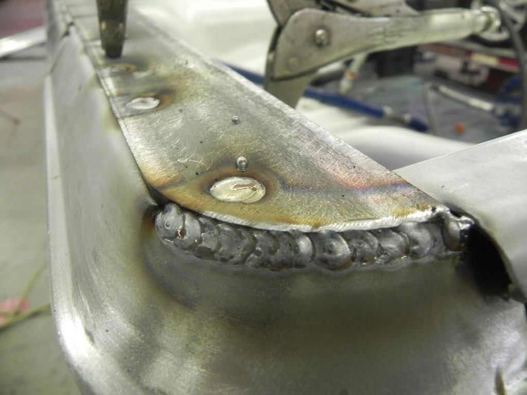

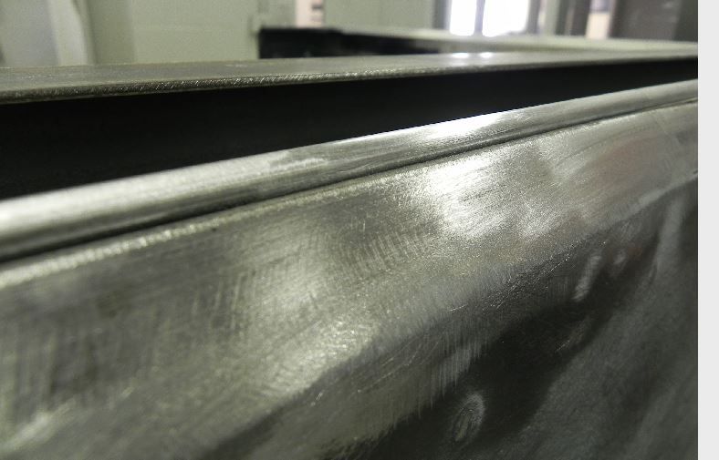

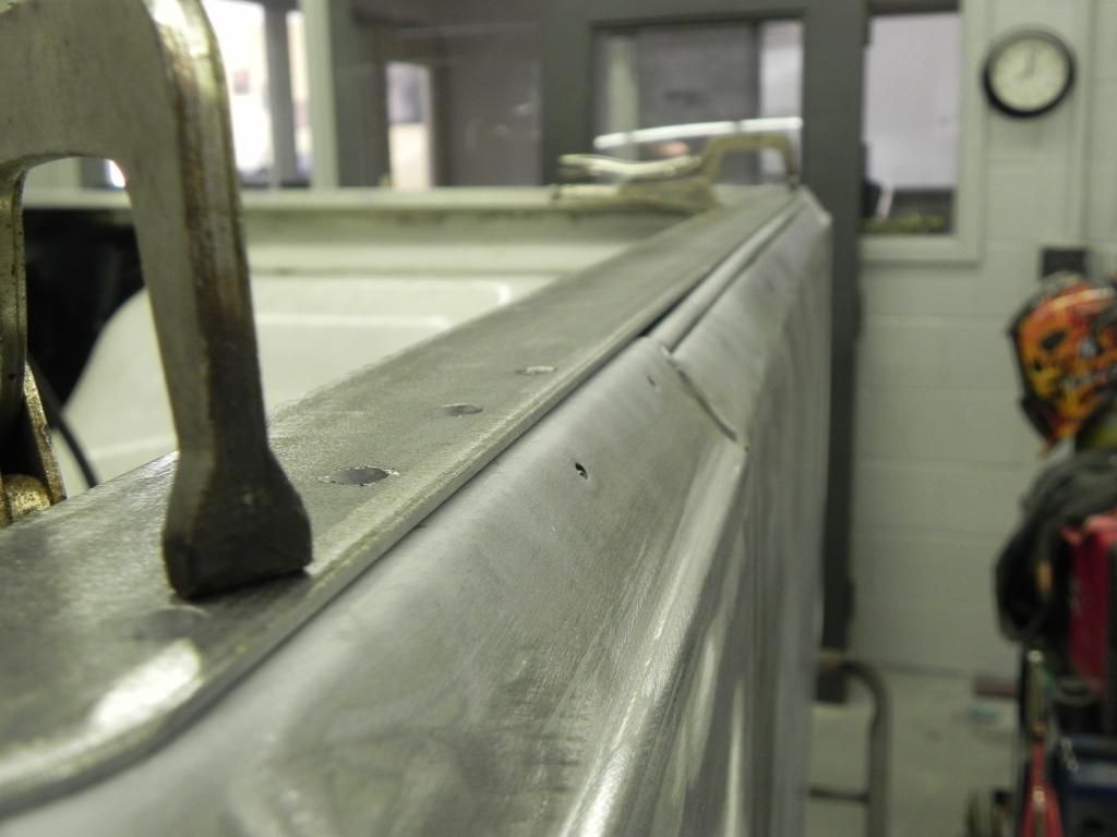

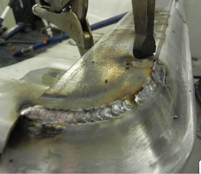

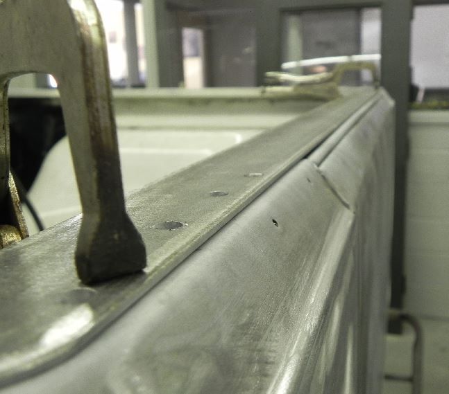

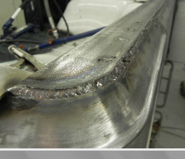

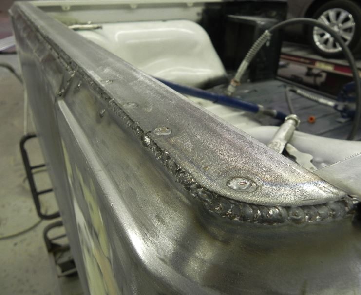

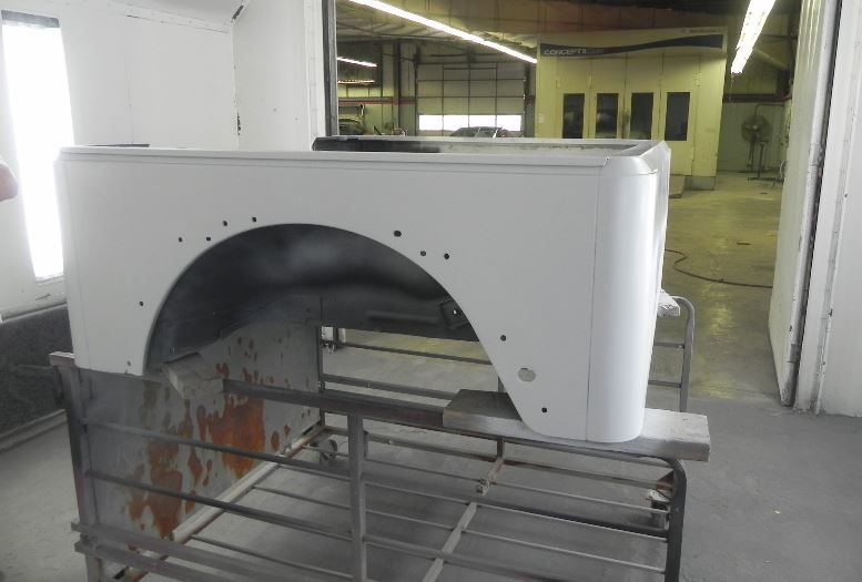

Didn't make it to paint today. The front panel kicked my ***.
Here is the hinge plate filler 5/16 rod welded between the plate and front panel:
welded and smoothed.
Got it in primer today:
Beasley has the rest. He can upload them when he gets Internet.

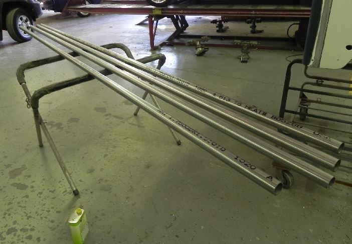

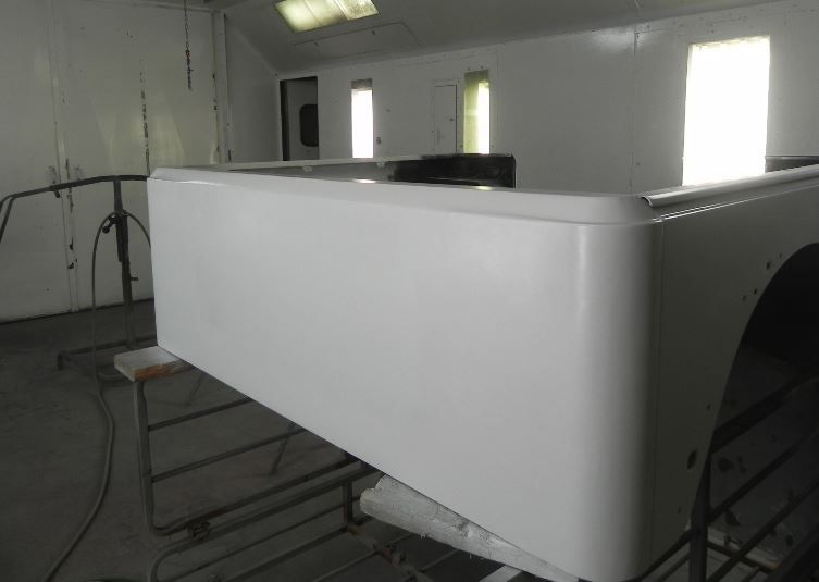

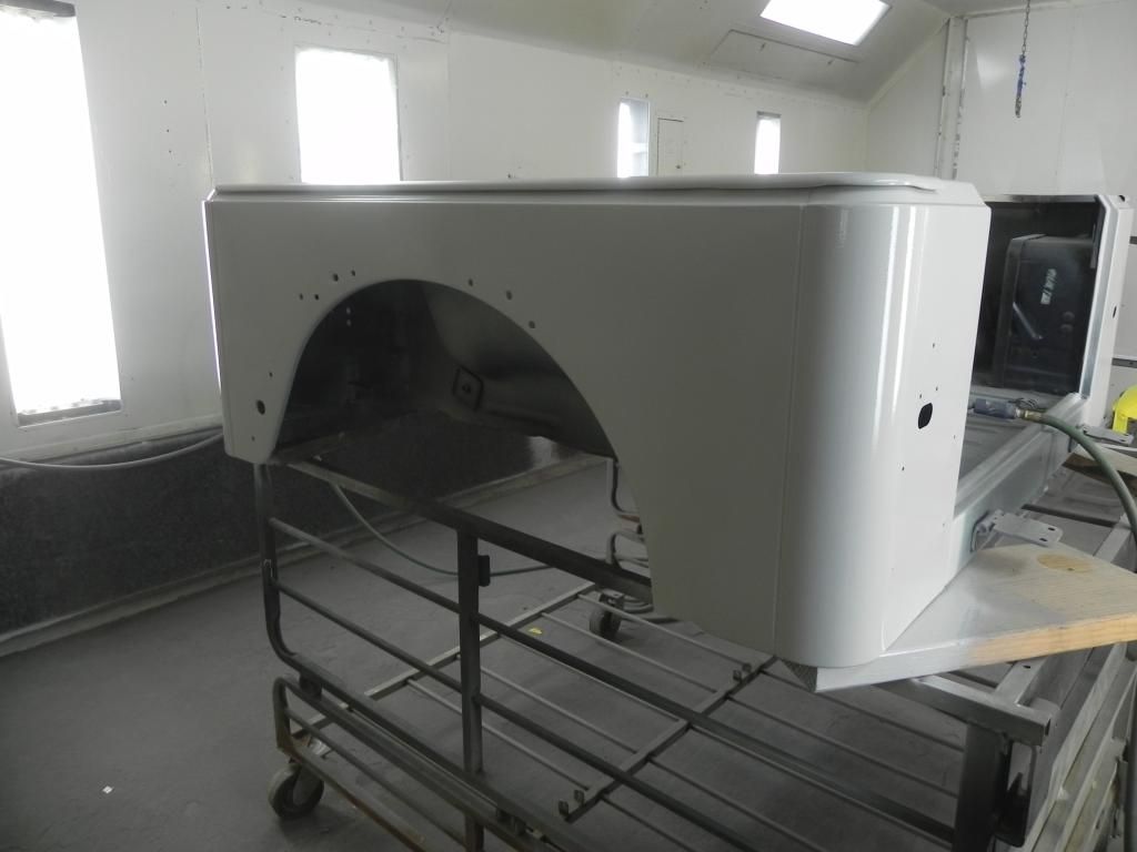

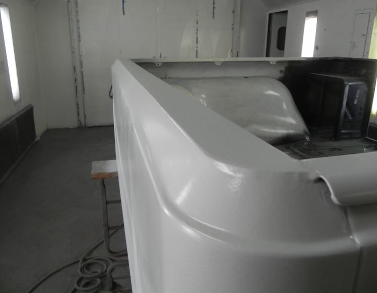

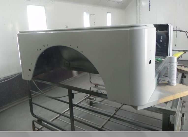

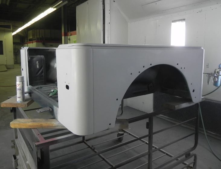

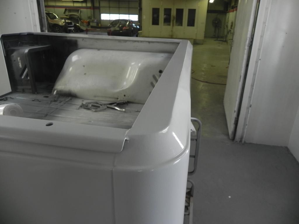

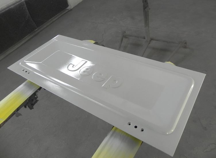

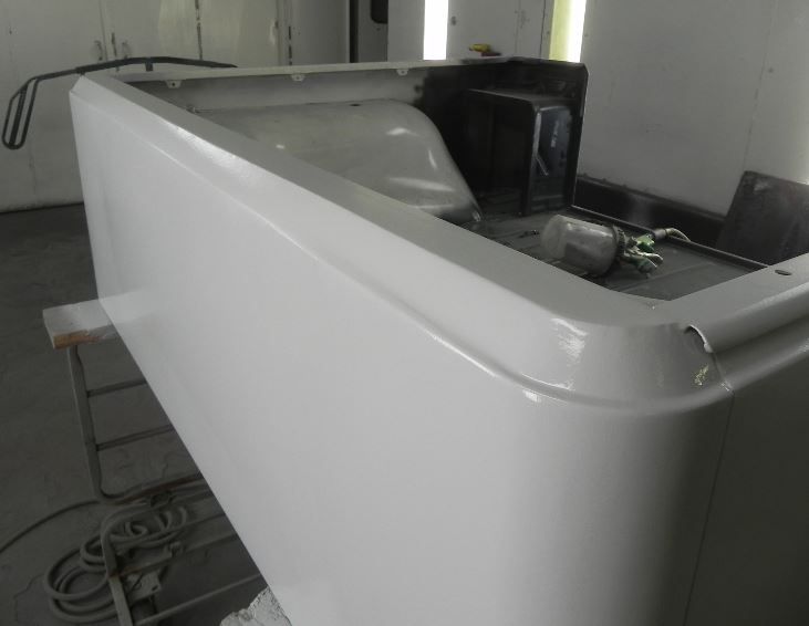

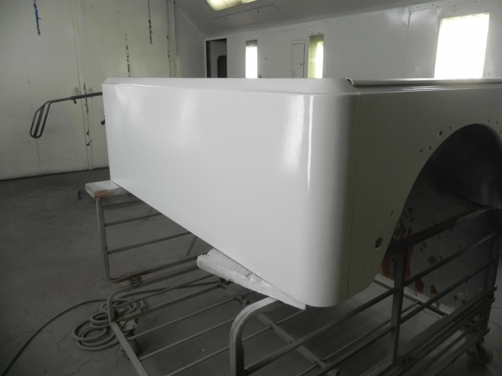

Hendrix has been busy !
And this is Hendrix's DIY cage kit .

Going to sand it down and look for imperfections tomorrow. Then paint it Tuesday or Wednesday night. Hope to have the bedliner sprayed by the weekend. When are you headed back east?

Imperfections ...
Your primer coat looks better than my paint did ! I am in Fayetteville til Thursday , then I head North to Chicago . If everything works out I will be back in Nashville by Sunday evening .
