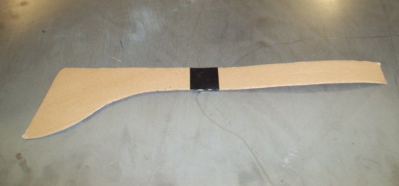

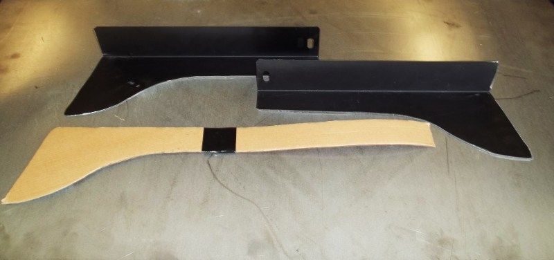

This is the template for the side of the trunk .
Left and right sides cut out of some old displays from work .

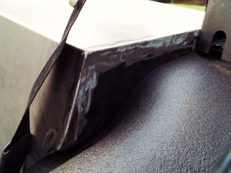

Nice pretty heat marks .
Trunk side welded in .
And from the back . Now with the tailgate locked I have somewhere to put my laptop and tools as I travel . Still have a good bit of finishing to do on Friday with the steering going in , but I think I will have it ready for Sundays departure to Utah .

Its going to be all bolt in . The welds you see are for the side panels that keep people from reaching in through the side . The added bonus to the side panels is that it adds an amazing amount of rigidity .
It will be clear as mud once I pull it out to undercoat and paint . I am hoping the 3 M undercoat will eliminate any additional noise that the trunk could make .
