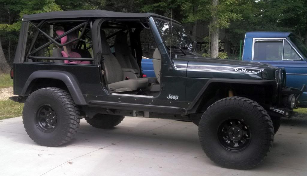

This is how the LJ sits as of today on 35 BFG's with 3" Savvy springs and a 1" body lift . When I went to 35s the LJ felt loose on the OME's , but the Savvy's have given the crispness back that disappeared . I wasn't sure what to expect of the Savvy springs as I have had OME's for so long but so far I am pleasantly surprised .The LJ still rides great and soaks up the bumps both big and small with no issues .
On a different note I figured out whats wrong with the trailer . I went through the list of suggestions and most of y'all guessed it right . It towed just fine behind the LJ all the way up to 65 mph with the "small" addition of a 80lb bag of concrete . So yes a lack of tongue weight seems to have been the culprit . I guess I will be purchasing the tongue box for it sooner than later now .
