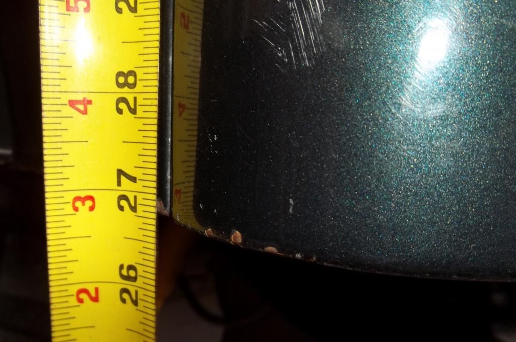

The Savvy 3" springs are just a hair taller on the counter than the OME 942 2.5 " springs.
This is the OME measurement .
And this is the Savvy measurement . So the overall gain is somewhere between 5/16" and 3/8" which is not quite the 1/2" I was hoping for .

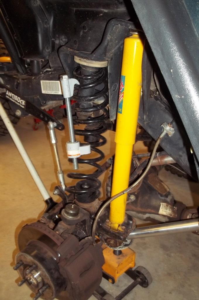

The fronts netted the same gain , but they did have 11 coils vs the 9 coils of the OME .
The drivers side in this picture is an OME and the passenger side is Savvy .
And this is how I pull coil springs . I use the jack to compress the spring as much as possible , then I hand tighten coil compressors on the coil .
Then I lower the jack and allow the frame to rest on the jack stand . I have found that a light step onto the rotor will allow the coil to fall out .
Once the coil is out I use the press to compress the spring and remove the clamps . I then compress the new spring and put the clamps on it . Once the new spring is in place all you have left to do is jack up the new spring and remove the clamps . You may have to disconnect a sway bar or shocks depending on what lift you are running . With this method I can swap a spring out in about 20 minutes and that includes removing and reinstalling the tire .
