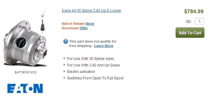

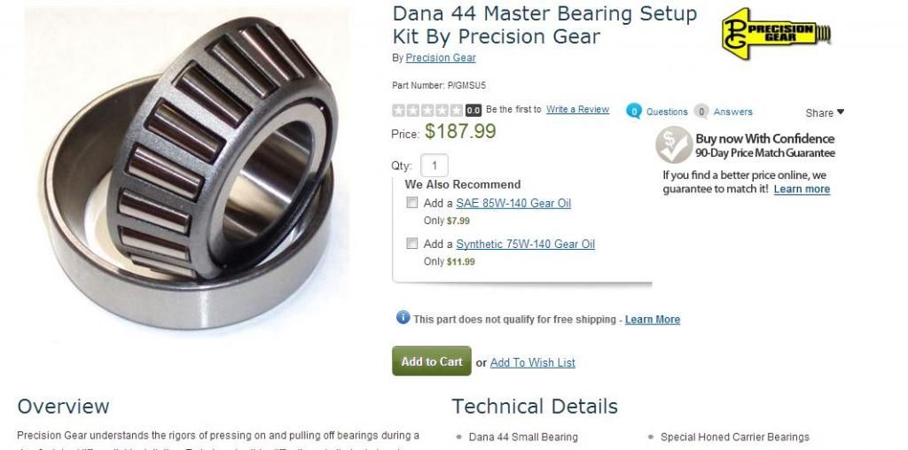

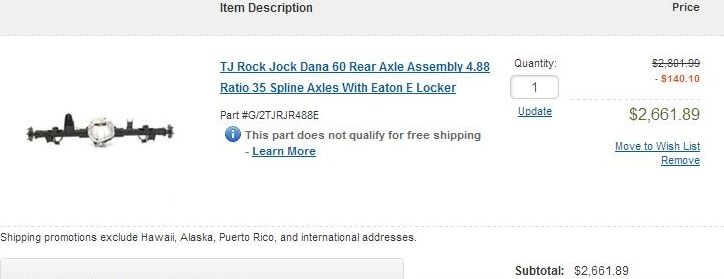

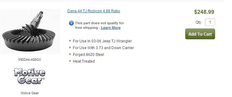

I am still waiting on the differential clearance of the 60 vs the 44 but I did figure out the pricing .
Here is the Dana 44 parts prices .
The total for this is $1609.96 and the labor should be around $200 at a minimum .So $1806.96 .
The Dana 60 is $2661.89 with the axle coupon I found and that makes for a difference of $851.93 .
Shipping would be free on either option and for the $200price on axle setup I have to pull the axle so they are both an equal amount of work .

Do yourself a favor and skip the E locker
I thought the Eaton was a decent locker ? Are they not holding up out there?

Originally Posted by Moabrubi View Post
That seems a little expensive for the rear chromos. My G2s were $220 I think. They are all made by the same people
If go that route, PM me and I'll send you the phone # for the guy to get them from.
$220 is a lot better pricing and will change the price differential to about $1000 which is where I thought it would be . If I build the 44 I will shoot you a pm .

Robert sells the same motive gear set for 174 bucks
http://www.rwkhaussupply.com/magento...ion-set-1.htmlh=
Install kit 94 bucks, now for a Rubicon D44 it has thick shims, you might want to ask him about that
You are killing my math ! So the gap is up to $1200 ish now . I havent really shopped the parts a lot and I am surprised at how much cheaper y'all are finding this stuff .

Just not my thing, from hear say they do not release well especially in the front axle. Talk to some people that have them and wheel a lot.
See how they feel about them. Axle shafts and lockers are not the place to cheap out. Gears are pretty much all made by the same manufacturer and just reboxed in different brand name boxes I have seen it done in the Superior warehouse.
aw12345 is offline

The e locker for the D44 uses a weak 2 pinon design. The Dynatrac rep said that it is 60% of the strength of an ARB.
For me there are two (outside of lunchbox lockers) lockers that I would put in my rig. Detroit, and ARB. If the Yukon Zip locker was cheaper, that might be interesting, but for as much as they charge you might as well do an ARB.
clintrivera is offline
I dont know many people with E Lockers . I think Kyle Craig runs one , I will go see what he thinks about it .
I wonder what the 60 E elocker uses ? I have 0 issues with an ARB other than buying the compressor ... silly huh ? I have no qualms spending 2700 dollars on an axle but I dont want to buy a 300 dollar compressor
The D60 e locker is also 2 pinon. Eaton made the E-locker for OEM applications. They just happen to release them to the aftermarket as well. As such, they are designed for OEM size tires and less than hard abuse.
They give away free compressors with ARB's all the time, so if that's your stumbling block, just wait till they go on sale. The nice thing about an ARB is the support. There have been many people (including me) that have sent ARB a box of broken junk (many times installed incorrectly) and ARB sends back a rebuilt ARB for the price of free.
