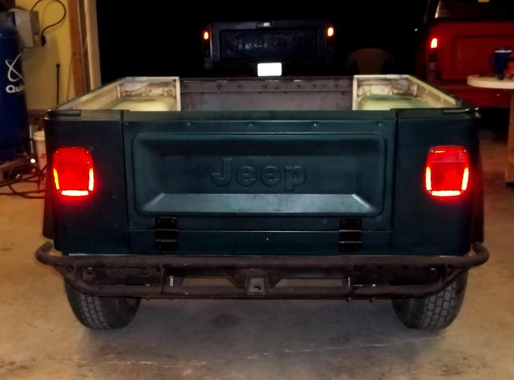

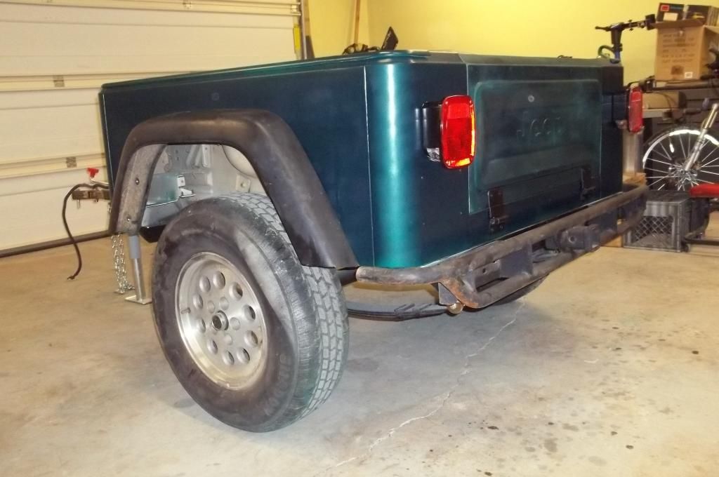

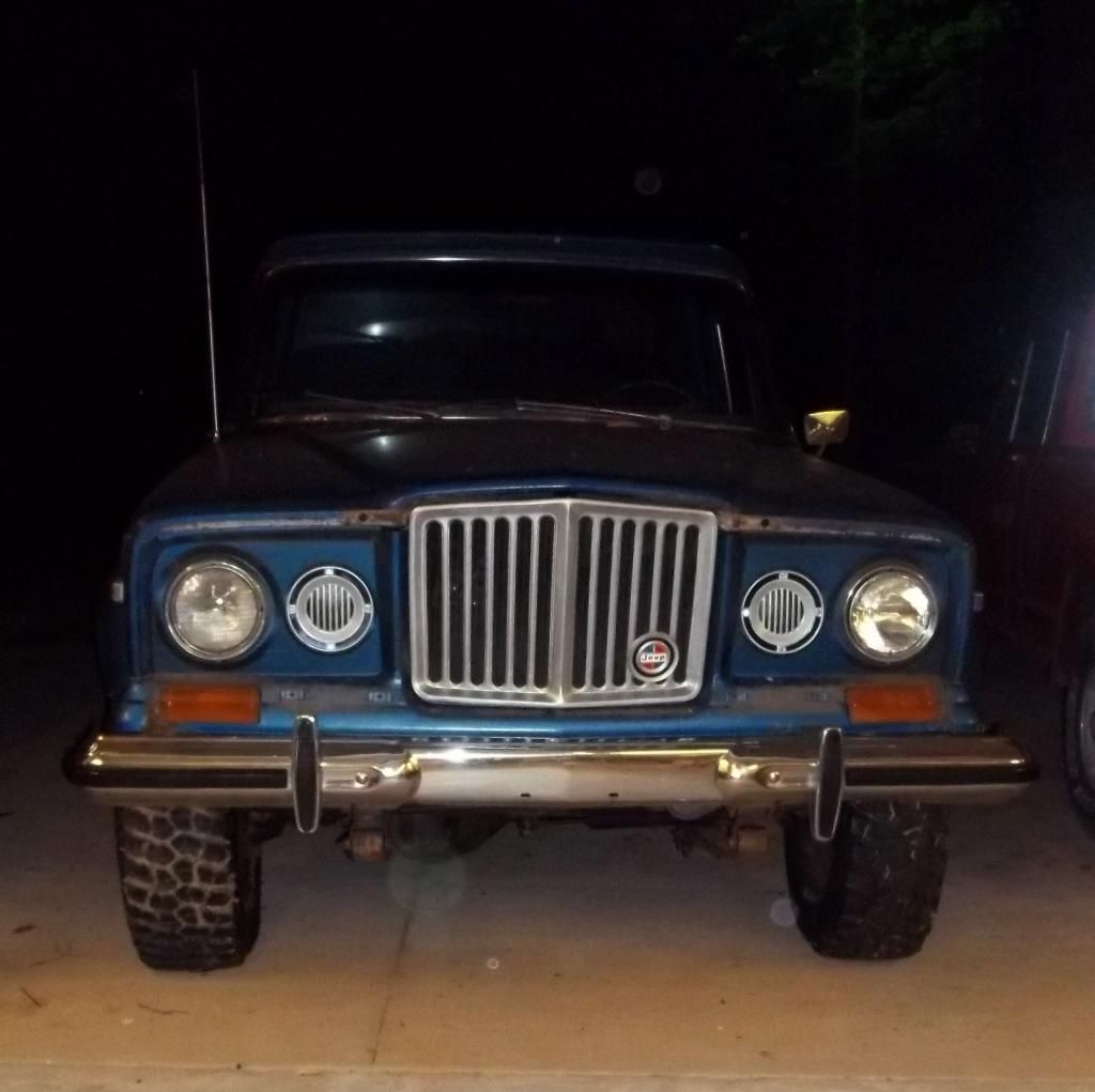

Gladiator grille conversion is complete .

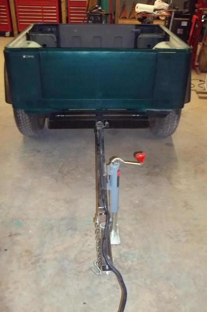

1st full coat of paint is on . Tomorrow I will wet sand the entire trailer and put down the second coat . It will get much darker on the second and third coats if cures like the test section did .
More first coat pics .
Welded up the trim bracket . Tomorrow I need to go get some more angle to finish the trim and make a hinge mount up front .
Not sure if I will make it to the inspection station tomorrow morning after all . Theres still a lot of little stuff to do before I take it over , and I would rather put more time into labor than go over and fail .

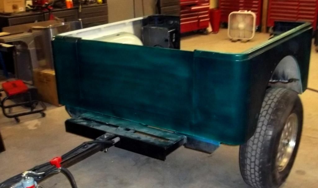

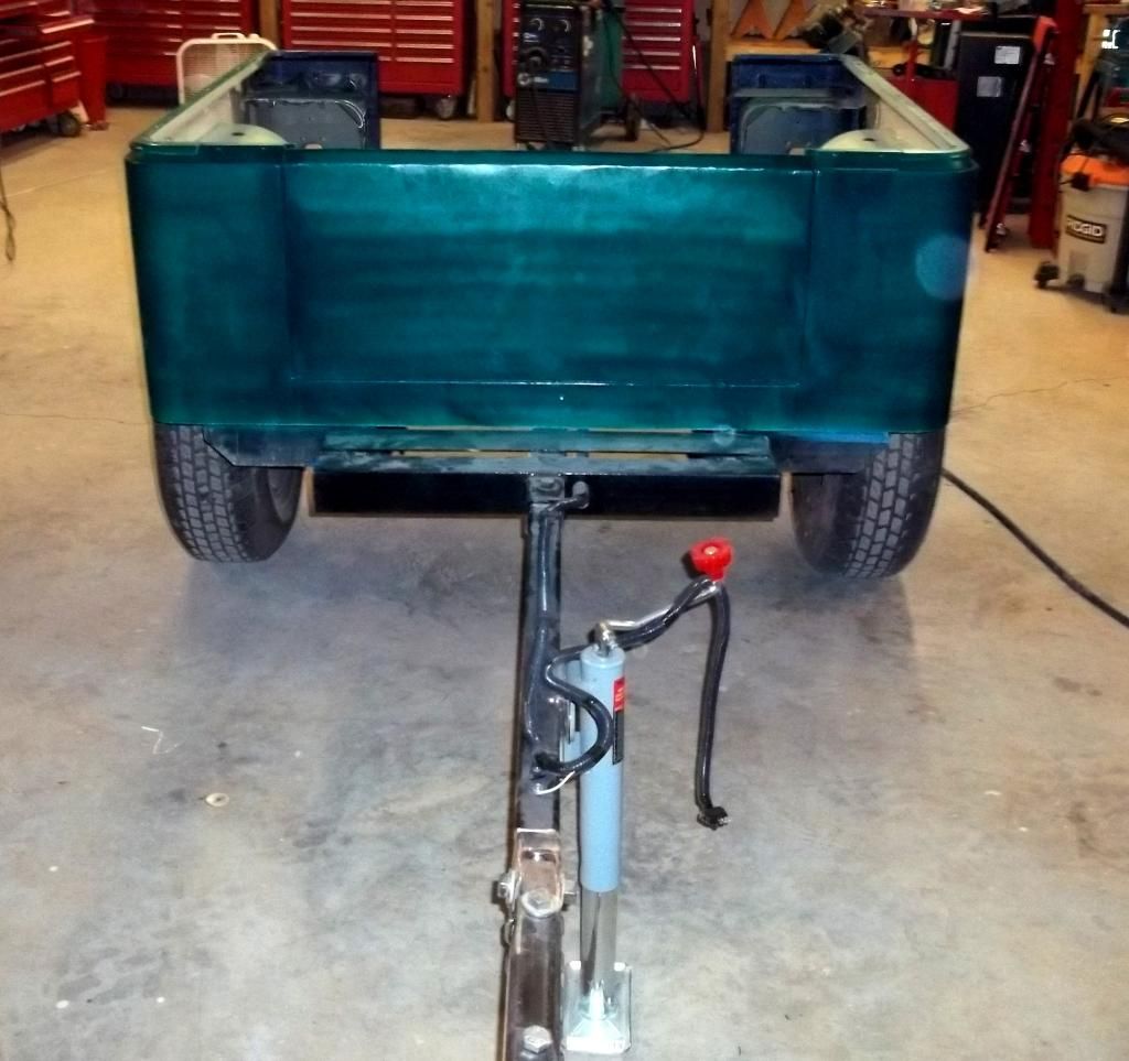

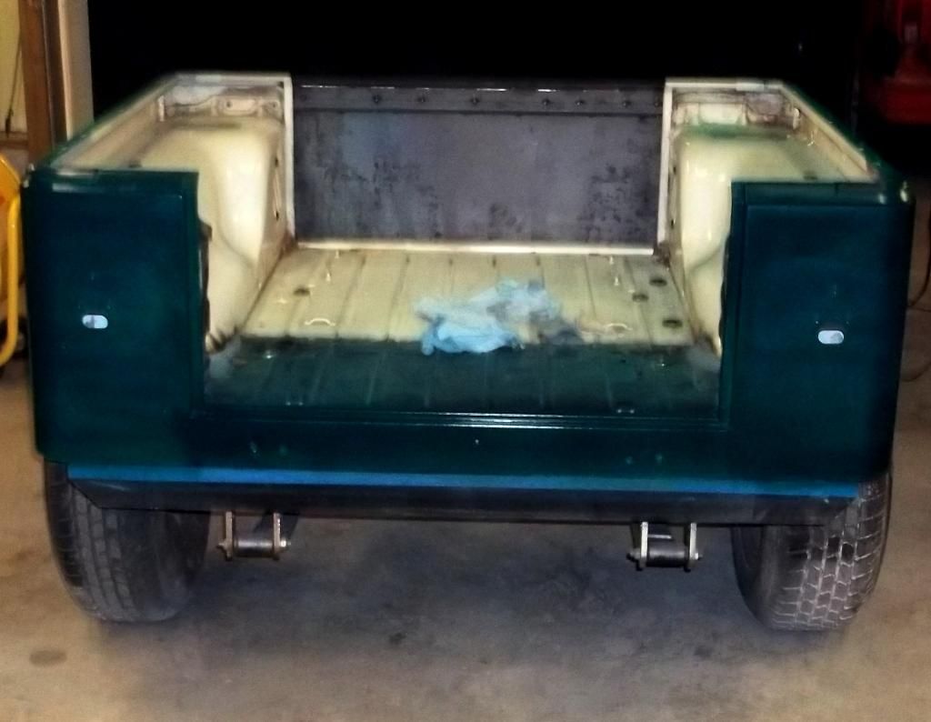

More sanding , but I also got to shoot another coat of paint on the trailer .
I used aircraft stripper and picks to clean the tailgate and there was no getting it 100% clean . It looked ok , but a quick phone call found a guy that was willing to sand blast it for $20 . This is what it looked like when I picked it up , there will be no more airplane stripper at this house !
The first coat of primer and paint are on , it needs a lot of wet sanding to slick up like the rest of the paint .
I thought blasting the hinges might make them bind up , but I figured what the heck they cant get worse. Surprisingly enough they pivot much smoother now and with a little oil they should be buttery smooth . The blasted surface takes primer and paint so nicely that I am motivated to get an even bigger blast cabinet so that I can blast larger items .
Close up of the second coat of paint . It is starting to shine a little more and its getting much darker . Tomorrow I will wet sand again , and I think the third coat of paint is going to be just about right ... or at least I hope so
Last paint picture for the evening . There is no way I could do paint and body for a living , it requires entirely too much patience

Its not really that bad. I have 19 years in the business. Trailer looks good so far.
What are you spraying it with? rattle can?

Thanks , coming from you that means a lot .
Sadly yes , I am rattle canning it . I was able to get the color matched cans for half price which equals out to about $28 total versus $140 for a quart of base / clear with reducer and hardener.
Cost wasn't the only factor in picking rattle cans but it did matter in the whole make a $28 mistake or a $140 mistake argument . I also think fixing trail damage in the future will be much easier with the cans ,but my hands wish I was spraying with the HVLP gun . For now this will do , and it was an inexpensive way to get some color on the tub . Was it that easy for you to see what I was spraying?

Yes, but only because I can tell the difference in the outcome. Spraying with rattle cans tends to show inconsistent patterns. And I always wonder why people sand between coats. Base coat clear coat was made to spray in a wet on wet application. In lay mans terms spraying never really stops. Start with base, wait 5-10 minutes and reapply base till proper coverage is obtained then spray with clear coat.
When cost is a factor I see why someone would go with rattle can over a true automotive finish.
Carry on, the trailer looks great.

Sorry , I painted this one the wrong color
I hate the streaking I got with the cans , and I kept a wet edge . Sometime this fall I will most likely shoot it with car paint as I dont like anything to be half way done .
The reason I was sanding between coats was to keep the paint smooth . There was a roughness to the paint in between coats and I thought it would show through . I had the garage clean , but theres still dust to contend with . Now if I knew a body guy who had a downdraft booth it would look entirely different
When cost is a factor I see why someone would go with rattle can over a true automotive finish. Carry on, the trailer looks great.
The rattler's turned out ok , but I am going to invest in better paint this fall or winter . Until then this will keep everything from rusting and hopefully it matches the Jeep in the daylight now ... or at least from 50 feet

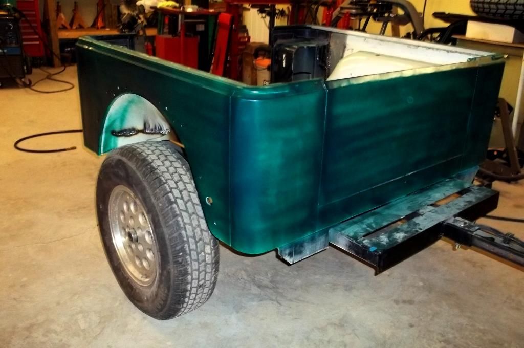

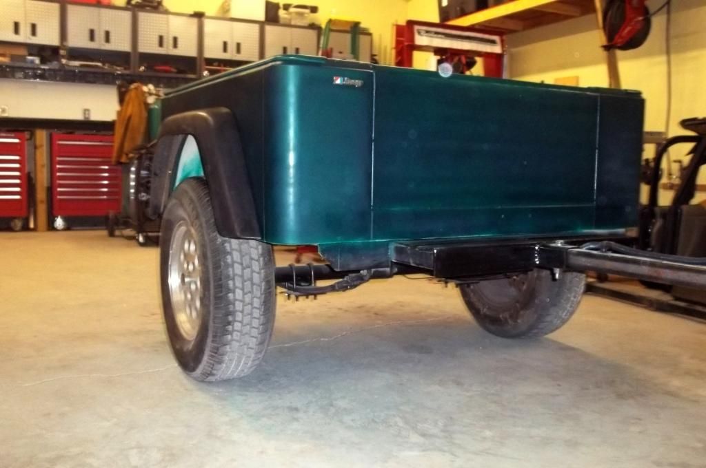

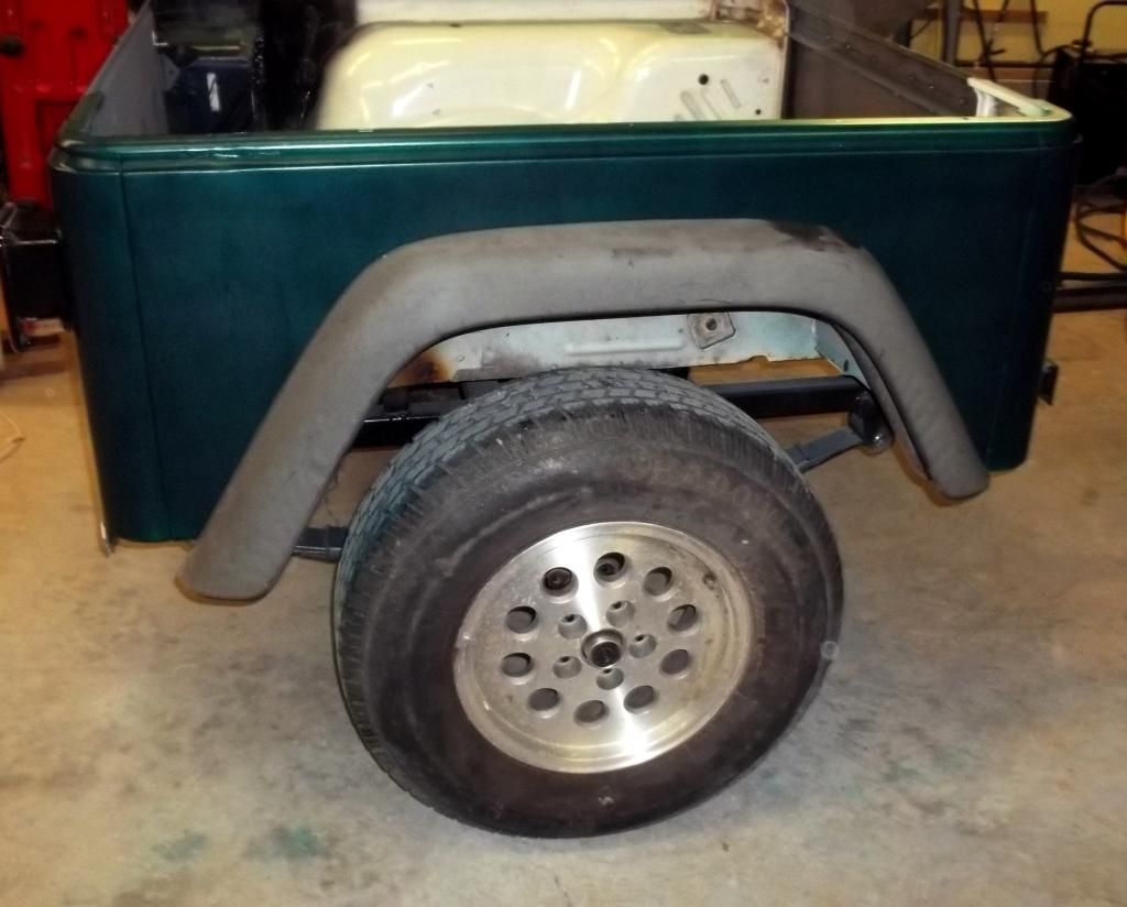

The paint looks good everywhere except the front panel , so I started putting everything back together . The flares were terribly faded so after I trimmed them to fit I used a heat gun to turn them black again .
You can see the difference in the flare in this picture . I was surprised at how well the heat gun trick worked . The process left a little blotchiness , but overall the flares look much better now than before . I still need to shoot another coat of paint on the tailgate , but I may leave that until I shoot car paint .
Definitely need another coat on the front panel .
Once its buffed I think a lot of the blotchiness will go away .
This is it for now , more this afternoon .

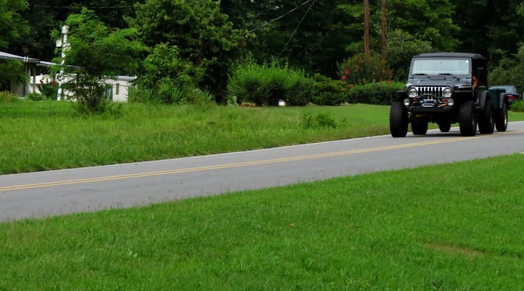

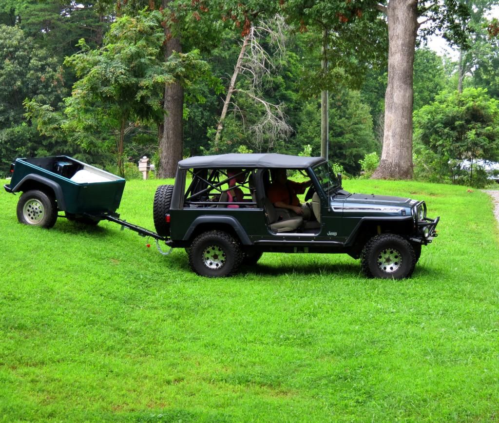

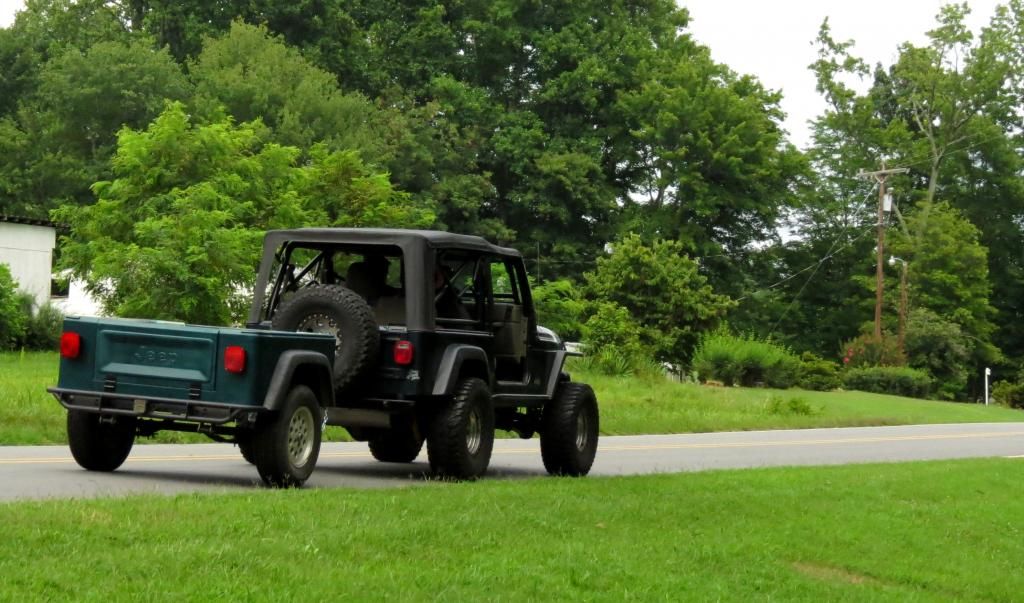

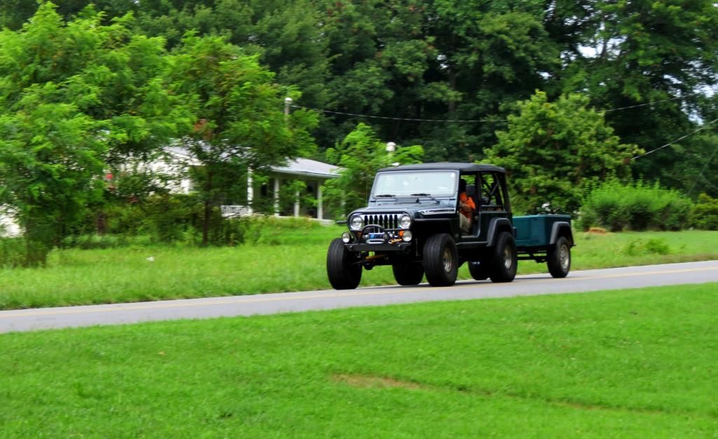

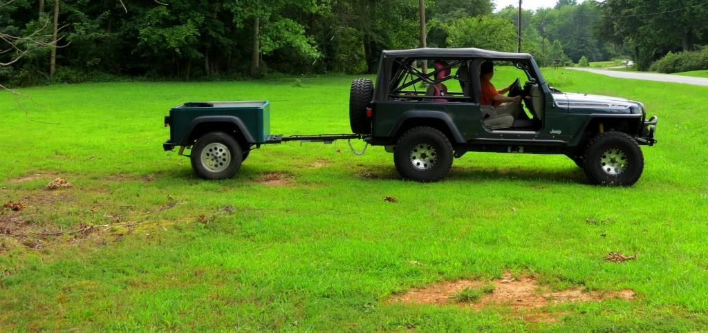

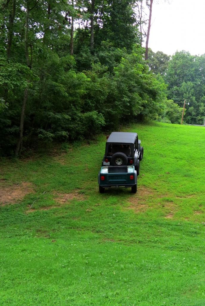

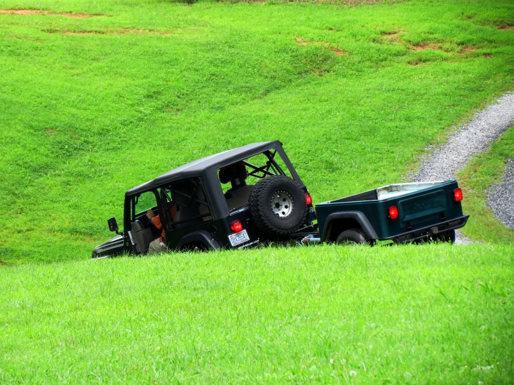

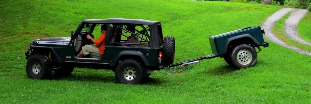

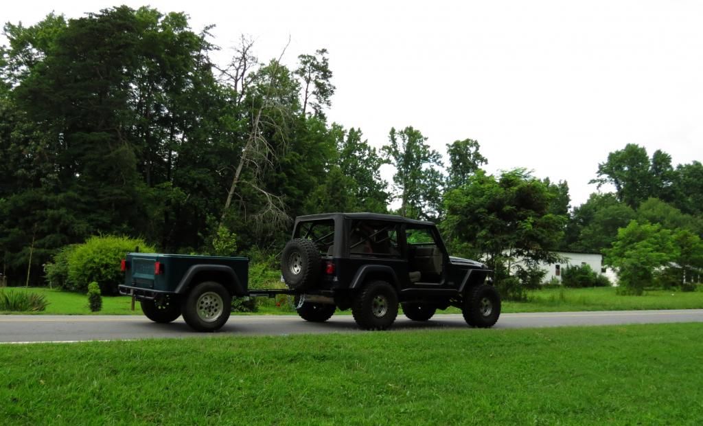

Yesterday I took the trailer out for its maiden run to see how it would tow on the road . When I first finished the tub I took it around the yard , but this was the first time I had it over 10 mph . I didnt know what to expect with it at speed , but it towed great. There was no hopping or wagging and best of all it was quiet .
You can see in this picture how much the trailer tub needs to be raised . Its not terrible and the 33's should make it sit about level with the LJ . Once the LJ gets 35's I think a spring over on the trailer will allow enough height to put 35's on the trailer with plenty of clearance .
Thats all the fabrication for now. I am off to work for the next six weeks , once I get back I will start working on the tonneau cover .
