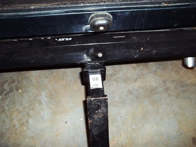

And this is why we drilled the receiver . I wanted to french the receiver in as far as I could for aesthetics , and departure angle . So I flipped the receiver on its side while I was making the bumper and this is how it turned out . As an added bonus you can make the receiver less likely to be stolen if you lock the tailgate. For me this is a moot point , as I never lock the LJ .

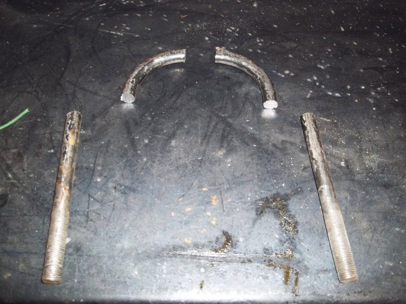

Somehow I lost one of the tie in brackets from the old receiver .
So I chopped this up .
And this is what it turned into .

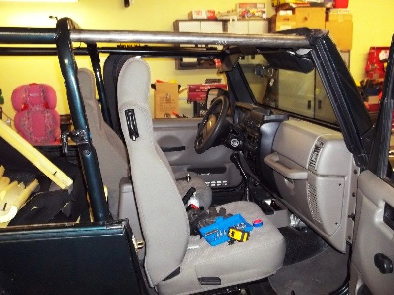

After measuring and fitting at least a dozen times the sides are in and the door surrounds fit perfect .
Passennger side in and tacked .
Drivers side in .

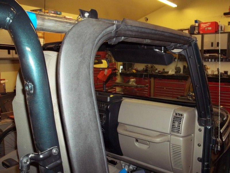

Top spreader is in ! My door prop worked great to hold the cage at the correct height .
First A pillar is in .

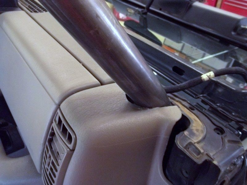

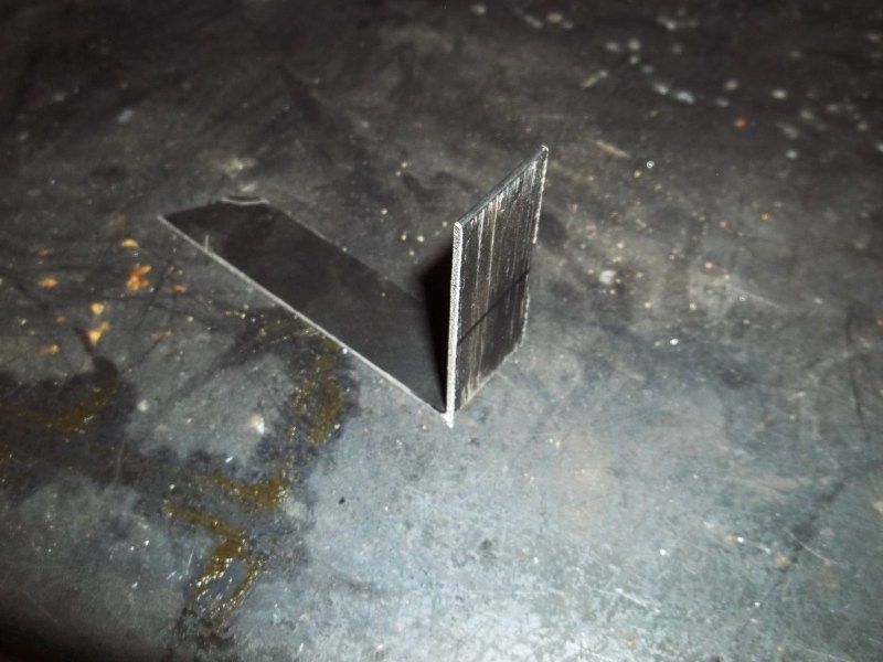

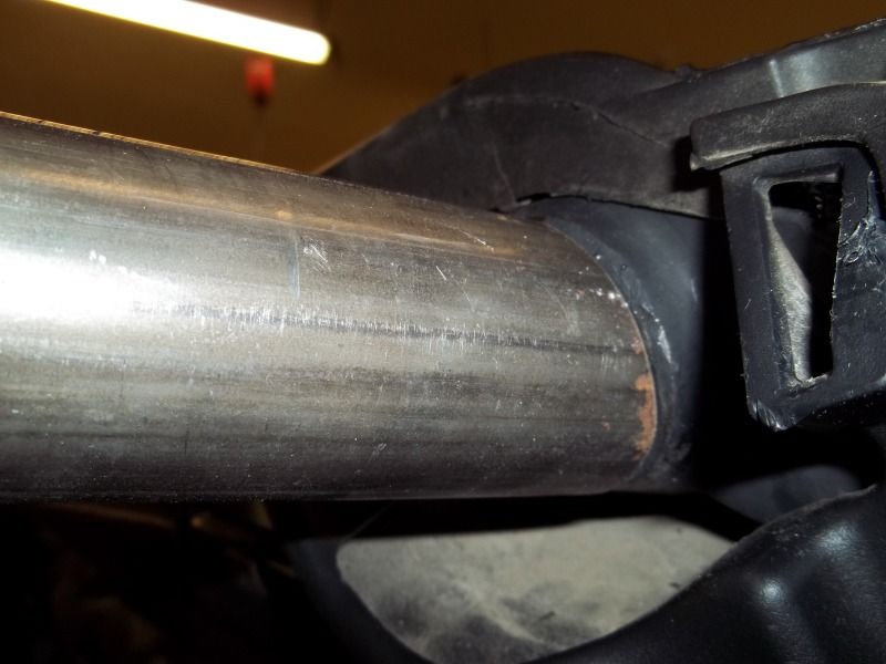

Take your time with this cut . I am going to make a template and upload it with the hope that it will help someone out .

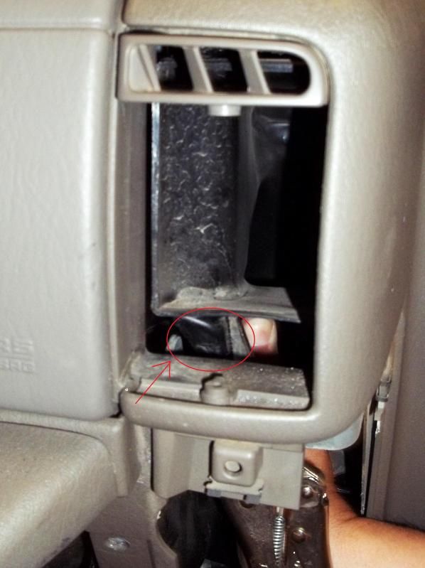

One trick me and my buddy figured out is to cut the triangle attaching point in the red circle off of the bottom of the a.c. duct . This allows you to slide the duct forward and it makes all the difference in the world getting the A pillars to fit . The diffusers are a little stiff but are still adjustable and the A pillar holds the duct in place .
If your thinking of making your own cage , be forewarned getting the A pillars in place is tough . I had awesome help and it still took 8 long hours to get done what you see above .

Looks good g. I want to redo the front of my cage and run it the way you are. I added a pad between my cage to windshield tie in to prevent some rattling.

A bit off topic. The soft top door frame, does the front of it slip into the gap of that front weatherstrip? I just got my TJ a few weeks ago and just installed the soft top door frames and I had to spread that gap because I think the PO did not install it properly and crushed that gap together.

On mine they butt together , but its a flush fit .
