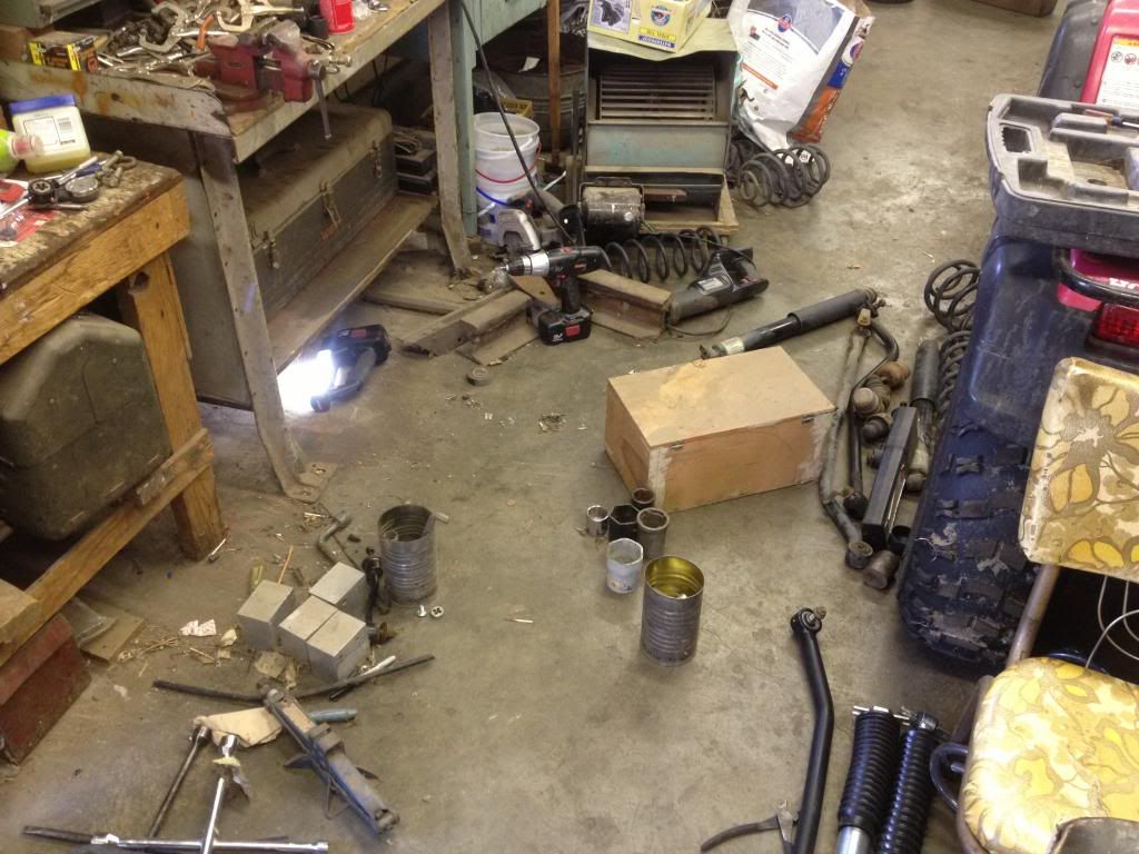

Now on to the install.

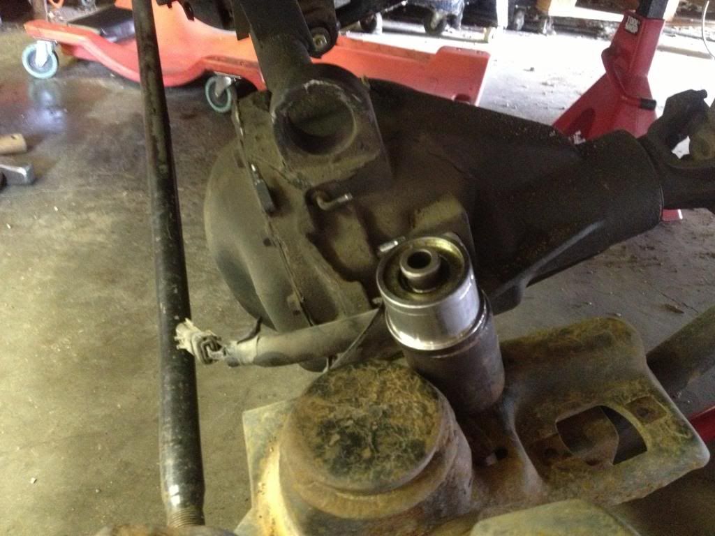

First order of business, decide which end to start with. The front still needed the front uppers installed and I was tracking down some loose front end components (axle side TB bushing, and pitman arm TRE) so I started there.

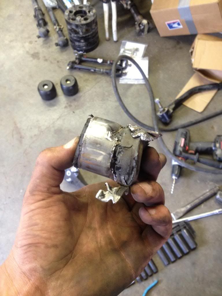

Once I pulled the front uppers I saw the passenger side upper bushing almost fall out of the housing so it was decided to do that install at the same time.
The housing side was a different story.
After some screwing around I got it knocked loose and then went and found a hammer and knocked it all the way out.
The lovely assistant:
She caught me taking pics:
Ready to go:
In:

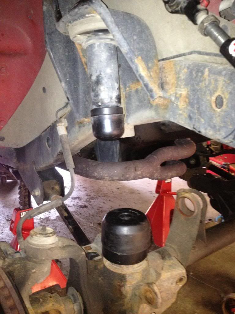

Measuring for the axle side for the bumpstops.

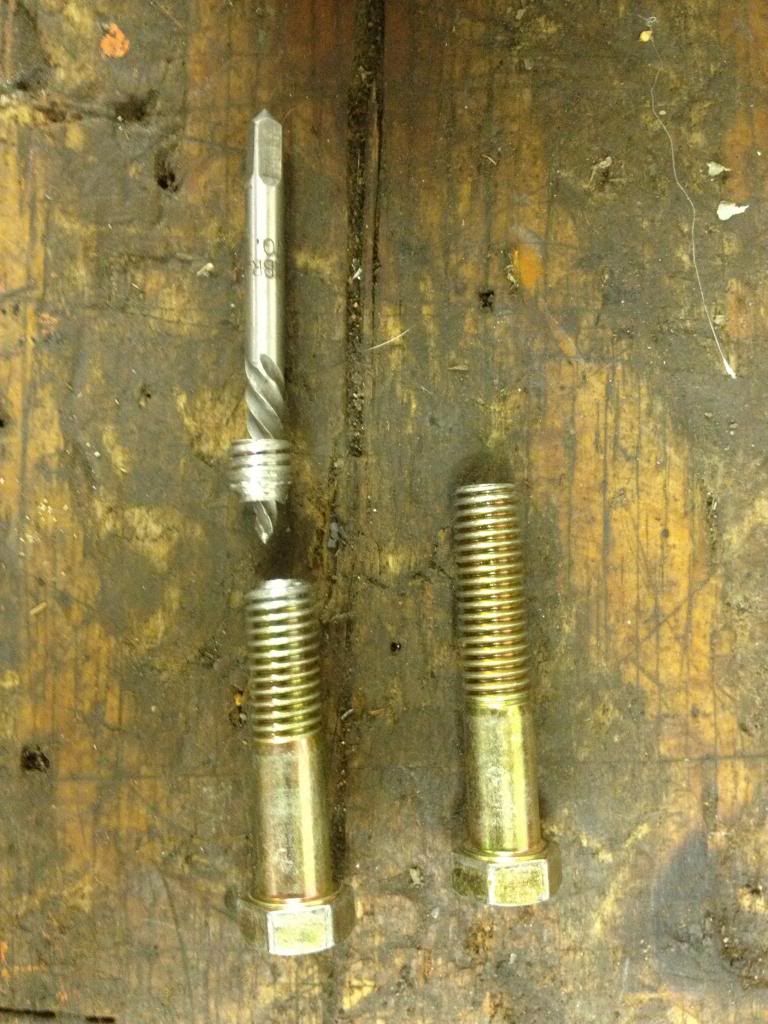

Got the holes drilled and then tapped. The driver's side had different ideas however.
I nearly **** myself twice. First that I managed to break a grade 8 bolt, and second that I actually got one of those extractors to work and not break off.
The threads on the housing were fubared so I just got a longer bolt and put a nut on the bottom.
So far so good:

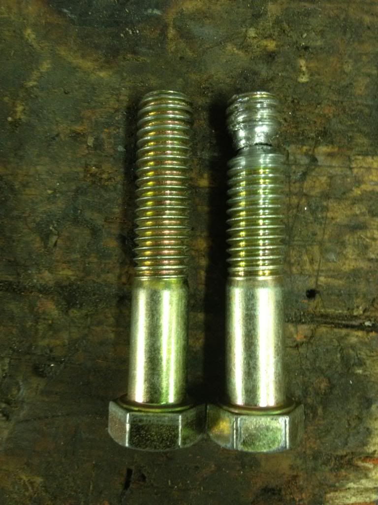

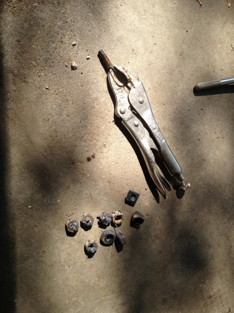

Rear upper shock bolts, need I say more?
After umpteen welding on nut to broken bolt attempts, I got it loose enough to start turning it with vice grips and those babies and some PB won out.

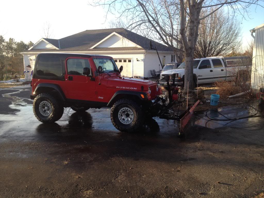

I realized I never put up any pics of the plow setup, here goes:
Nice and clean

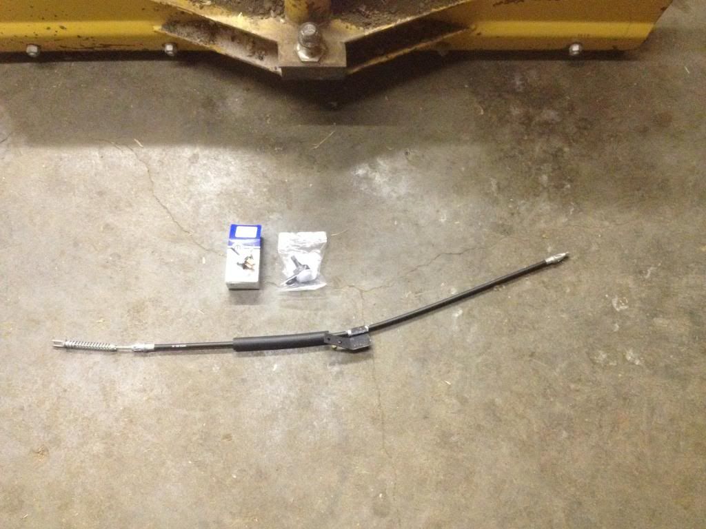

Some general maintenance/wear items:

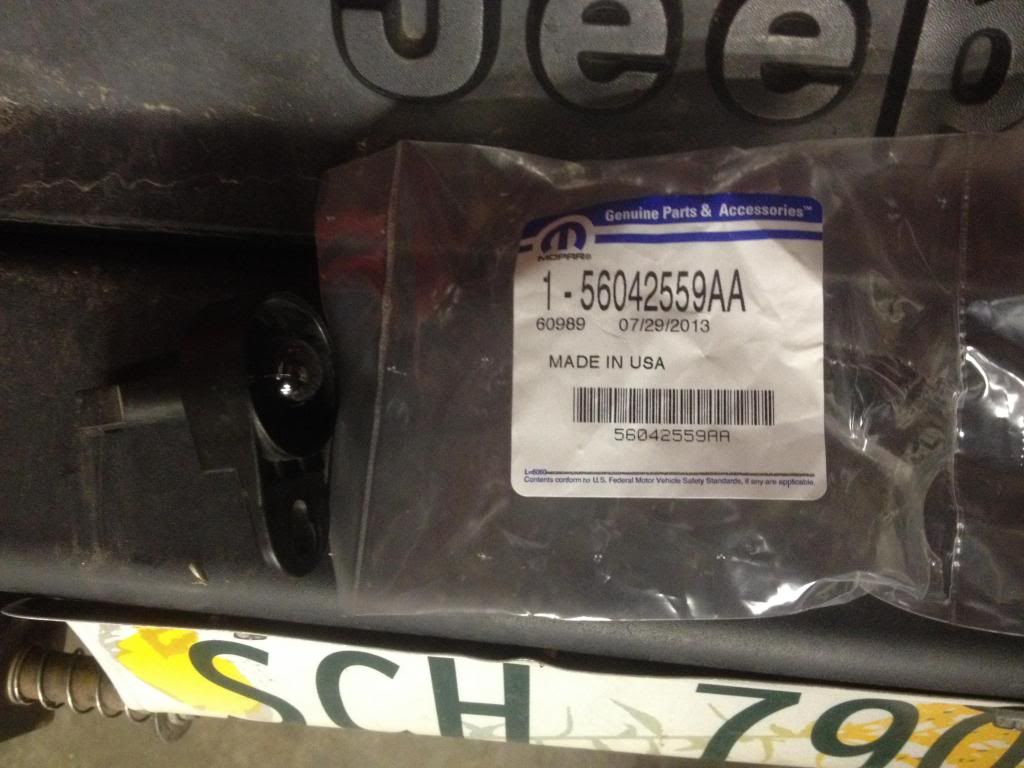

If you're ever looking for the late model style courtesy lamps down by the door straps here is the part number:

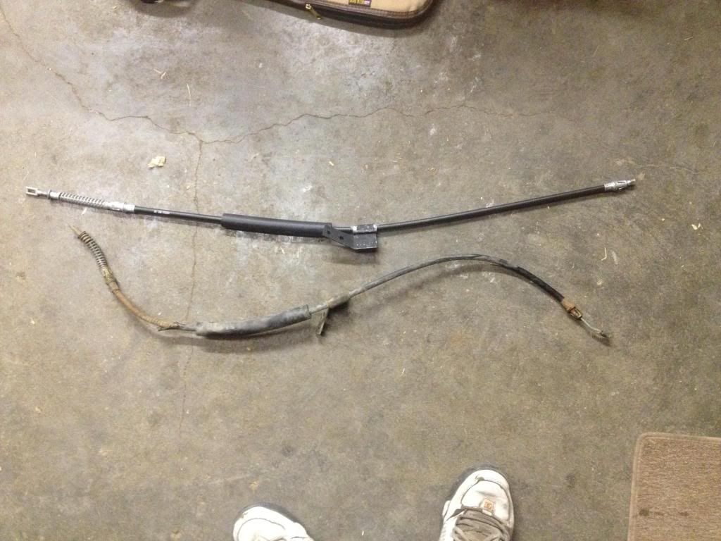

Driver park brake cable
