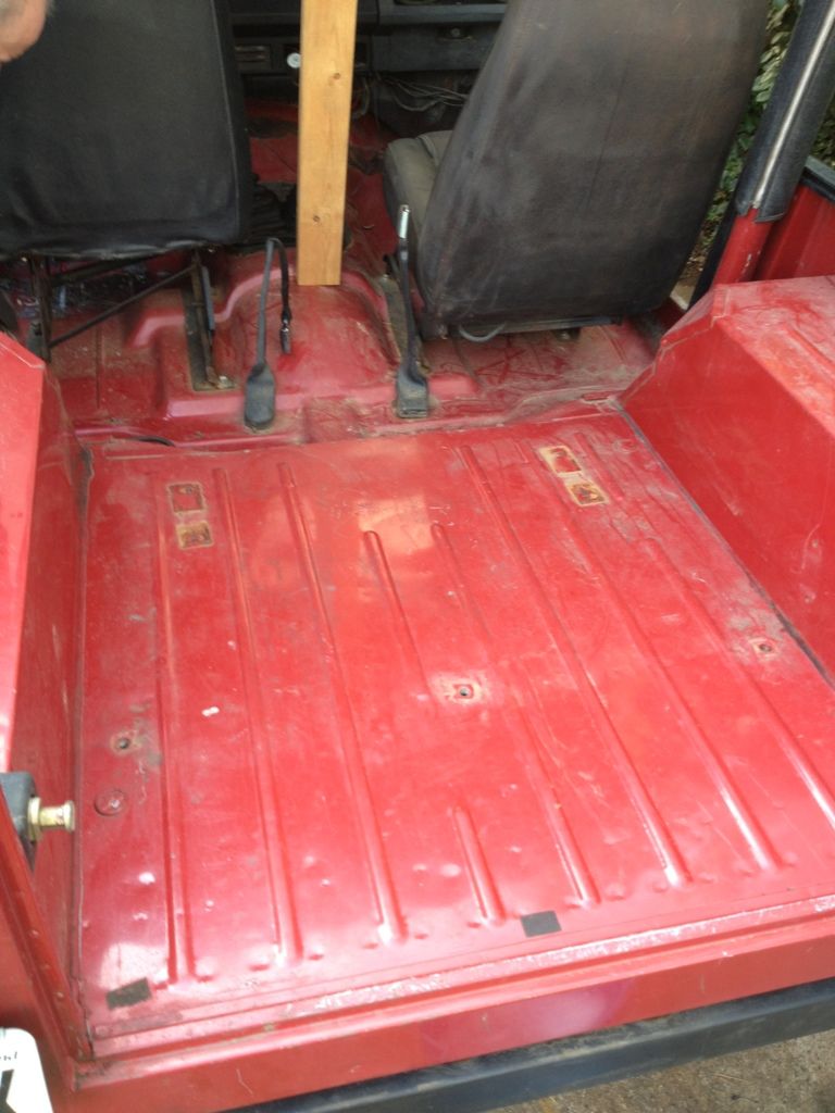

There’s no real rust to speak of, just a spot of surface rot on the driver’s floorboard:
I took a wire wheel to the area and hit it with some rust inhibitor:

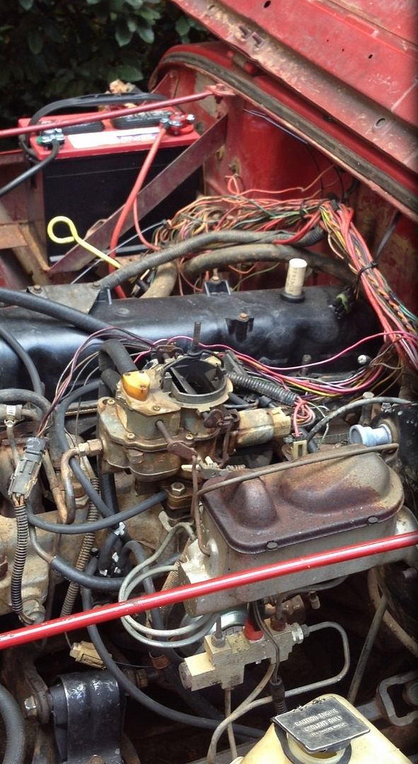

With that in mind I began to remove the unnecessary vacuum hoses/valves/etc. from the engine bay and I’m working on a suitable air cleaner assembly.
This is where I’ve run into a bit of a hurdle, as all of the threads and vac diagrams I’ve seen look different than what I’m seeing under my hood (I’m finding more and more ‘quick-fixes’ made by the PO).
It began like this (going through wiring loom to undo any BS done by PO, I'll wrap it back up don't worry!):
Here's what I'm looking at now (I know the engine will not run at the moment, and some of the hoses are hooked to each other to keep them in place):
Going to do away with the Pulse Air system, too:
PLEASE FEEL FREE TO COMMENT OR MARK ON ANY OF THE PICS IF YOU KNOW WHAT I'M LOOKING AT OR HAVE ADVICE!!

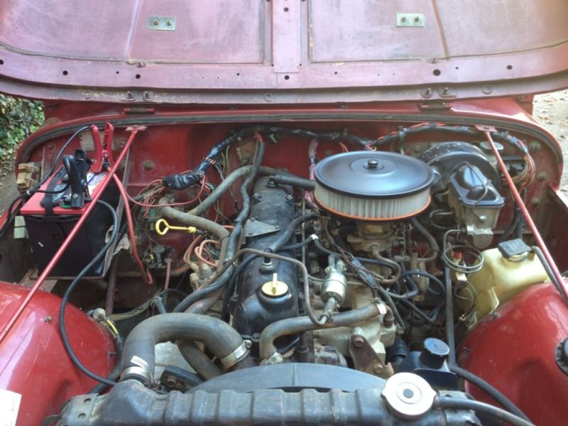

A bit of an update, I installed a new valve cover gasket last weekend and cleaned the old cover of the built up oil and mud.
It turns out that the PO had removed the EGR valve and capped the port with a piece of flat stock and a piece of a Bud Light box for a gasket. I bought and installed a new EGR valve and connected the line to the CTO valve.
With the help of a few JF'ers I was able to eliminate all of the unnecessary emissions controls and replace/simplify the vac lines in the engine bay. Now all of the vac system is all connected and sealed as it should be!
Before:
Currently:
The engine bay still has a way to go (mostly wiring) but it's cleaning up nicely so far (if I do say so myself )
I installed new Motor & Trans mounts yesterday (you can see one of the new motor mounts in the 'current' engine pic above) and removed a ton of built up mud from the inside of the skid plate

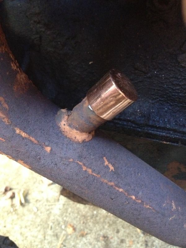

Also removed the pulse air system and plugged the ports on the cat and downpipe with random parts from the Plumbing department at Home Depot.
I plugged the cat port with a threaded 3/8" iron plug. It was a perfect fit and threaded nice and tight once I got it lined up.
Downpipe plug is a 1/2" copper cap, I used a lead battery post shim over the open port and hammered the cap on before heating it to melt the lead. Worked like a charm and it's sealed with no leaks!
I suspect the PO had advanced the timing to account for the missing EGR valve, as it was 'burping' gas back up through the carb. We retarded the timing a bit and it runs/idles very smooth! (as smooth as a straight 6 can idle)

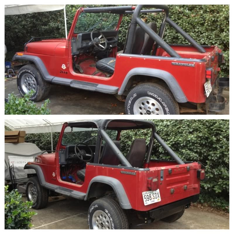

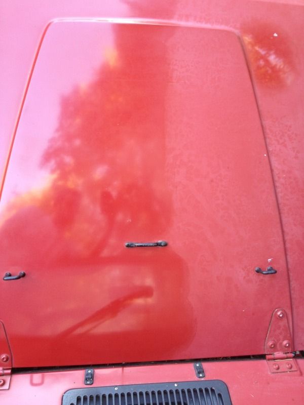

Before I covered the Jeep back up for the week I hit half of the hood with some light polish to see how a larger section would clean up.
Here's a side-by-side before and after:
The paint still has a way to go, and I'll do a proper multi-stage clay-cut-polish-seal in a few weeks... for now it was motivating to see a red reflection, though.
Here's how it will sit for the next week, except under a cover:

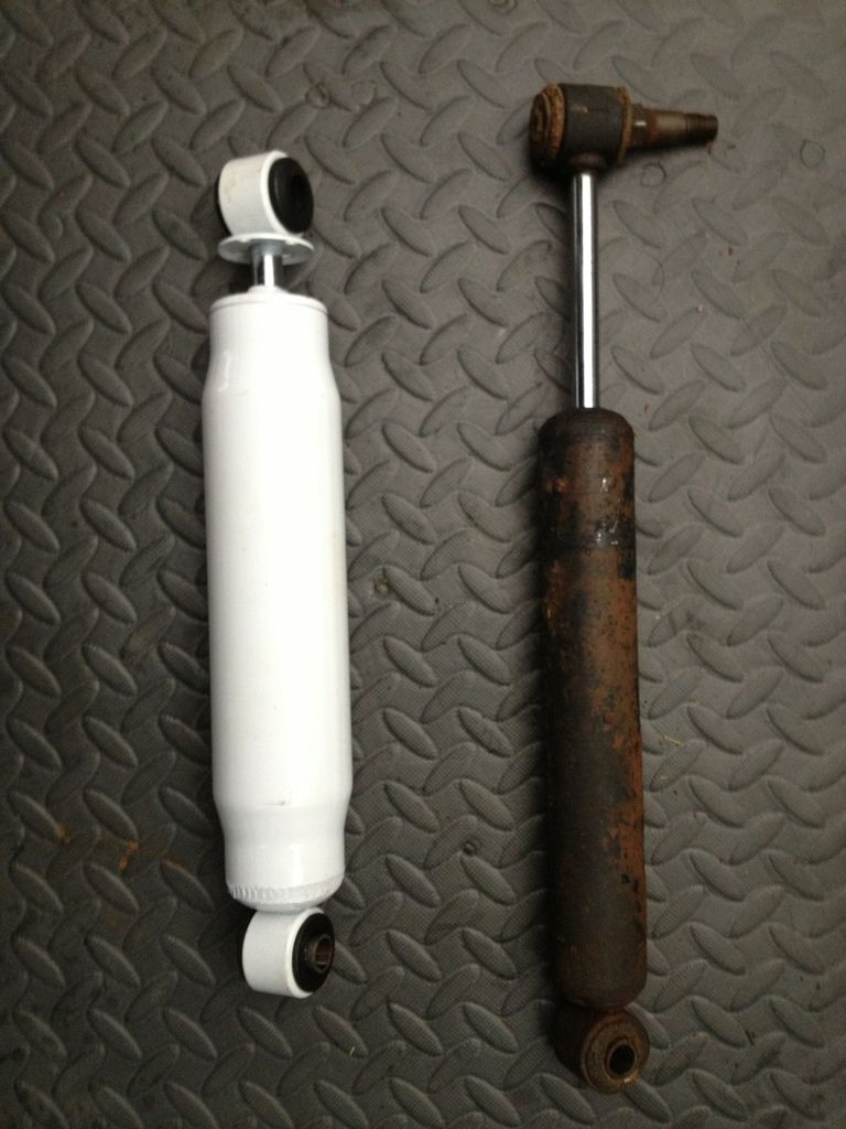

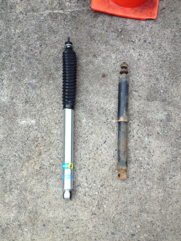

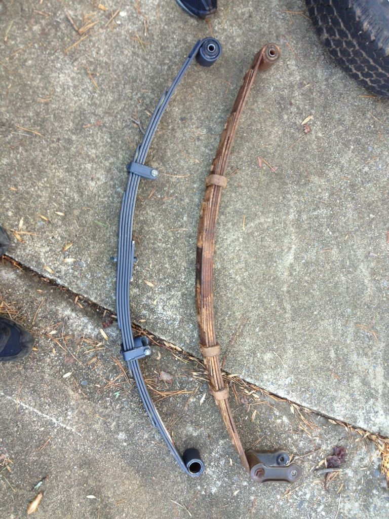

I installed Old Man Emu 36R springs on all 4 corners, Bilstein 5100 shocks, Crown boomerang shackles and all new hardware/bushings. All of the parts were ordered through Kolak Performance and the prices were unbeatable. Out of the box I was amazed at the quality of these parts, and seeing them next to the old stock parts they were replacing nearly blew my mind.
Bilstein 5100 vs. 25yo stock shock:
OME 36R spring vs. stock spring:
Moog steering stabilizer vs. stock steering stabilizer:

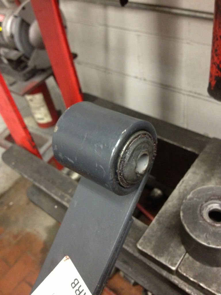

The hardest part of the lift was having to press-in the spring eye bushings since I used rubber instead of poly bushings. Luckily I have access to a 20ton press at work, so 5mins per spring netted me this:
My Dad and I were able to install the springs/shocks in an afternoon, including the brake line relocation mod (posted in the YJ Tech section) and removing the front and rear trackbars.
The difference is fairly obvious:

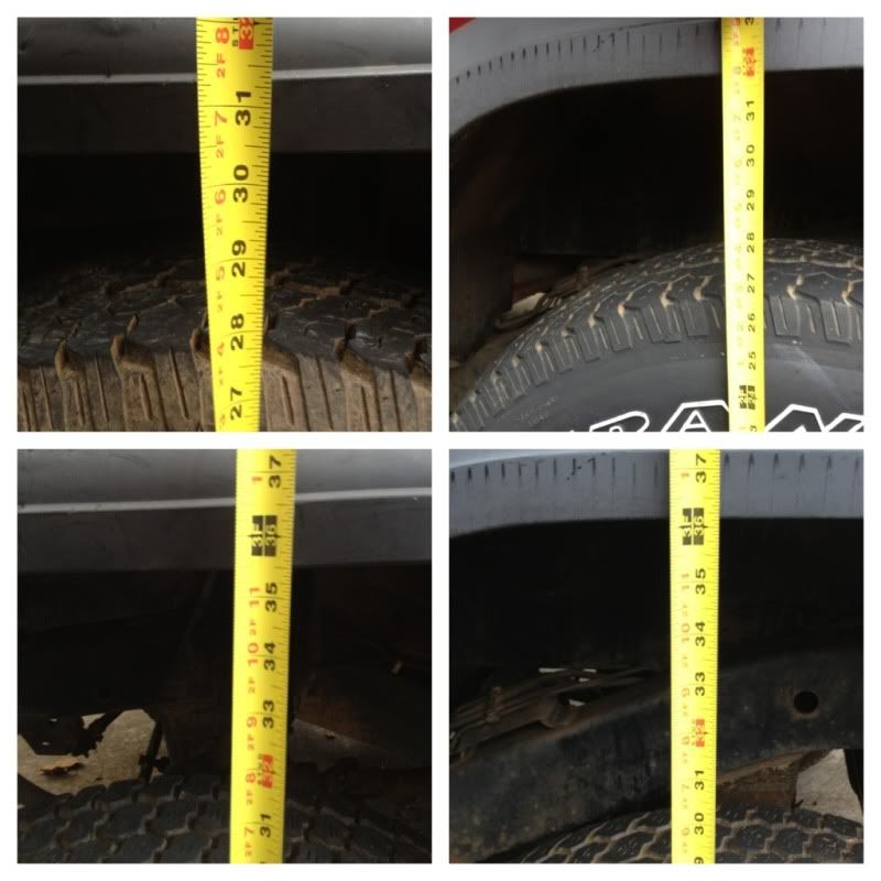

OME advertises the 36R springs as a 2.5" lift with most people posting a real-life gain of 3-3.5". Due to my flattened and worn-out stock springs I netted over 5" of lift after installing the 36R's and Crown boomerang shackles!
Before measurements on top and after measurements on bottom:

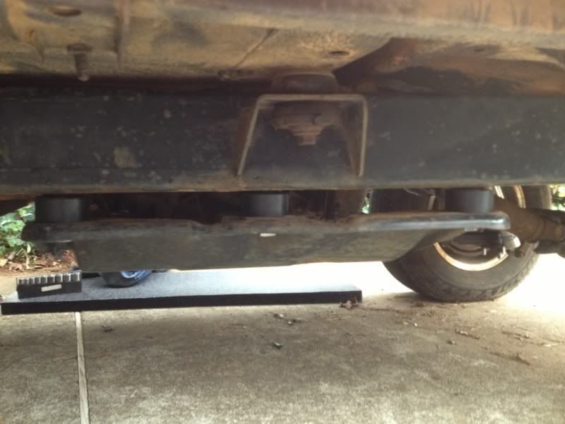

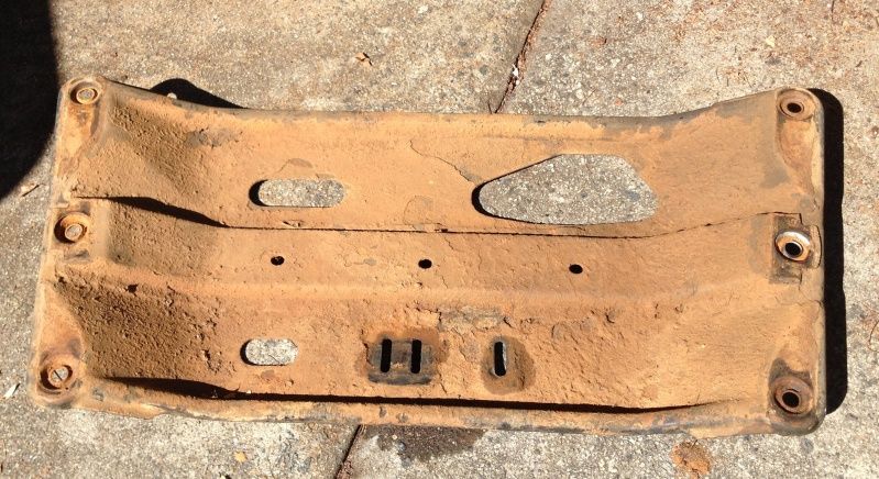

After the lift it became obvious that a t-case drop was necessary, so I ordered the RE 1" drop and installed it this morning:
Before:
After:
I'd still like to do a SYE down the road, but hopefully this will get me by for now.

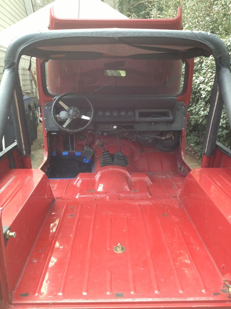

We had a day last week where the weather was in the upper 50's so I took that as an opportunity to clean out the tub and remove the rear seat brackets and belts.
Before cleaning:
After cleaning (I also hit the driver's floorboard with rustoleum to seal the spot that I had hit with the wire brush):

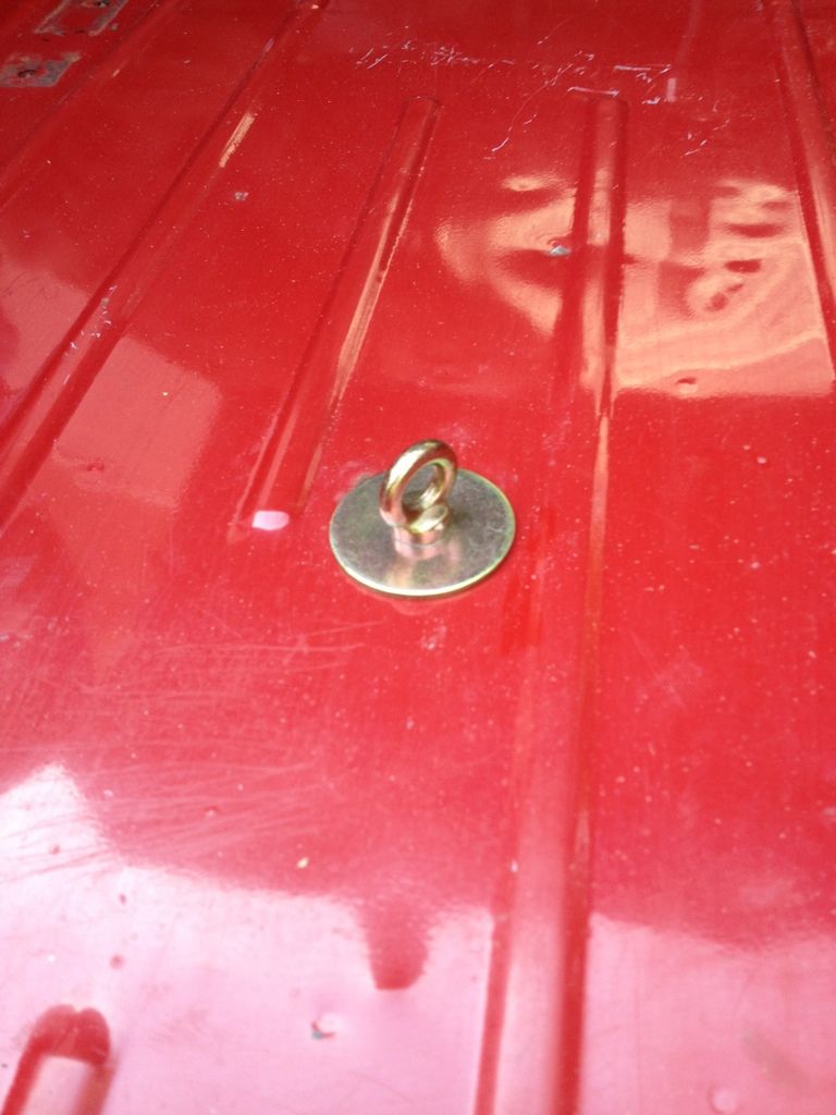

I went to the hardware store and found a grade 8 eye-bolt that threaded into the center (rear) seatbelt mounting point, perfect to connect my Australian Shepherd's harness so he can safely ride in the Jeep with me.
