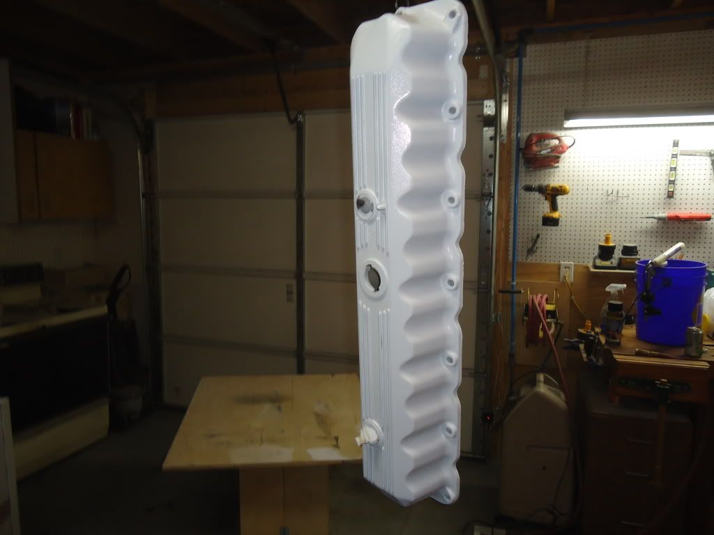

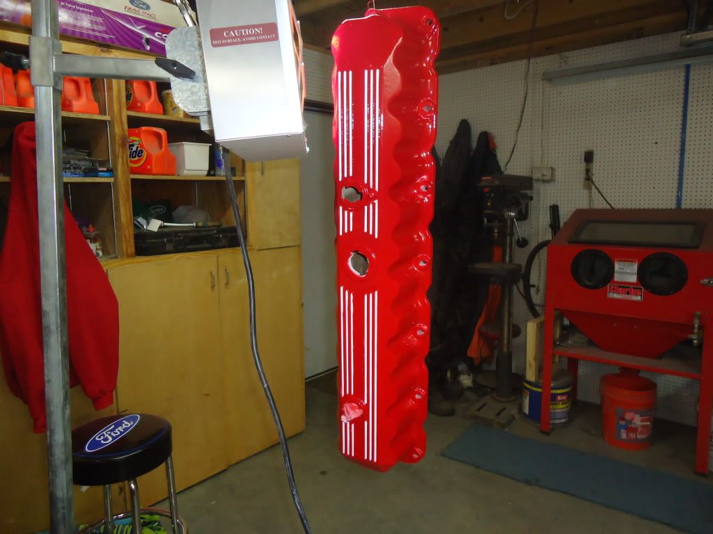

here is the valve cover. it is a stock valve cover off a 93 cherokee. I stripped it in my blast cabinet. then I powdercoated it white with my little eastwood kit.
then after that cooled I blew on the red. and wiped off the raised areas with masking tape. just blotting it on there, move blot etc.
then I baked it using a portable IR heater I got when I bought my powdercoating kit.

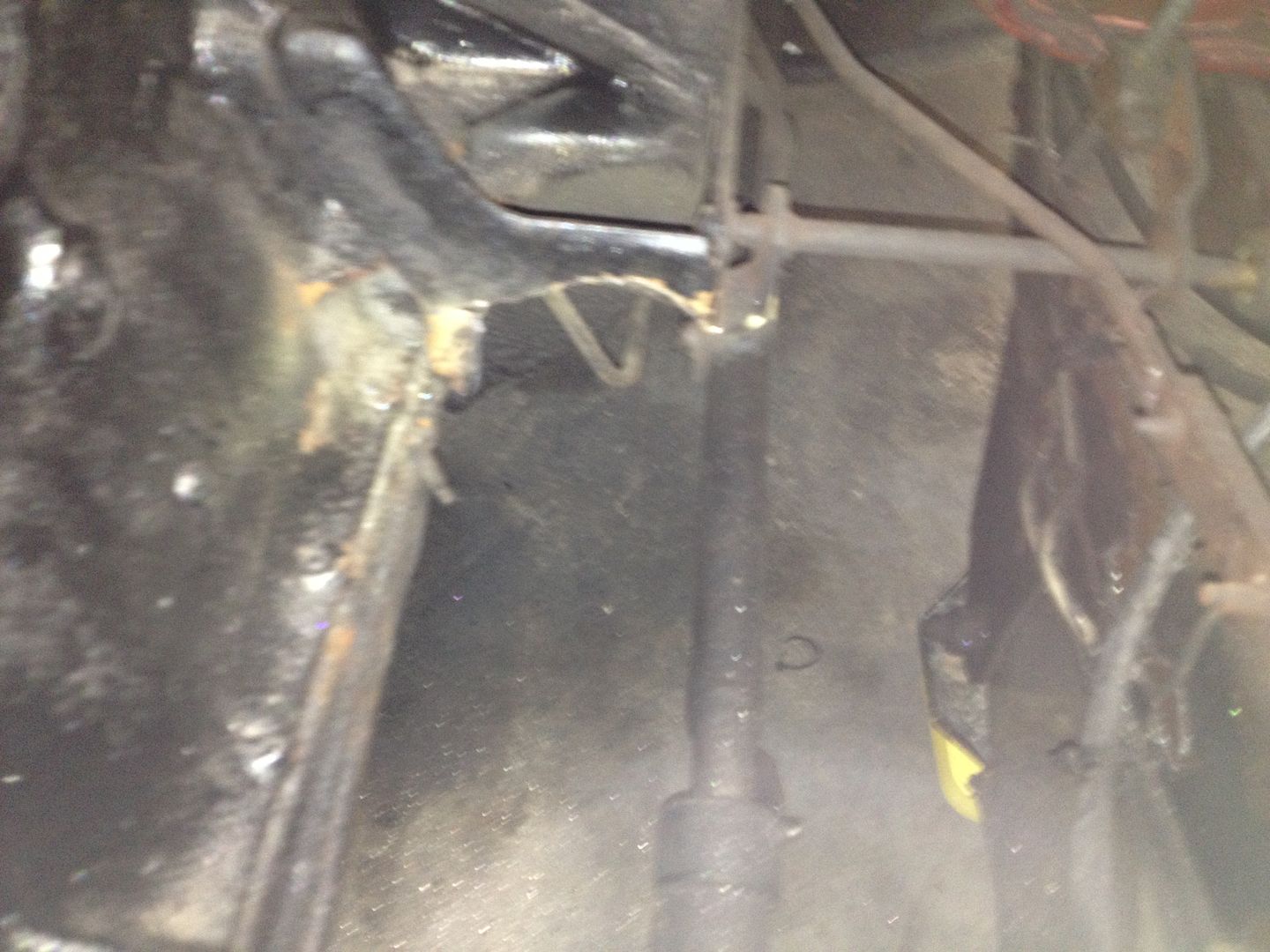

next we lifted the jeep up and started working underneath. we spliced the new prefilter, electric pump and fuel pressure regulator into the fuel lines back by the gas tank and mounted them to the cross member by using the bolts that hold the skid plate in place.
zip tied all the hoses up high out of the way. I also installed the new speed sensor at this time.
and a few other things I can't think of right now.
I also found out that In an automatic transmission conversion you have to convert the kickdown linkage to a cable which is not in the kit. so I ordered that.

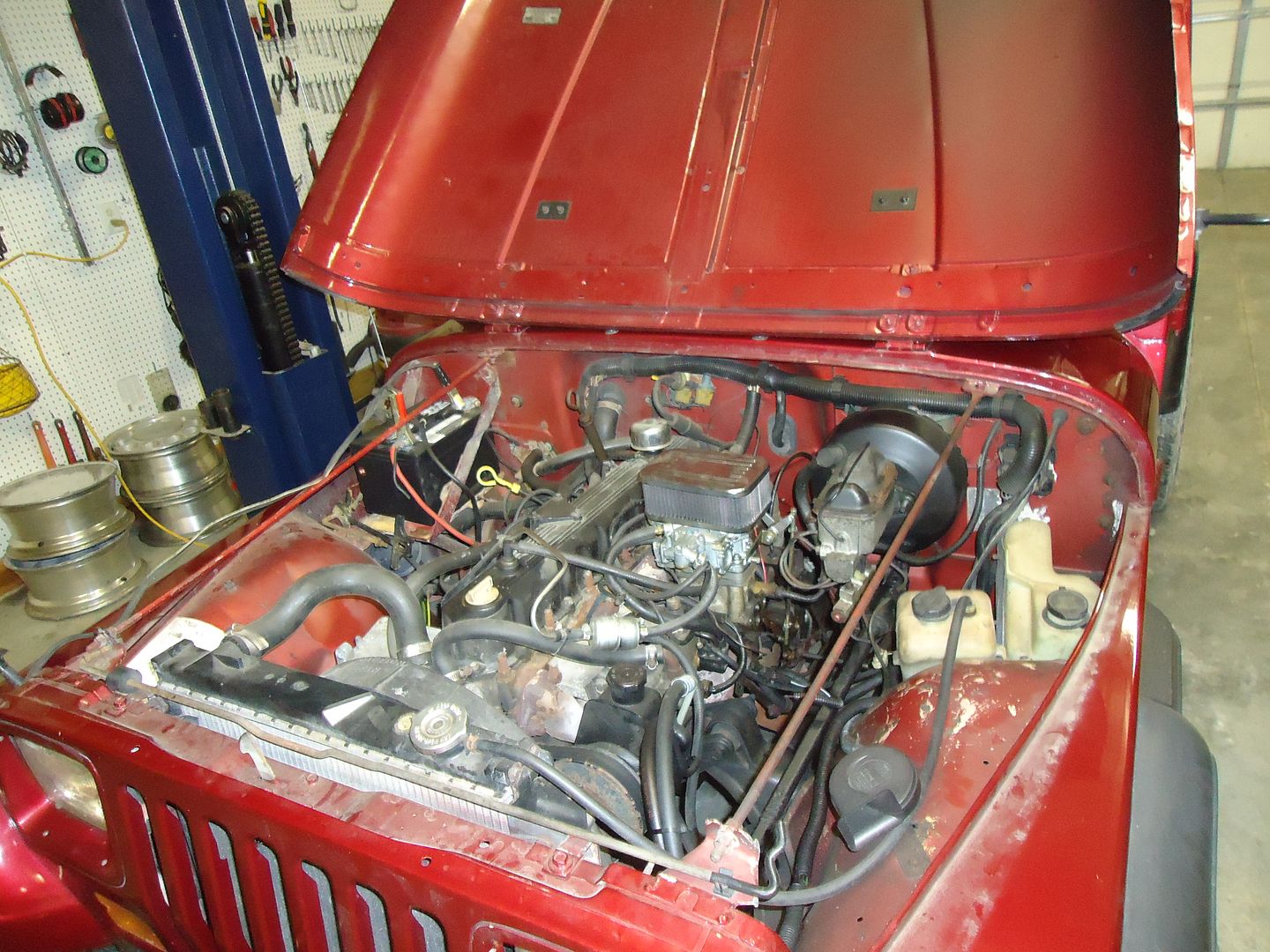

ok here is where we started

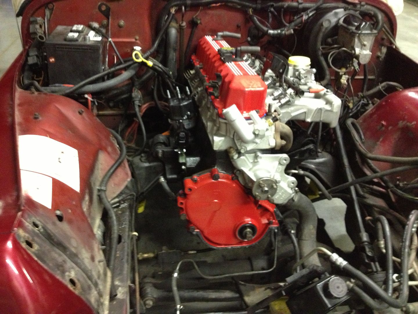

here is a pic of where I am at now.
so far the thing is running great. it has great throttle response and starts without touching the accelerator every time.

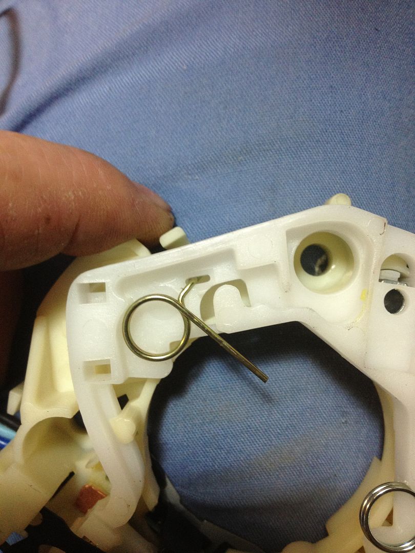

first the turn signal would not cancel when you turn left.
so I pulled the steering wheel. frequently you will see people say you need special tools to fix this little annoyance but you really don't. when I take the steering wheel off I almost never use a steering wheel puller. I loosen the nut until it is even with the top of the threads of the shaft. then pull up on the steering wheel with one hand and whack the nut sharply with a ball peen hammer. it nearly always pops off with just a whack or two. then finish removing it.
next remove the little plastic cover under the wheel by prying gentle with a screw driver.
then you have to remove the locking ring. this usually requires a special tool. I do not have that tool, but it is a very simple thing to accomplish.
I used an old piece of angle iron and two bolts, and a washer. once it is adjusted you just tighten the bolt on the shaft and it compresses the ring very easily.
then using an o-ring pick and a small screwdriver carefully work the lock ring out of the groove. then remove the ring.
this is what you will see then.
as you can see there is a small spring in the right upper side. there is not one on the other side. this is how it should look.
I have been told you can buy the spring separately but since sometimes there is a broken arm or the cancelling cam can be broken so I just bought the whole switch. it cost 23.00 at o'reillys. the spring would be a lot cheaper. since all that was wrong with it is the spring I decided to save the switch for the next time it brakes and just swap in the spring. also since this was the first time I had done this repair I wanted the complete switch so I could compare to see what was broken. anyway once I discovered what was wrong I tried to swap the spring in, but it would not slide into the small hole. on the new switch you can see there is a slot to make replacing it easier. so I used a small drill bit to slightly enlarge the hole. then the spring slid in without difficulty. then reassemble in reverse. piece of cake.
seriously I have been annoyed by this for months. and it was a very easy repair, it took less than an hour.

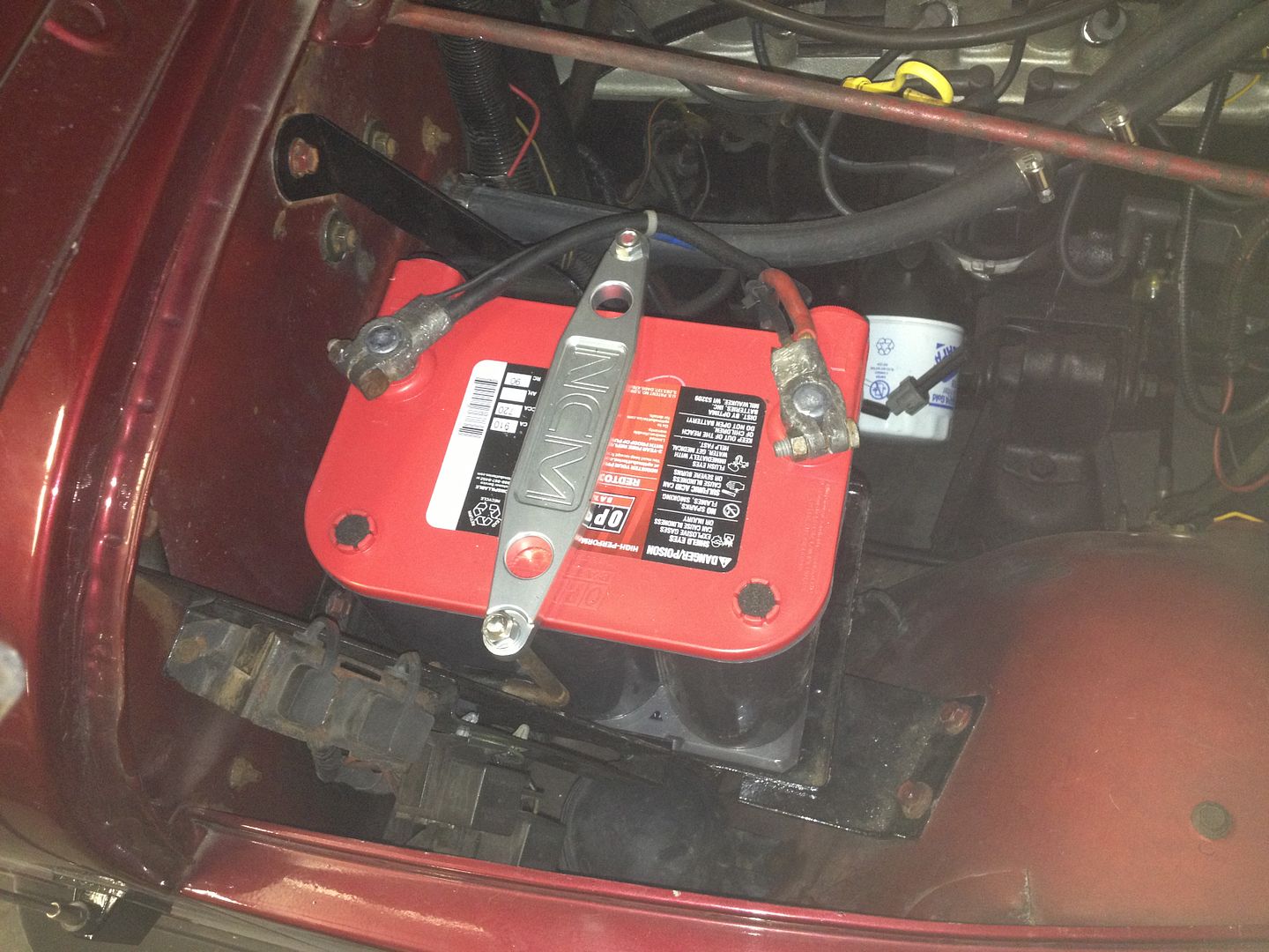

I also installed an optima red top battery today.
