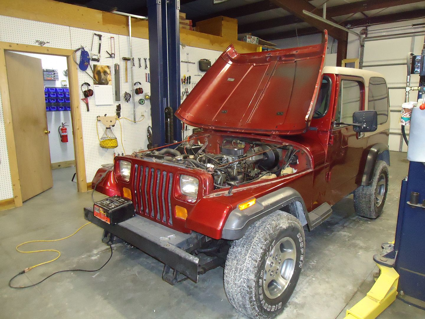

I bought this jeep off ebay from someone in Ohio. I never met him and I had the jeep shipped to me. that is the first time I had ever done that so I was not sure what I was going to get. the ebay description said the jeep ran but in talking to the owners mother after I bought it she said that he was having some problems with the idle. I asked them to send me some pictures of the engine because I assumed from the reading I had done on this year jeep that it had the stock carbureter on it and that was probably why it was having problems. they never did send me the pics so I had no idea what I was going to get when it got here. I was very excited when the truck pulled up. we tried to back the jeep off the trailer but it wouldn't start. we had to jump start it and we finally got it running enough to back it off the trailer. it would not stay running at all. I finally got the jeep up the half mile dirt road to my shop and it died again at the shop door so I pushed it into the shop to see what I had bought lol. here are some pics.
overall I was very happy with it. so after I got it into the shop I put the battery charger on it and started looking it over. the first priority was to get it running properly.

I was very pleasantly surprised when I popped the hood to see the weber carb already installed. My Dad is a retired mechanic. he lives nearby now. I finally got him to move out here after I built the shop. He did not want to leave all his tools and stuff at home but since my Mom died he was living all alone out there so I built the shop and convinced him to move out here. Now we tinker in my garage for fun.
anyway once we started looking at the engine we found a couple problems right off. first was that the vacuum advance was completely missing off the distributor. the little lever was sticking out of the distributor just flopping all over the place. secondly the vacuum lines were totally screwed up. and the lines to the transfer case were just cut off with what looked like a pair of side cutters. anyway after quite a bit of reading on here about the vacuum lines we got that sorted out, put in a remanufactured distributor, new plugs and wires, and a new fuel filter. then we did the nutter bypass and voila.
it started right up. We spent a bit of time setting the timing, and adjusting the carburetor and it starts right up and runs like a champ. now the thing runs so good I am in no hurry to swap that 4.0 in lol.

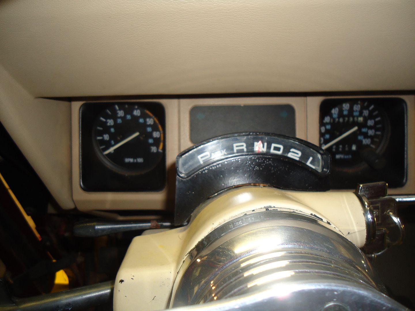

after that I started tackling some of the little things that needed fixed. first I fixed a lot of little electrical problems like instrument cluster lights, and one of the biggest headaches I had was that stupid little light in the gear shift indicator. the indicator arm was broken and I found a new one to replace it. that was the easy part. I tried to replace the bulb and it would not come out. since I have never had to deal with that problem before I was not sure how the bulb was supposed to be replaced. I finally found out that it was just like the rest of the bulbs in the interior it was just completely corroded in the socket. so I ended up destroying the bulb but I got it fixed. I fixed the housing with j-b weld and painted it black. this was a big problem for my daughter as she can't quite get past the idea of if the gear indicator can't be seen how do you know what gear it is in. anyway it was a small but annoying problem fixed.
then in order to get it inspected I had to fix the horn. that was another much more difficult problem than it should have been. getting it running was easy compared to that lol.
first when I got the jeep obviously there was no horn button on there.
but before I bought a new horn button I started at the horn and found out that it was bad. so I swapped in a new horn. then I could make it honk by running current to it. so far so good so I tried to find a horn button that would work. it turns out after much sweating and figureing that the steering wheel that was installed and the installation kit that came with it were not compatible with this jeep. so I got a new steering wheel and adapter. I also bought the little horn hardware kit from napa to replace the spring contacts. then I had to replace the turn signal cancelling cam.
now in a mustang that is pretty easy. on this jeep it is obviously a bit more complicated because you have to remove that little snapring that holds it all in. I read that there was a special tool needed to fix that, I did not have that tool so I made this out of a couple bolts and a piece of angle iron from my scrap pile.
not pretty but it worked.
then the new steering wheel.

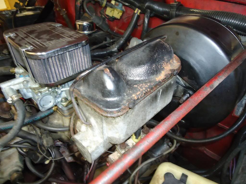

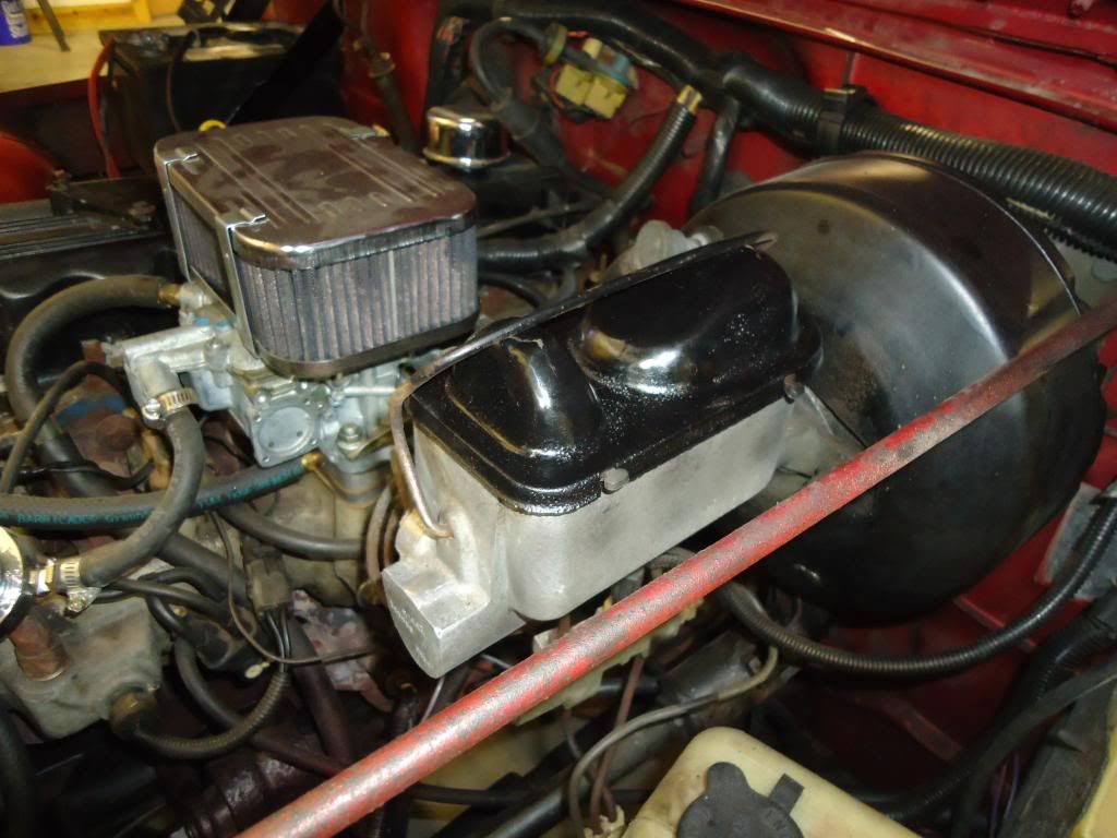

then I tackled some cosmetic issues. first I know I have spent too much time building mustangs but the grimy ugly engine compartment just bugged me so I spent some time with a pressure washer cleaned up where they obviously had a power steering hose fail as the entire engine compartment was covered in it. next I hate looking at rust so the master cylinder cap bugged me.
so I blasted it in my bead blaster and powdercoated it with my eastwood powdercoating system.

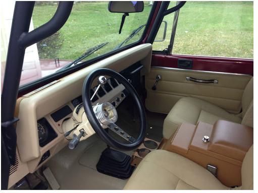

some of the things I am very happy with on this jeep are that the seats are nice aftermarket seats that are pretty comfortable. they look better in the pictures than they do in person so I may get some seat covers soon. I had some of those wet okeole seat covers on my 95 and I liked them so we will see. I also am very happy that the prior owner put in those nice tuffy security consoles. however I only have one key for them so I am going to have to contact tuffy to see if I can get some copies. I really like the wheels. I would like them to be a bit wider however. I have always like the look of those bushwacker flares so I plan to put some of those on someday. I like having a hardtop. this one needs some work. the weatherstripping is shot, the attachment point in the front is all rusted, the window tint has holes in it and the rear defroster doesn't work. it also is in need of some paint. but overall the jeep is in pretty decent shape now and I have been using it a lot this summer. I drive it to work sometimes and my daughter has been trying to monopolize it to drive to school. I pulled the top off a couple months ago and put a bikini top on it for the summer and I plan to tackle the hardtop soon because it is going to start getting cold again soon. more pics to follow.

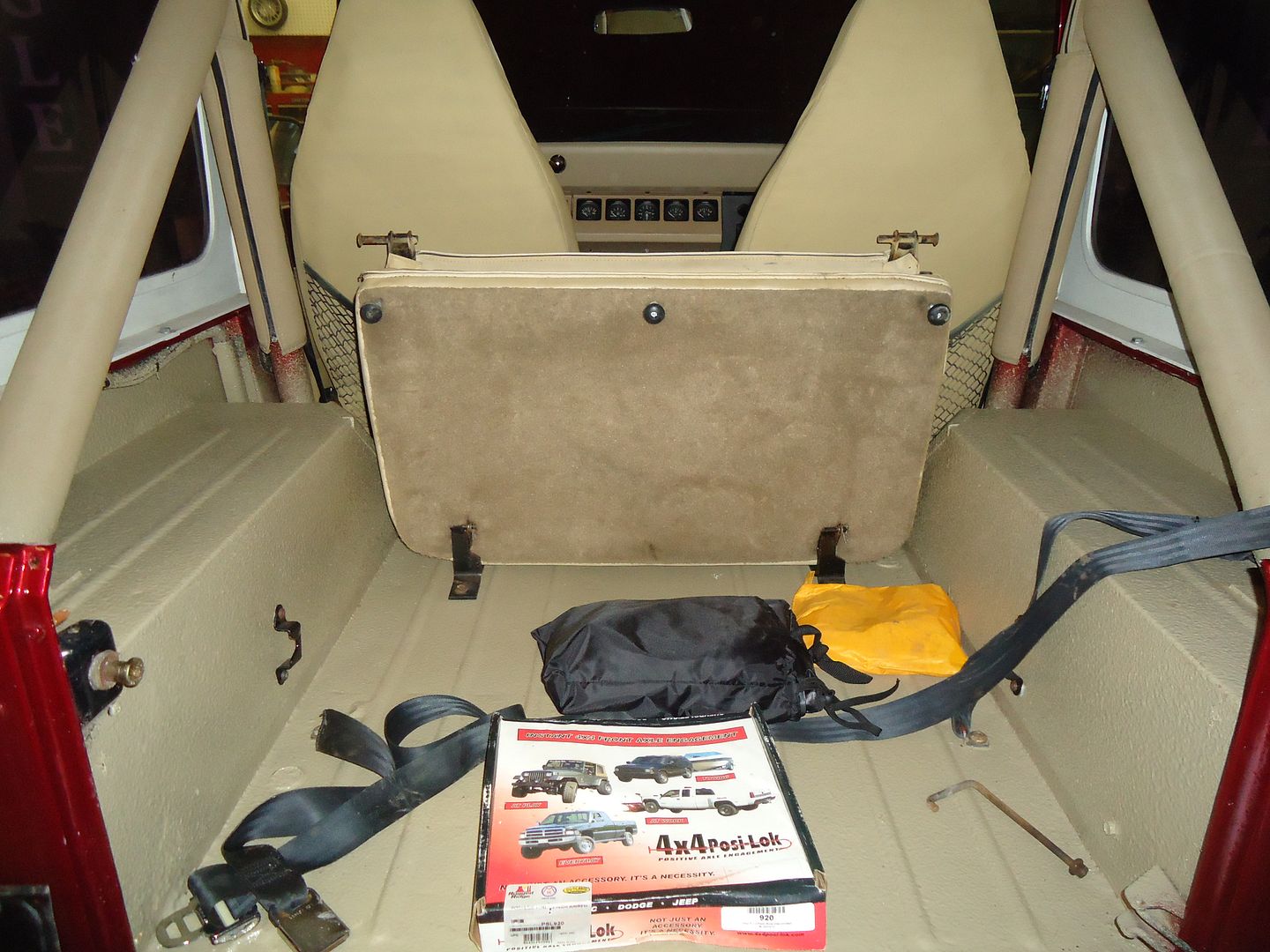

the inside has bed liner of some sort all over it but not the underside. some day I would like to line the underside to protect it.
