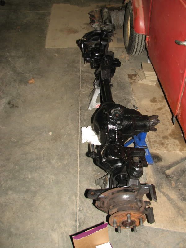

Pulled the front axle out, gonna send it to the shop to have 4:10 gears put in it.

Thanks. I plan on taking the D30 to get 4:10 gears put in monday. Eventually will have a front locker, but don't have the money right now. I hope the lift and axle swap are in by this coming up week.

Took the dana 30 to East coast gear supply today. I'll pick it up in a couple of days. should have the front done this week, then onto the rear axle.

Also got the D30 back from east coast gear supply. they put 4:10 gear in it for me. painted it
