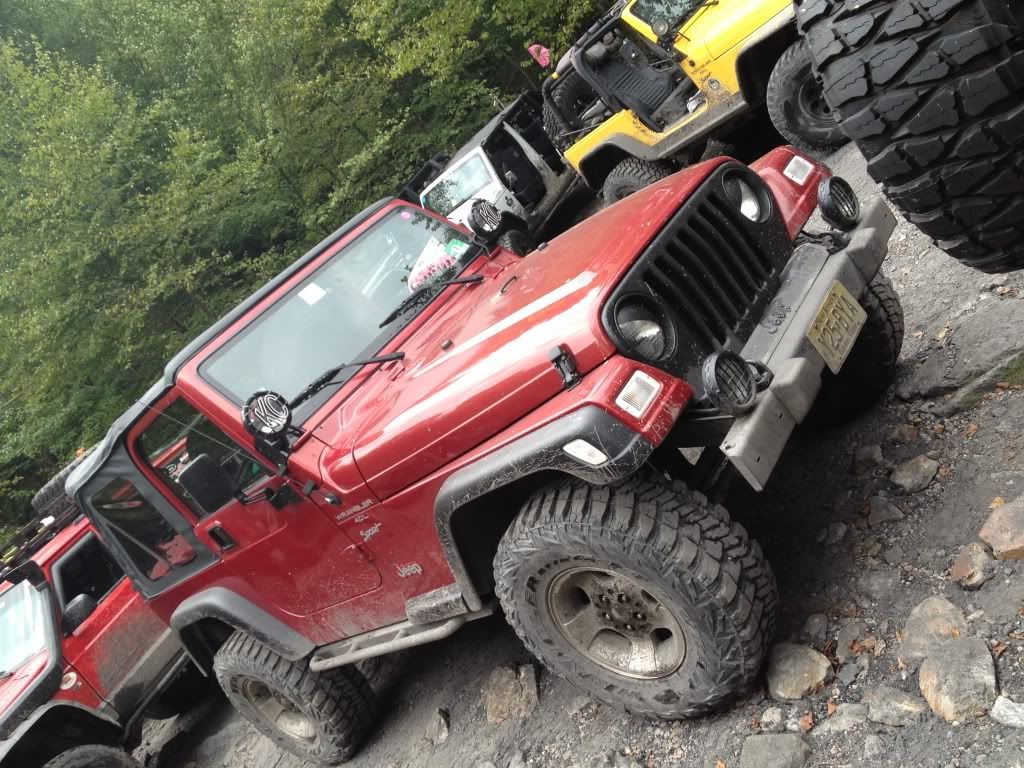

OK... I was pretty weak with picture taking at Topless for Tatas but here are a few:
nice PA road!

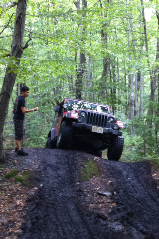

This was a gutter, I wish I had better pics because this was a tough obstacle for me and I'm sure it would have been a great shot! this is toward the end of it. and the second photo is a nice shot of my two favorite boys

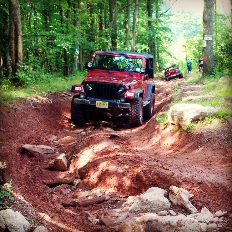

And here are two cool videos I'll link from Topless for Tatas as well:
the bowla steep mound

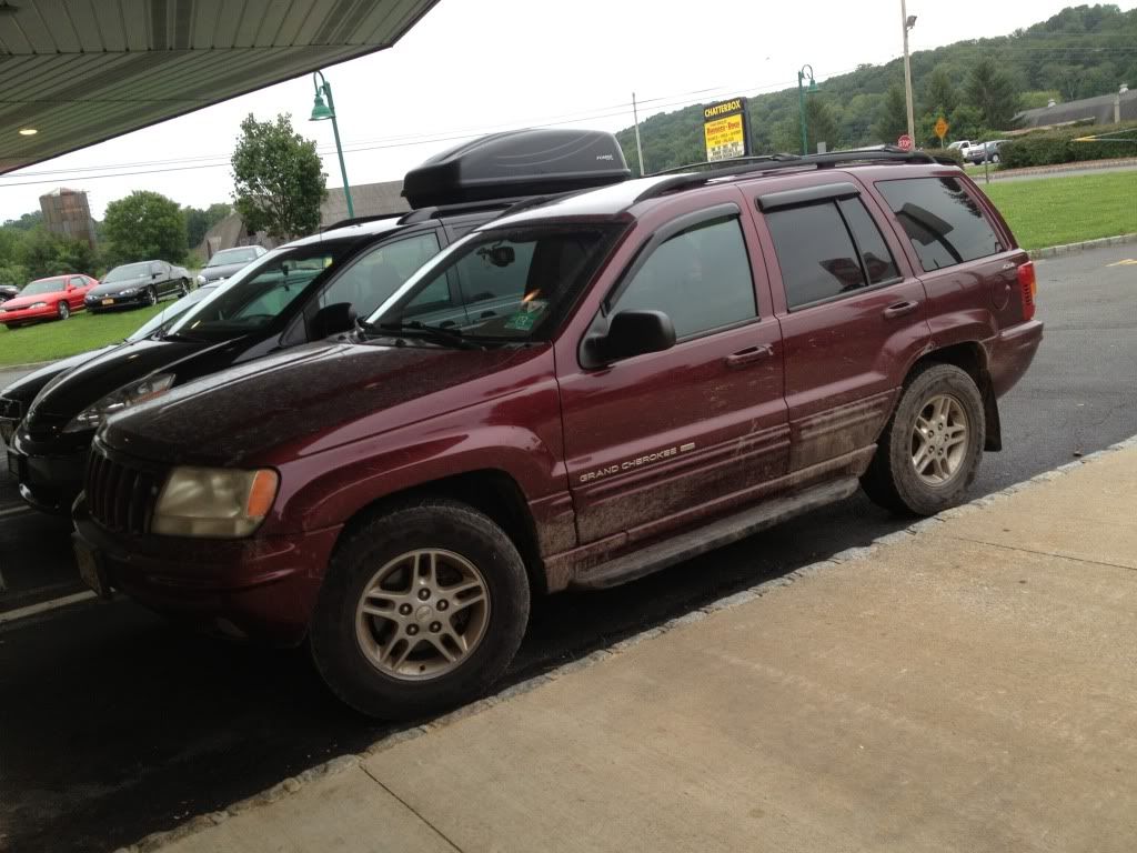

took the WJ out last Sunday to Stokes, ripped it
a video of riding in the WJ! video 1

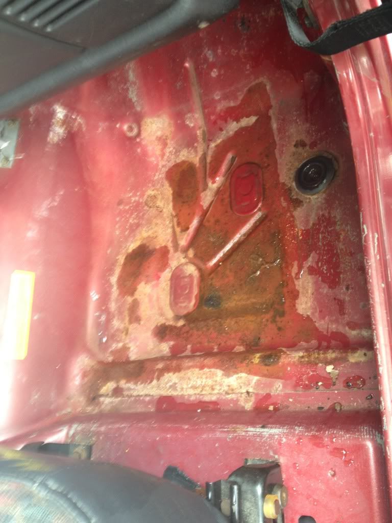

Currently addressing this little number today... I have a passenger leak and it caused some pretty decent rusting on the passenger floor pan. Probably will hit it with a wire brush and some rust stopping paint and seal it up with some bed liner... Then invest in bed tred.
