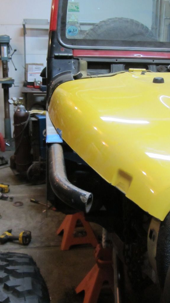

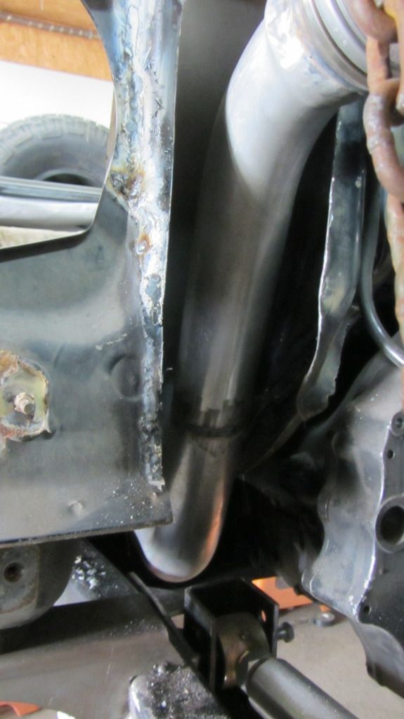

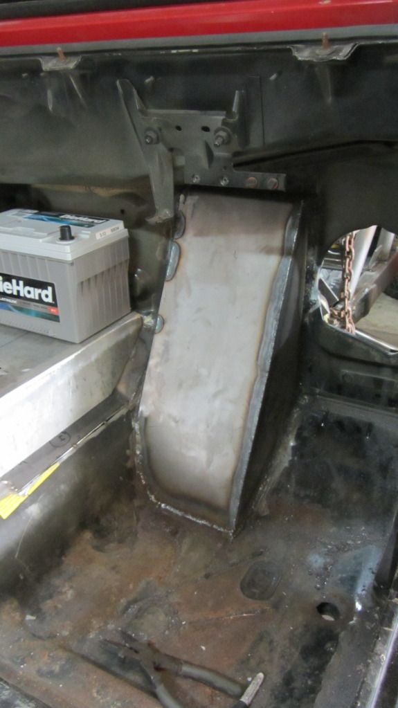

felt like **** today so I did nothing to the jeep. But here are some things I did yesterday.
Exhaust cover
Then some ideas for front fenders. I have two Ideas in mind and I am leaning towards this kind of style.
Exhaust cover
Guess you do not have plans for a heater? Other than the down pipe in the passenger floor.
Looks great dude. You going to wheel in Oct at badlands?
I actually will have a small heater. It is going where the battery is at in that photo.

The fenders will look great like that. Also the boatsides are sexy from that angle.
Yea i thinking im sticking them like that. I just have to get some AL tube ordered. I love the boat sides also. Cant wait to skin them with some AL.
See hendrix, let there be a heater
