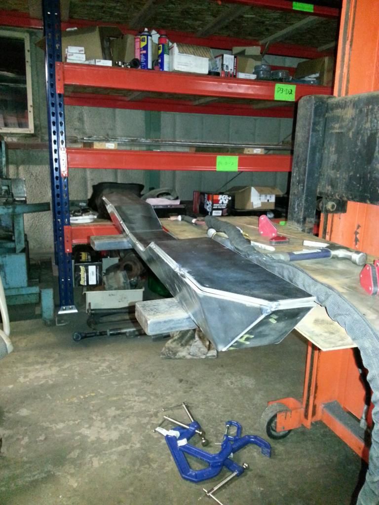

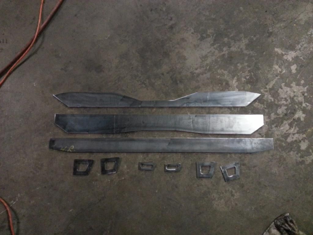

I have 8 more nights. And I am still busting ***.

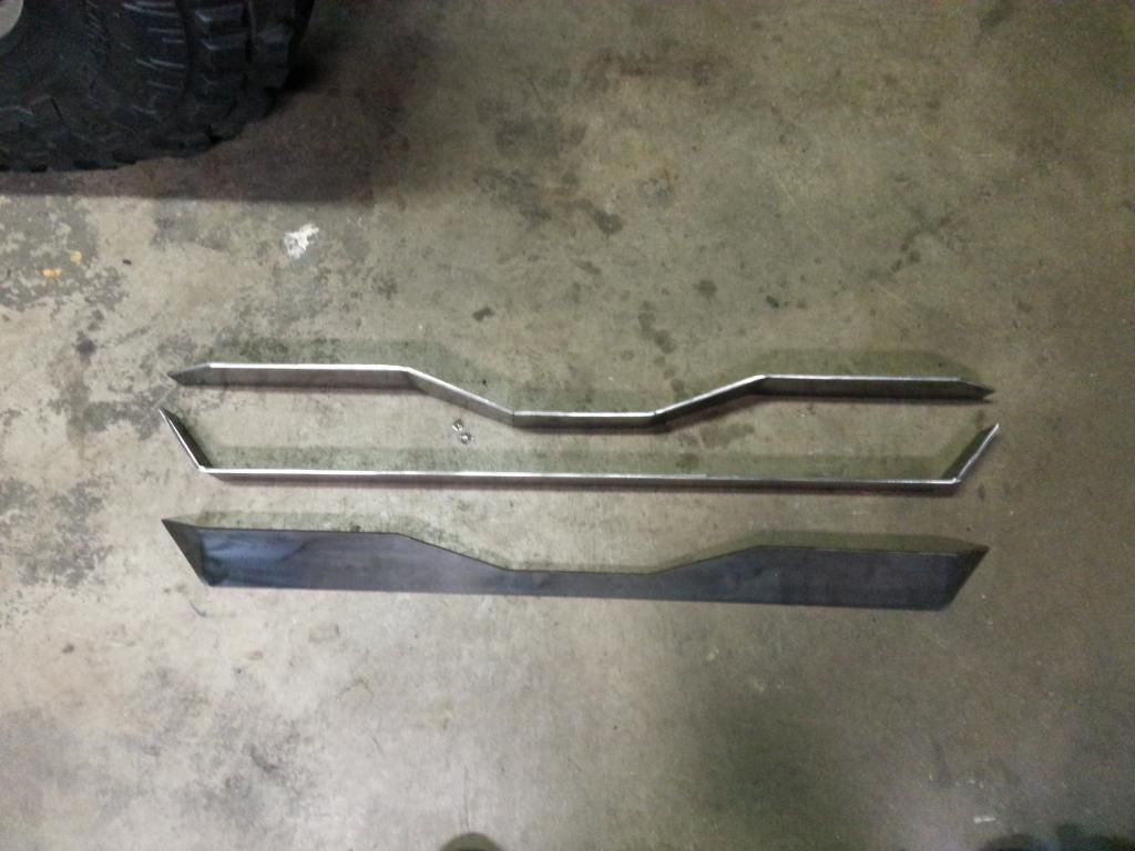

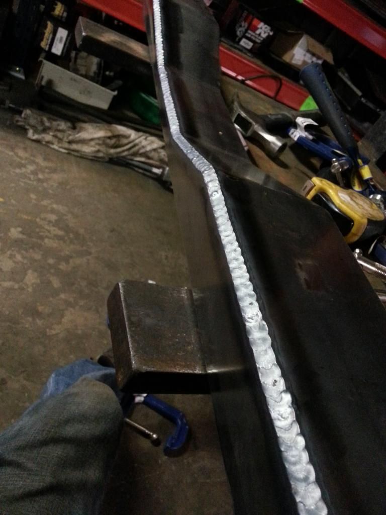

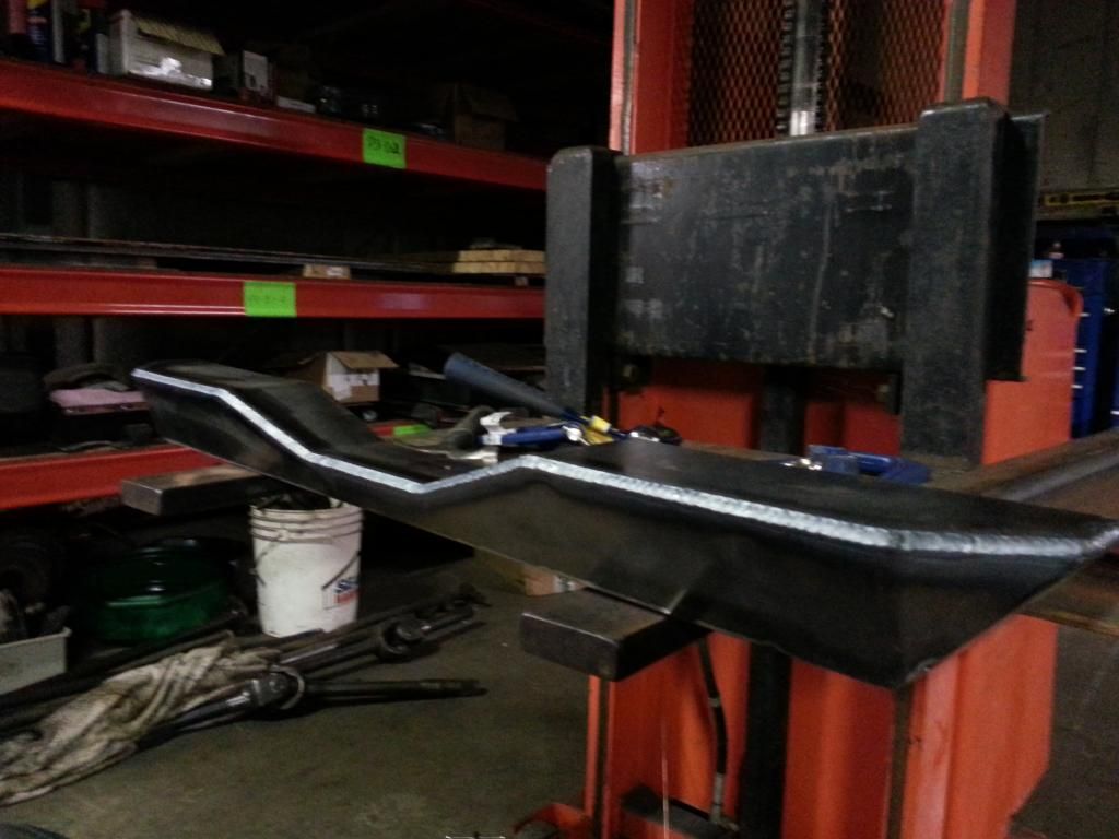

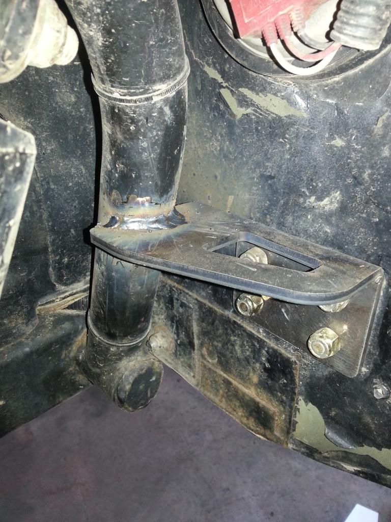

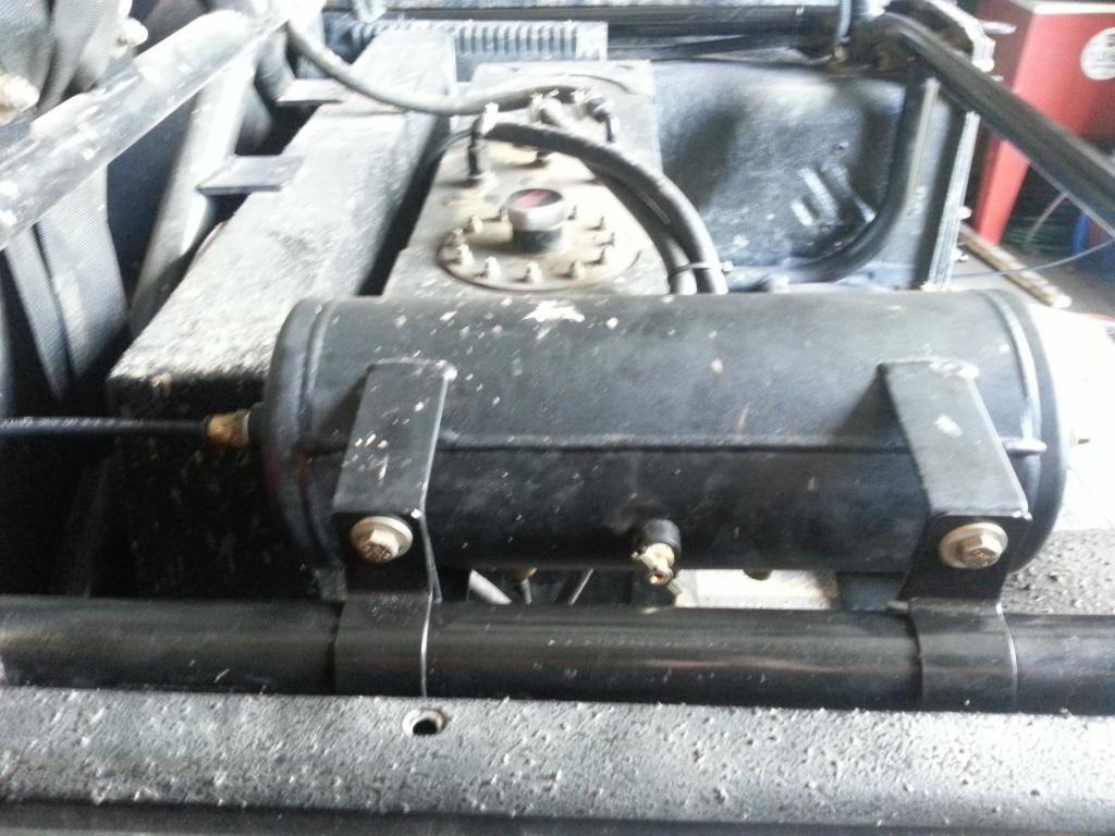

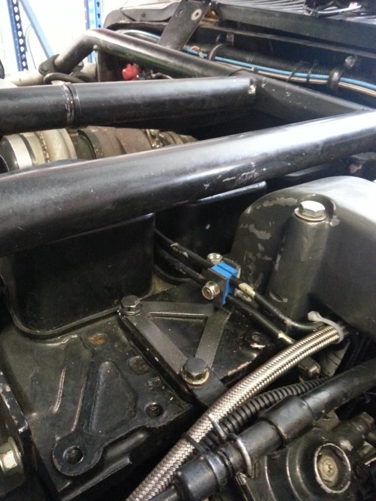

Few nights ago I made some simple but effective mounts.

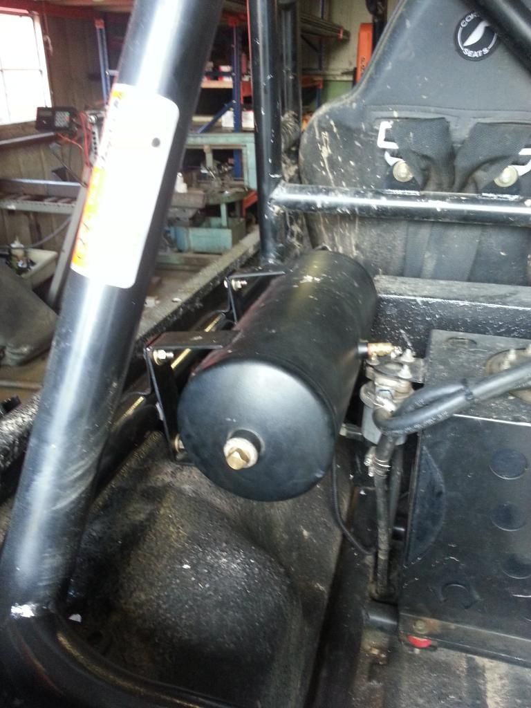

Injector Line Clamp
Air Tank Mount

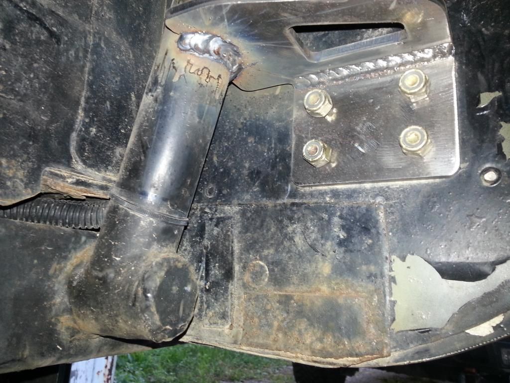

Rear Tire Carrier - Tieins

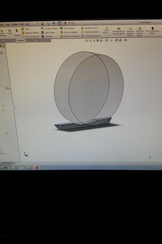

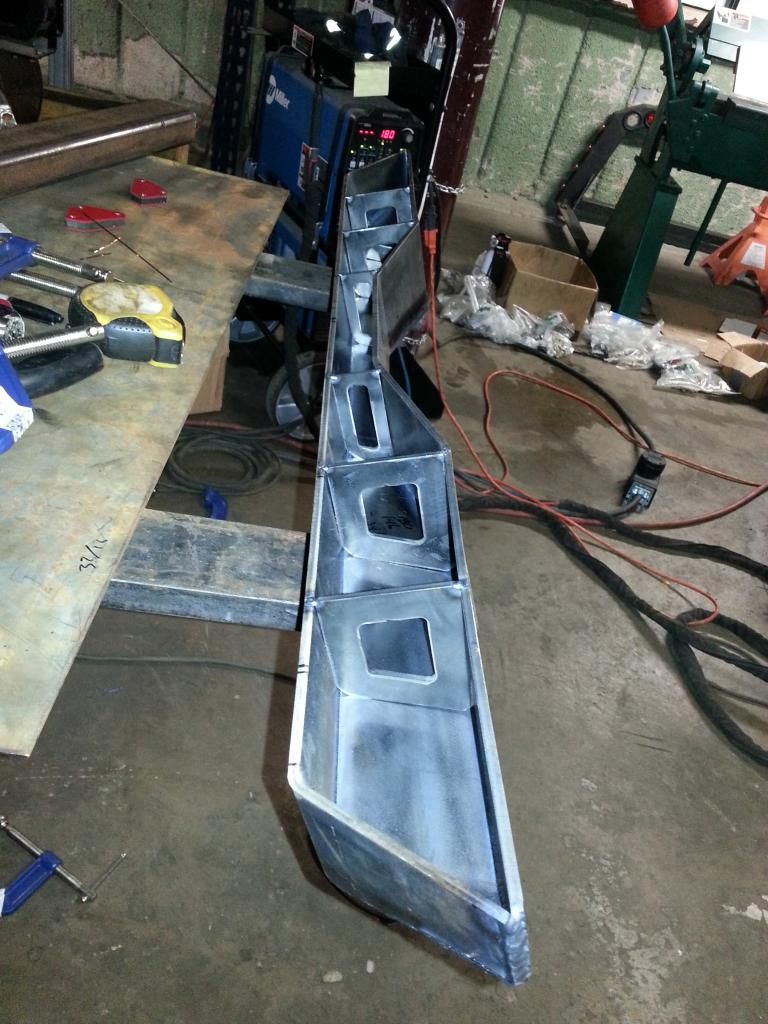

Then last night I was in the shop from 7 to midnight.
3D Model.

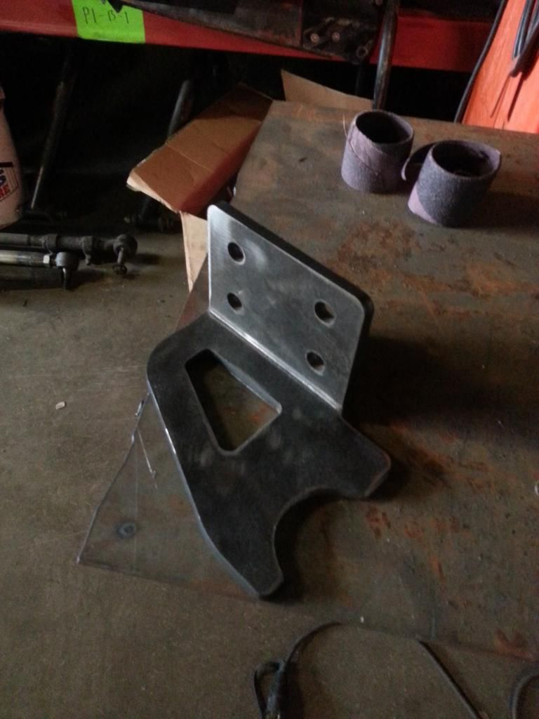

Plasma cut and scribed plate
Broke them
Tacked up
Tig Welded.
Inside Braces
Laying on the Frame
Still need to bolt it in place, and paint it.
Jeffery 2.0 : Cummins 4bt, 40's, ORI's, D60, 14B, lots of AL
ksilovich is offline

Bumper looks good.

That is really nice

I see you have a carter style electric fuel pump in one of the pics so fuel pressure as I suggested is most likely not your problem.
Nice work on the bumper and the welding looks top notch.

I checked the lift pump on the engine and the lever was up. And the pump is only a hear old. The one on the fuel cell is only used for off camber situations and priming after fuel filters changes. I should get the brake line tomorrow so I am going to do more testing then.

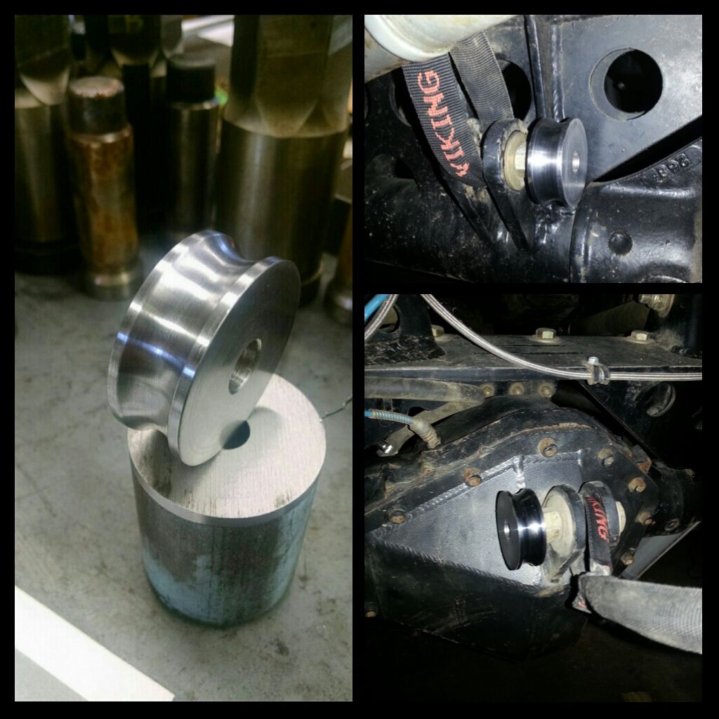

Had a friend machine me some pulleys for the SD winches. Normal pulleys would not fit in my current mounts.
