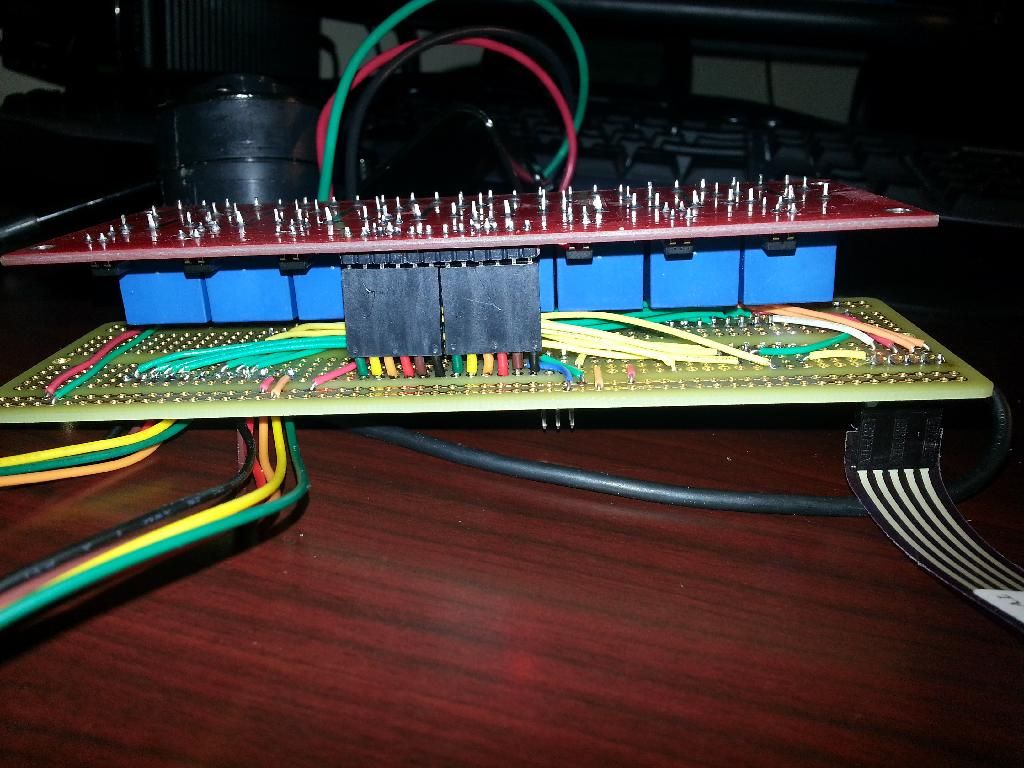

Completely non jeep related, but I am pretty proud of it is, that I made an Air Bag Controller for a buddy of mine at work this last weekend. Its going on his Audi. There will be 3 define heights and then an Auto feature that will re level the weight in the car is shifted (still a work in progress)
Breadboard - Proto
Finished - Proto
All wire are on the bottom side so it looks clean from the outside.
Now just waiting for him to mount the sensor so I can fine tune the code.
