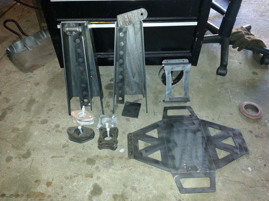

working away. Getting ready for next weekend.
Are those your new front coilover mounts? You should sell those as a kit, they are nice.
What's wrong with your current front coilover mounts, not strong enough/ flexing?
Yup those are my new CO mounts. Nothings wrong with my current setup. I just need to clear up some room on the passenger side.
Built these with the intention of pushing my intercooler back up against my radiator. That way I can shell the grill out. Also this should allow me to run the intake tube right over the top of them. (adding the cross brace behind the mount not up top) All in all is should clean up my front end.
If I was to sell them as a kit. Id have to make the out side piece a little bit bigger. You cant fit a large mig gun down in there to weld Learned the hard way. Going to use my buddies Miller 140 with a smaller gun to get down in there.
Cut out the rest of the parts to get a good start on the tube work next weekend. I cut out some 2 and 4 bolt flanges out of Steel and AL. Then made the top of the battery box mount. And then cut out the bottom. Just waiting to use my friends box/pan brake to bend it up.
