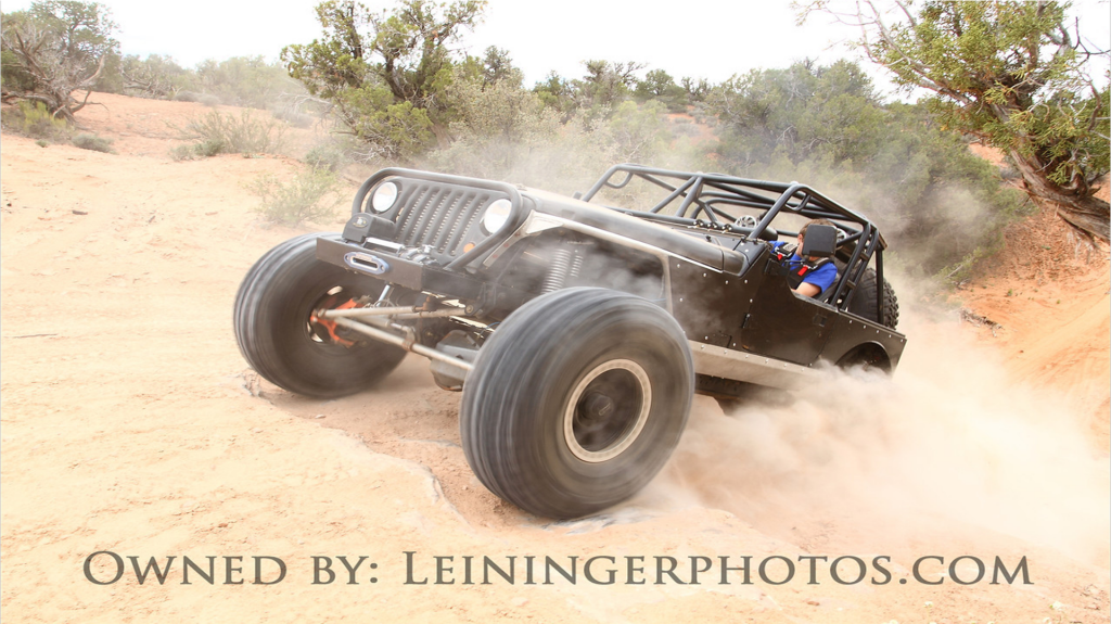

Front wheel drive

post #623 of 1411 Old 05-28-2013, 07:58 PM
AngryTJ
Posts: 4,468
That picture is awesome!
AngryTJ is offline
post #624 of 1411 Old 05-28-2013, 09:05 PM Thread Starter
ksilovich
Location: Ottawa
Posts: 1,124
Yea I like this photo alot. I was getting bored on Dome Plateau so I thought I would do the "hard" stuff only in front wheel drive. It was alot tricky-er then I thought it would be.
Jeffery 2.0 : Cummins 4bt, 40's, ORI's, D60, 14B, lots of AL
ksilovich is offline
post #625 of 1411 Old 05-28-2013, 09:22 PM
aw12345
Location: ontario
Posts: 7,285
Originally Posted by ksilovich View Post
Front wheel drive
That pic is so bad@ss
aw12345 is offline
post #626 of 1411 Old 05-28-2013, 09:54 PM
Danno6102
Posts: 1,572
That pic is f'ing saweet!!
"Evolution through carnage, the Jeep will keep what it needs."
Danno6102 is offline
post #627 of 1411 Old 06-02-2013, 03:04 PM
