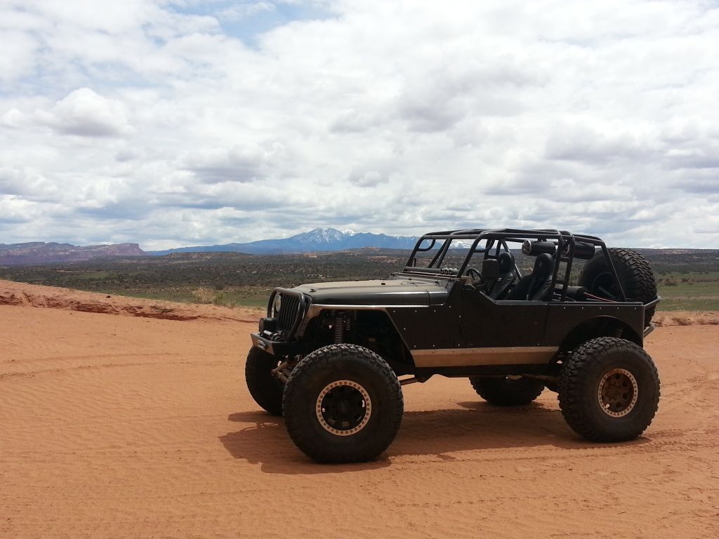

post #596 of 1411 Old 05-20-2013, 10:53 PM Thread Starter
ksilovich
Location: Ottawa
Posts: 1,124
In moab. After a long week of working and busting @ss. It was well worth it.

post #597 of 1411 Old 05-20-2013, 11:22 PM
JJeeper09
Location: Richmond
Posts: 2,190
Awesome! Can't wait to see more
JJeeper09 is offline
post #598 of 1411 Old 05-21-2013, 12:30 AM
McChillen
Location: Hudson/Columbus
Posts: 152
Looks amazing!
McChillen is offline
post #599 of 1411 Old 05-21-2013, 04:28 AM
platinum5.9
2003 WJ
Location: Olean
Posts: 2,060
That's so awesome... Can't wait to see pictures and video.
03 Grand/WJ-White 4.7HO/QD/242HD Clayton 6" LA,5100,Clayton skid,Custom Rockers,JK OME SS,17"Rock Monsters 33"Interco Irok ND,Muffler delete/MF cats,SOLID D30/BTF D44a,Fawkes,Projectors/HID
platinum5.9 is offline
post #600 of 1411 Old 05-21-2013, 05:02 AM
Danno6102
Posts: 1,572
That thing looks sick with matching paint! Have fun in Moab!
