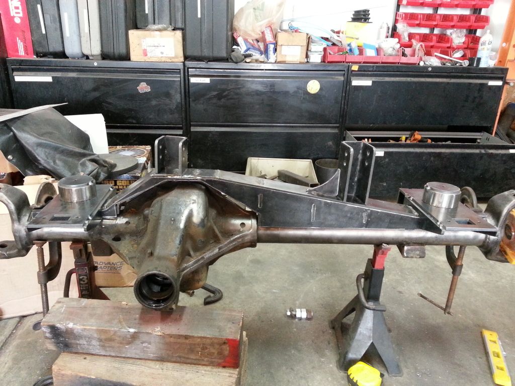

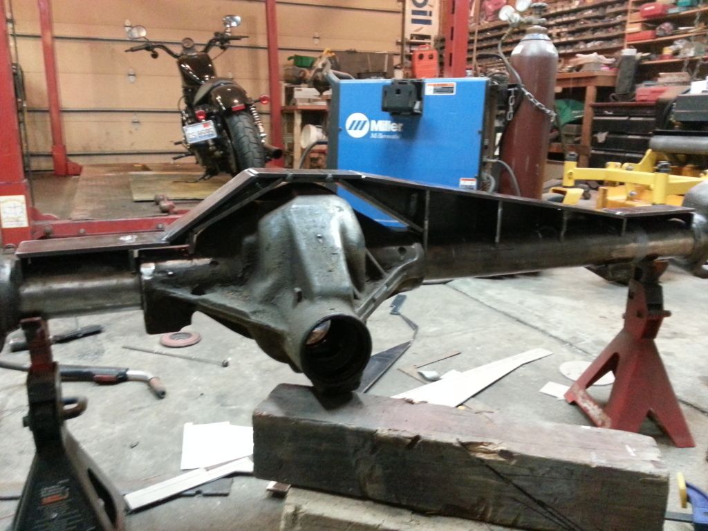

In the mean time I still did some fabrication. I did a full D44 Waggy truss for a friend of mine.
Hard to see. But inside has multiple supports and around the diff is all gusseted internally.

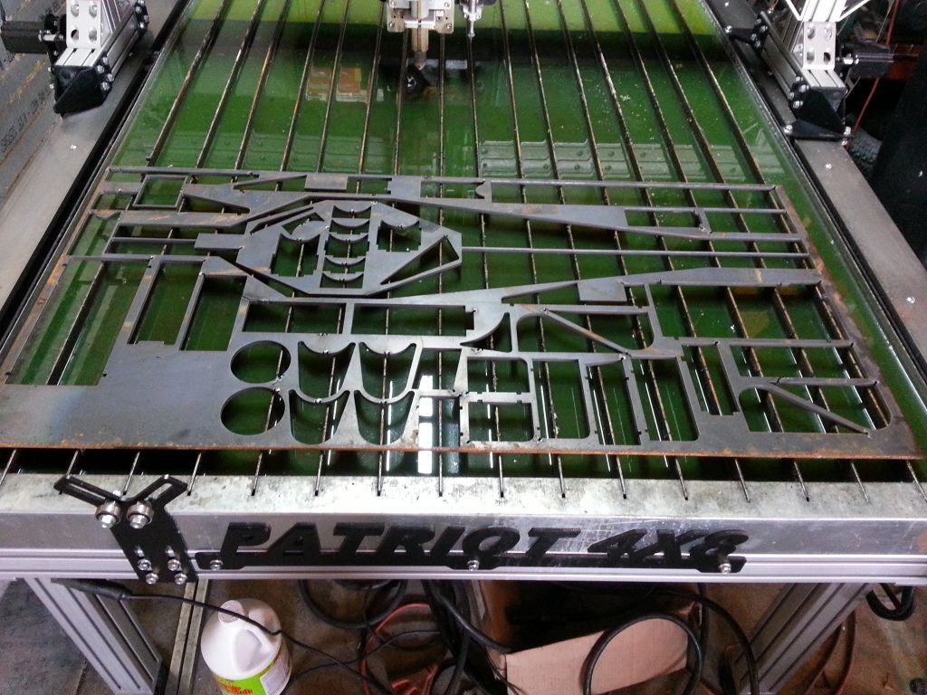

Carefully nested it all onto a 2x4' sheet of 0.25
