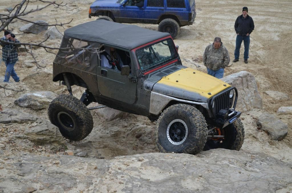

Originally Posted by aw12345 View Post
By looking at all the pictures the ORI's are doing some interesting stuff
I feel like the rear is alittle to soft for me. Front seemed to preform flawless.
Yes mom
Talk about flex

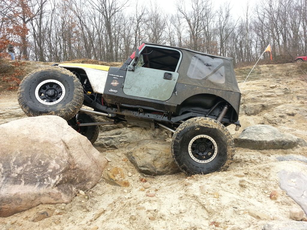

Look at all the pics Jeff took as far as flex goes, squatting and what not
Don't know squat about how ORI's work, but the claim is that they do not unload, seems like they do also the back seems to flex earlier and more than the front, it's nice when the front and back flexes equally so the body stays relatively straight and the axles just articulate. I am sure you will get it adjusted to your liking. Still love the pic of climbing a ledge with 4 tires spinning and the coal coming out of the back, those pics are priceless.
Looks like it has some serious torque
aw12345 is offline
post #555 of 1411 Old 03-19-2013, 06:19 AM
roes
1947 CJ2A
Location: Syracuse, IN
Posts: 30
The nitrogen pressure in the bottom controls the struts "spring rate", that most likely needs increased in the rear. It takes 2-3 tries to get everything adjusted to your liking for each vehicle.
