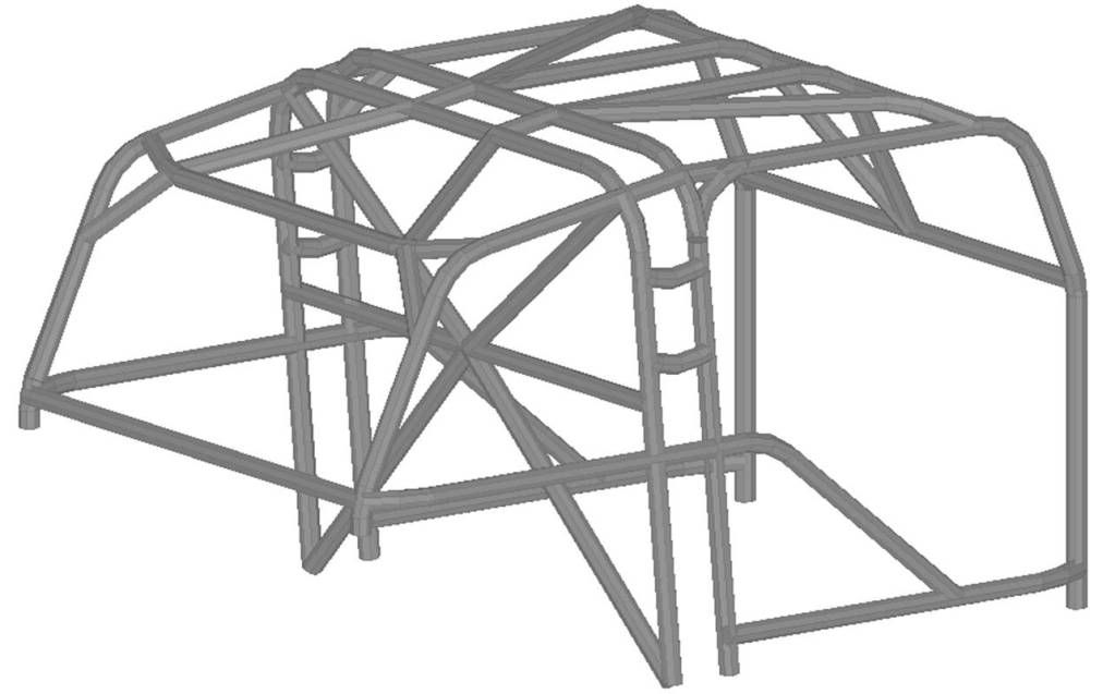

Why the double C pillar?
You mean double b?
Because I want something different. And how often do you see that on a tj.

Seems like an expensive and labor intensive way to be different. Different for sure. That's a lot of notching though. Lol

Its only another stick, so it wont cost that much more. And whats another 20 notchs, when you look at all the other fab that needs to be done.
I like it. I always thought it would look cool to run some flat plate between the double pillars, then cut some holes and dimple them. Saw it on a build over on Pirate some time ago.
I thought of that today during class. but I think I am going to stick with the tube for right now.
And After talking with a couple guys today I made some changes to the original design. I added some Triangulation above my head, and then i redid the upper C cross bar, and added the lower B-A bar with the seat bar, and added the windshield "V".
I also left a space bewteen the two middle bars between B-A because I want to add a switch panel up above.
Not that anyone cares, but if you do. There is 121 ft of tube their, and will weigh around 435 lbs.
The sad part is I will have to redraw all this up again, because this is built off rough measurement. I have to get the windshield in and take some for sure measurements.
And here is a photo i did between classes. The Dang engineering lab didnt have photo shop, so I had to use MS paint.
Jeffery 2.0 : Cummins 4bt, 40's, ORI's, D60, 14B, lots of AL
ksilovich is offline
post #40 of 1411 Old 01-23-2012, 07:57 PM
AngryTJ
Posts: 4,468
that is a very very complex design. Almost too busy IMO
Follow me on Instagram @ Tarantula_TJ

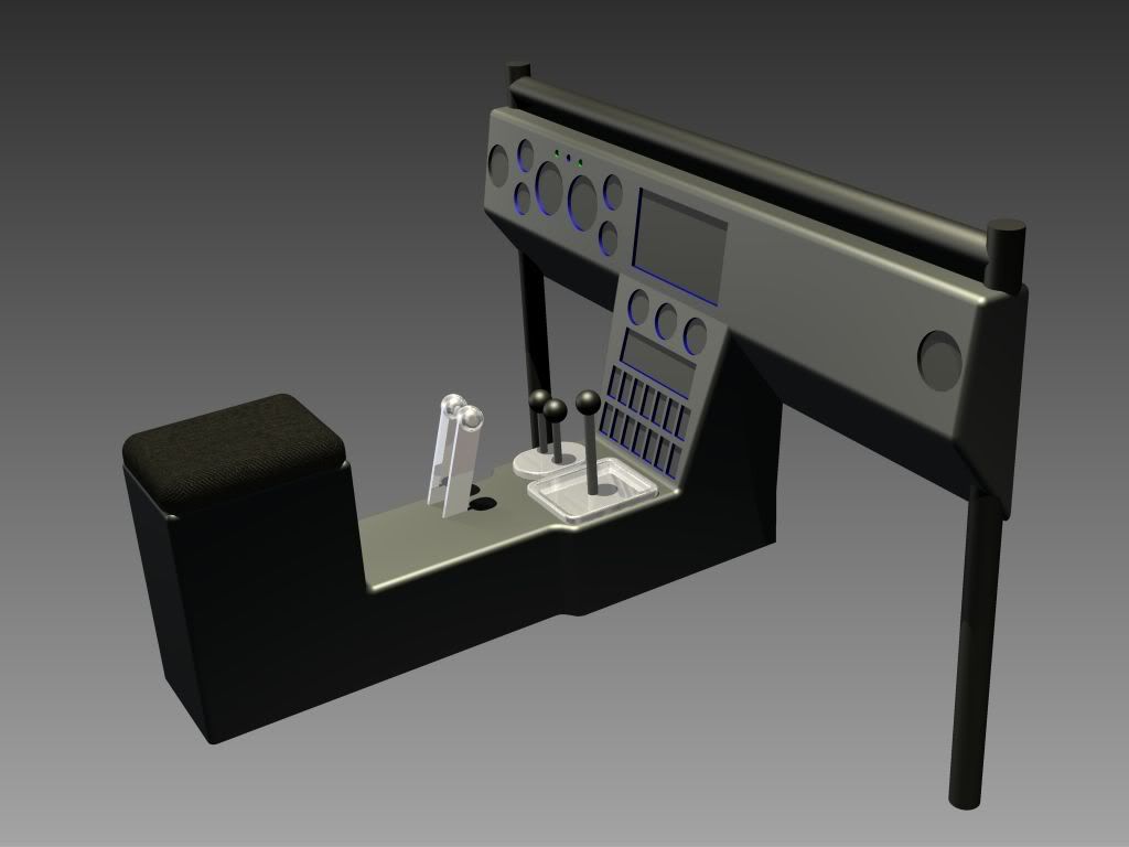

Since I havent been home to work on it. I did this between classes yesterday. Just wish I could do it for real.

Sick. You're pretty good on that CAD stuff
With the right programs its pretty easy. Also took 2 years of it back in high school so that sure helps out

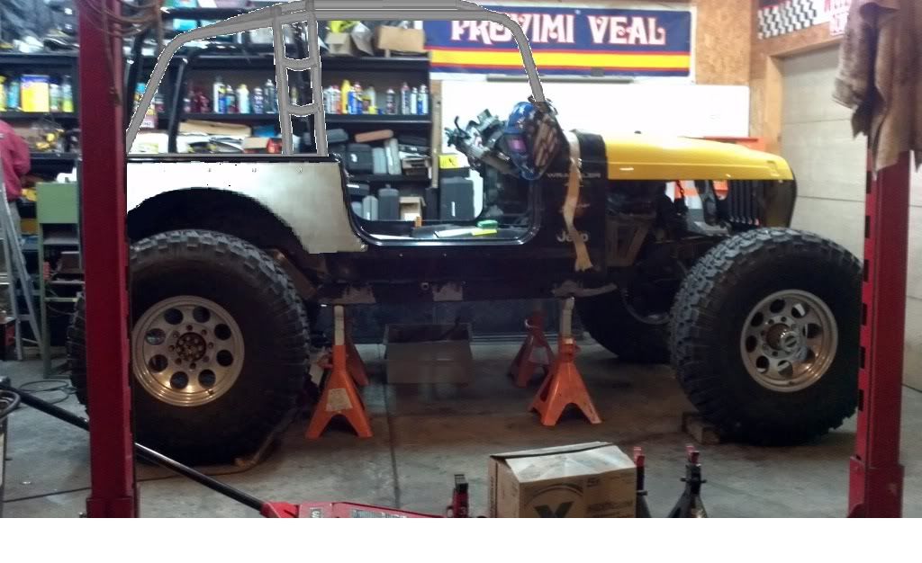

Finally got to work on the jeep this weekend. I got the atlas all assembled and mated it to the trans. (what a b**** that was)
Then i cut the tub up a little more to redo the tunnel. I took my time, and made it out of poster board to make sure it came out like I wanted it to.
I am please on how it turned out.
