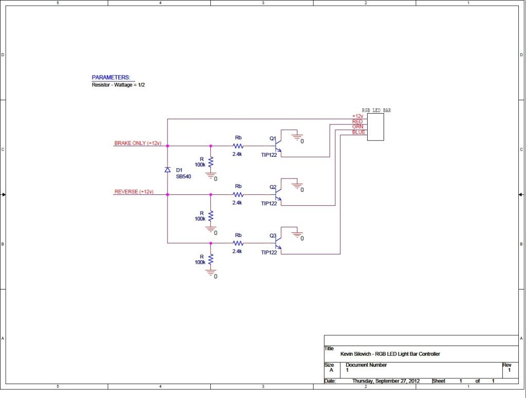

Bored at between class today. So I was thinking of a creative way to incorporate my reverse lights into my bumper. If you noticed that slit in the middle of it. Its there for a reason. I plan to but a 20" RGB LED bar in there.
So my goal is to have it so that when the brake is pressed it lights up red. and when the in reverse it will light up white.
The only issue is that these LED bars are common anode and I really need a common cathode configuration. For those that care. A common anode is where the led's share a +12 connection and an common cathode is when there share a ground.
So in order to get what I need I drew up a quick circuit. I should be getting the parts in a couple weeks.
