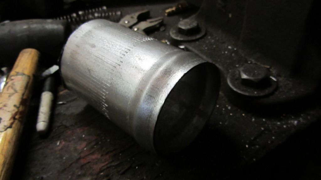

Working on the inter cooler tubing today. And I made my self a use full tool. And the best part is that it only costed $10 bucks
Load in Vice
Insert tube
Tighten vice and rotate and you get this
It can accept any size washer and exhaust clamp so it will do almost any size tubing.

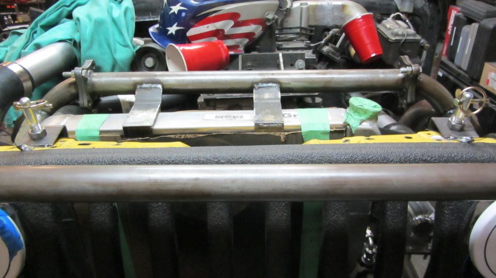

Intercooler tubing coming along.
Had to flip the intercooler to fit the tubing better. Now just to remount it and then bead all the ends of the tube.

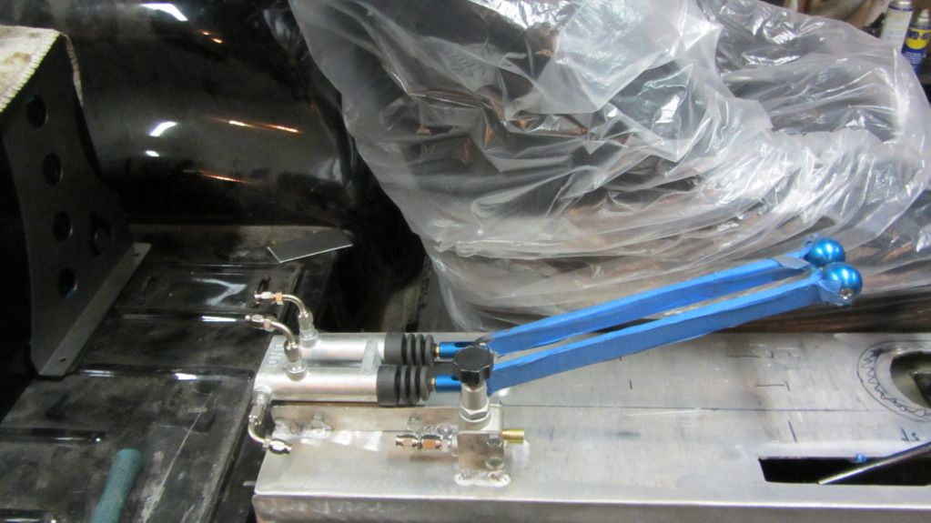

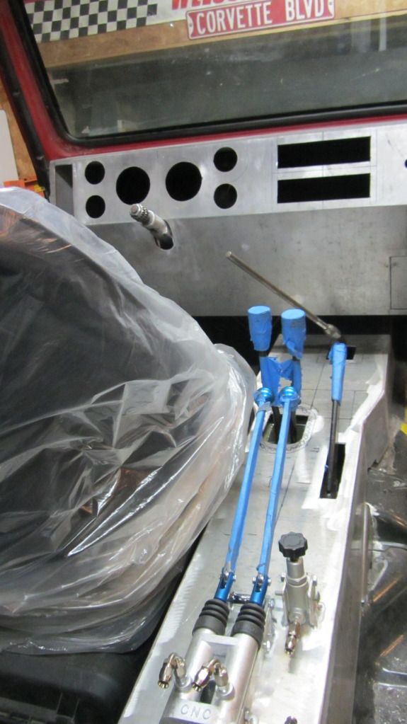

Got my cutting brake and Brake Proportioning Valve mounted

Hey on your intercooler pipe and the flange once in the vise did you use a pipe wrench and turn the pipe ?
Is this flange end necessary on non intercooled such as mine?
Great idea
Mine wont be running till end of Nov. Or at least that is what I am hoping for. Once I finish the cage - end of September. I will tear down, paint and powered coat. Then final assembly.
And what you do is clamp down on the vice then you release the vise, rotate the pipe a little, then re clamp. And repeat till you get all the way around. That is why I have those springs in there. That way when you un screw the vice it will spring open so you can rotate the pipe a little.
I got my idea form this.
I just wanted to make something that would be easier and faster to work with. Thats when I came up with the tool I did.
I would recommend it with any turbo set up. When you are running that kinda of boost it is easier to blow a pipe off when there is nothing for the clamp to grab. At least do it on the outlet pipes from the turbo to the intake.
To bad your not around the area, I would let you barrow it.

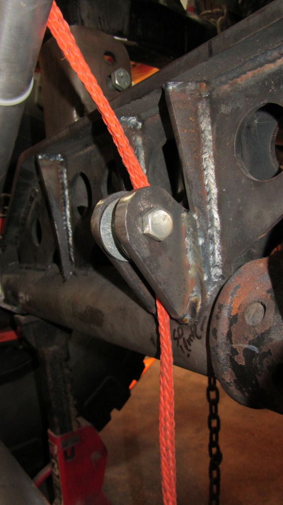

After that I worked on the front suck down winch.
Just need to make the axle tie down point for the rope.

Went back out tonight and finished the front suckdown winch.
