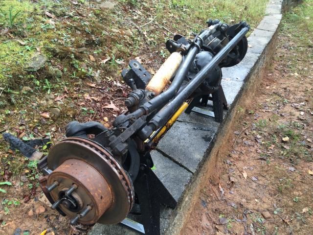

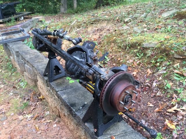

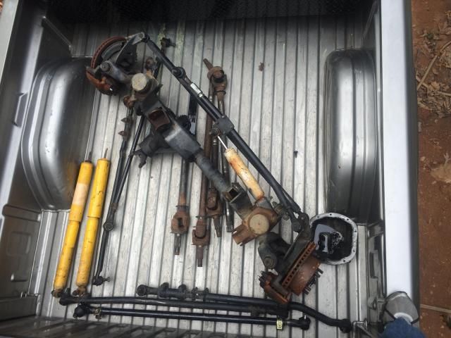

So I picked up an axle and some spare parts I found on craigslist this past Saturday. It's a low Pinion Dana 30 out of an LJ. Unfortunately the housing is bent, but it has 4.88 gears, A Spartan locker, Chromoly axle shafts, Currie correctlync steering, with a new tie rod for it, along with the original currie tie rod for a spare, ORO steering kit with tie rid and drag link, and finally two pair of factory axle shafts for spares. I think I'm going to add the Spartan and the chromoly shafts and the currie steering to mine. I will probably end up selling the 4.88 gears since I want to build a high pinion. I'm torn between running the Currie kit or this ORO kit. I think I'm going to run the Currie kit and see how I like it and go from there. I do like how the ORO kit has a solid tie rod from knuckle to knuckle, and the drag link goes from pitman arm to knuckle but this makes the track bar/drag link out of parallel so I could see the possibility of bump steer there but I doubt it would be very noticeable.
