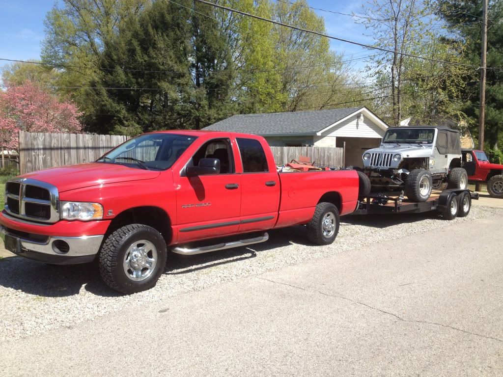

Headed north

A new Dodge truck or the thing got a hell of a facelift

I actually inherited the red dodge along with a 20' deck over goose and some tools from my uncle who passed away a month ago. I had tried to buy that dodge from him for the past 5 years and he wouldn't sell it. 04 2500 lb QC 4x4
Plans for it eventually are 315/70r17 tires on my h2s, 5" exhaust, tuner, and really toying with the idea of a free spin front hub kit. From what I've heard it's about 1-2 mpg increase on free spin kit. Would take several years to pay for it, but we'll see.
Dually dodge needs brakes badly. Once the brakes work again it's getting sold.
