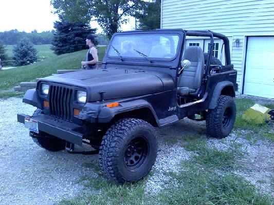

I traded my 97 Honda Civic even up for the 94 YJ pictured below. My parents named it the "Black Sheep Jeep". I daily drove it, lifted it, wheeled it, and generally abused it. She was a learning experience I won't forget. She was sold to a local friend who still has her as a project.
When I got her:
When I sold her:

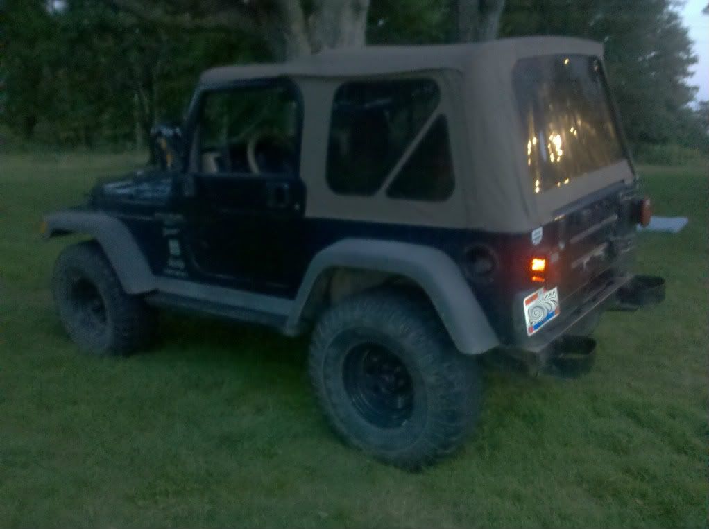

Somewhere along the line, the Jeep had been endowed with a factory hitch. It was held on by two weak bolts and I decided that it sat too low anyway so it got sold for the Jeep fund. It also came with a spare set of D-window wagon wheels. They were 15's and actually pretty nice but I got sick of the wagon wheels on the YJ....so they got sold too, money diverted to the Jeep fund.

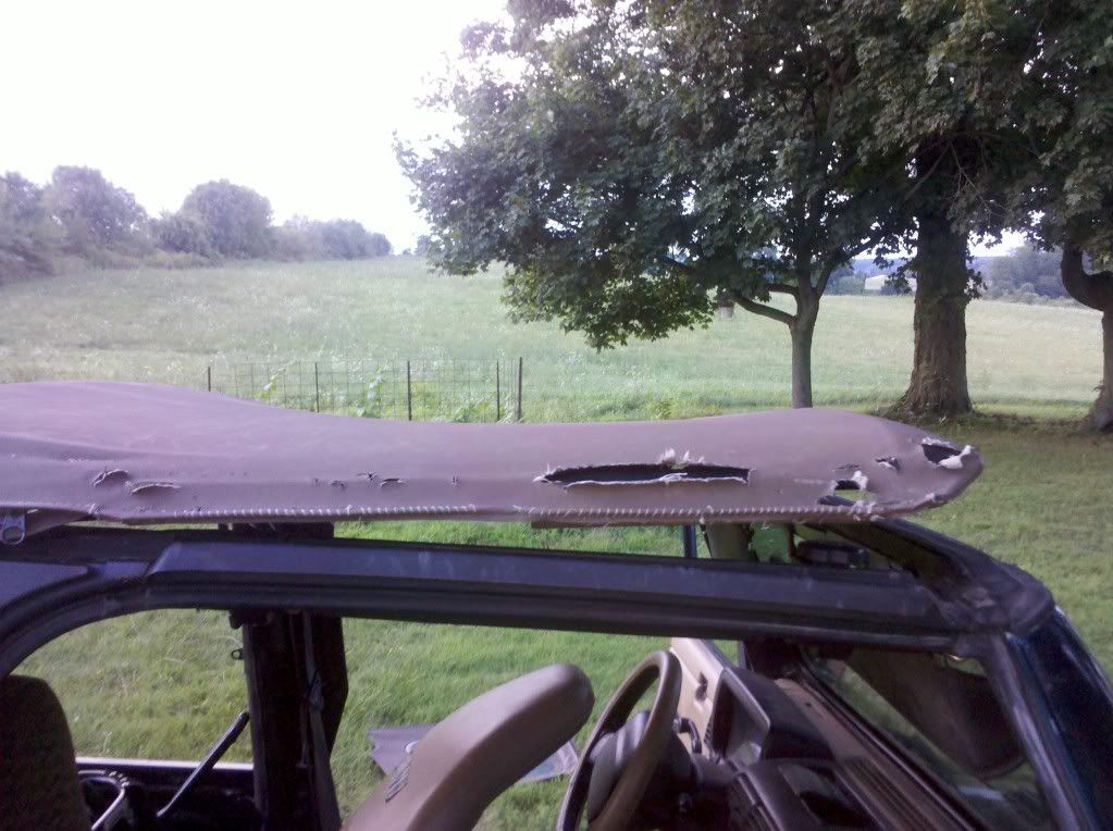

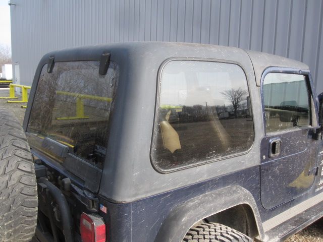

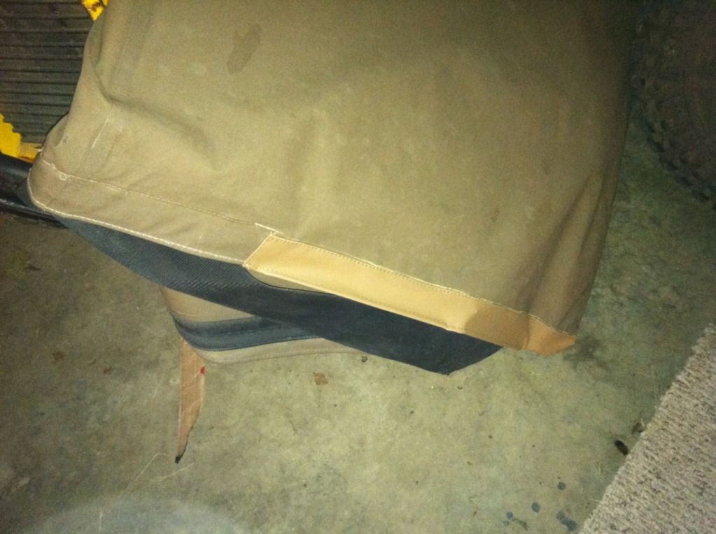

The top that came with the Jeep was original. I kept it on there for many months and it only leaked a little bit. Really, it was pretty impressive as it had some issues. I decided that it was time to hook the Jeep up with a nice top. The dark tan had grown on me so I looked for that as my #1 choice. Tops were so expensive that I knew it would be difficult to fit into my budget at the time, so I also considered black tops too. Eventually, I ran across a CL ad for a factory TJ top...at $75! I jumped on it and was really amazed. The top was perfect. The guy selling it had a TJ that his daughter wrecked with the hard top on. The soft top had stayed in their garage for quite a few years and he finally decided to pass it on and give someone a heck of a deal. Came with all perfect tinted windows, original packaging, frame, hardware, and boot.
Old:
New:
The old top was repaired and sold with hardware. Money was diverted to the Jeep fund.

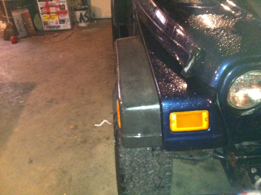

Decided I hated the wide flares. Deleted them and traded another Jeeper for his stock flares. I had some time the evening I took them off so I disconnected the swaybar and flexed the Jeep out on the rock pile I dumped in my driveway. It has become my favorite parking spot and has really helped me understand, troubleshoot, and enjoy the suspension on my Jeep.
Wide Flares:
Deleted, disco'd and flexed:
Now with painted stock flares:

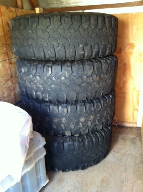

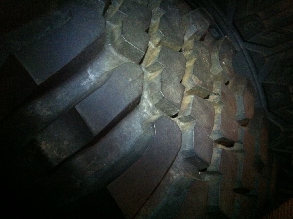

At some point in there, the original Bighorn 35's were pulled because of tread depth issues. I sourced a set of 33x12.50x15 BFG AT's and slapped them on. The 35's were sold to a guy with a huge roller project and the proceeds went to the Jeep fund.

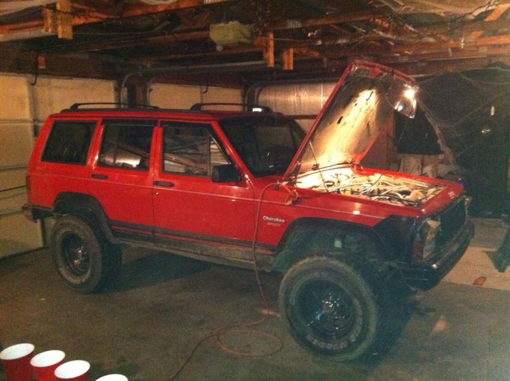

Spent a bunch of time working on a friend's Cherokee:
And another friend's Cherokee:
And another friend's Cherokee...then sold it for her:

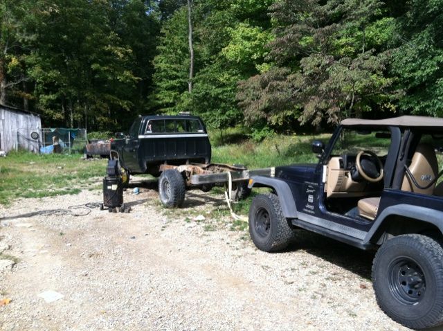

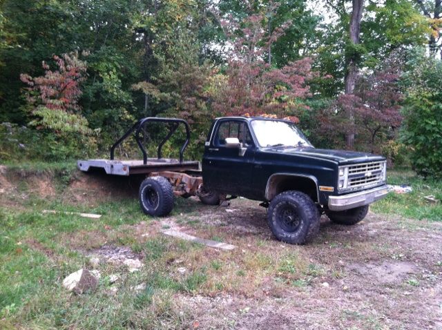

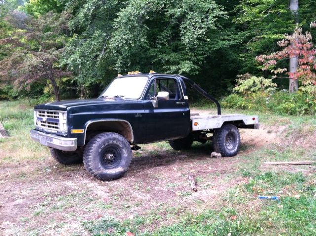

Worked on this truck too...it got interesting to say the least:

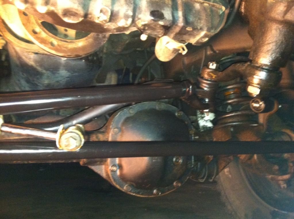

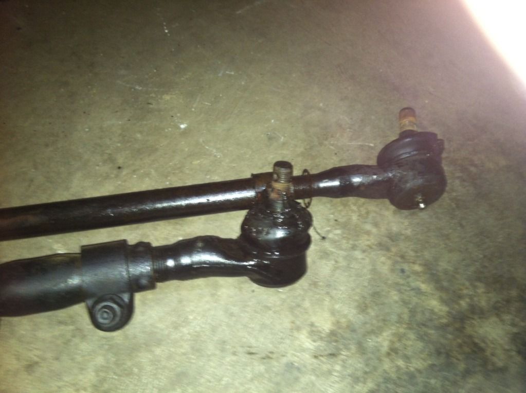

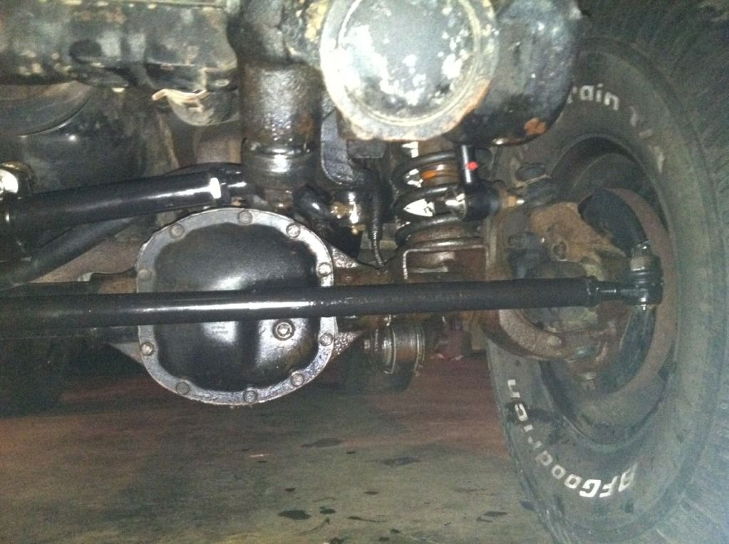

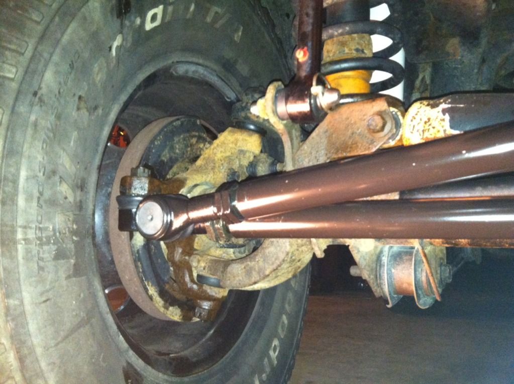

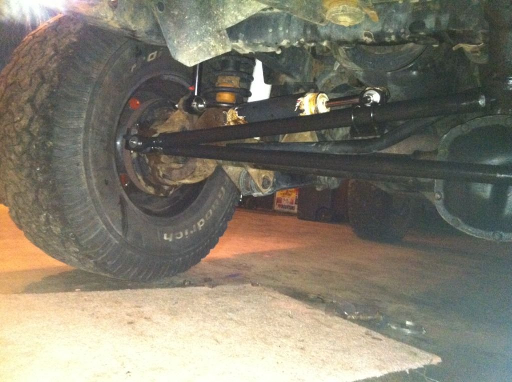

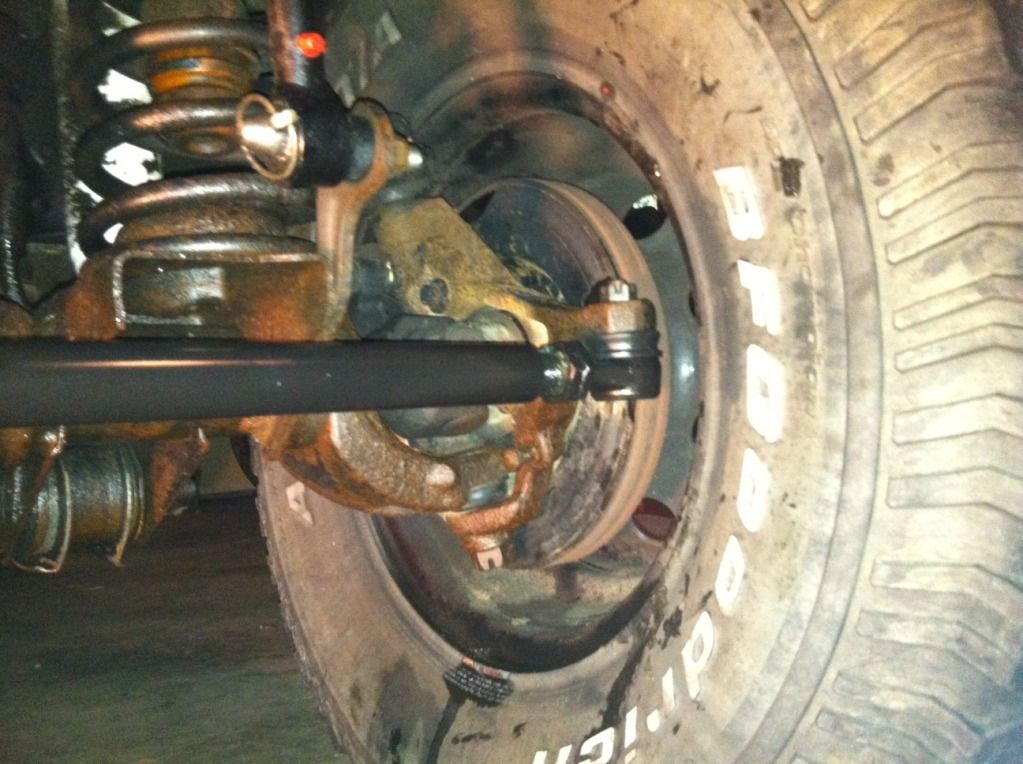

I had some cash laying around and was looking at the worn BFG's on my Jeep with some serious lack of trust. Spent some time on Craigslist and ran across a fellow selling a set of 33x12.50x15 Kumho Road Venture MT's for $400. I figured the price was too good to pass up even though I wanted 35's, so I emailed him. He told me later that I was not the first person to email him on them...just the only person that used complete sentences. He decided that I needed to be who he sold them to. So I drove down and bought them for $400 cash. They came off of an International Scout II that he had bought out of a field up near Cleveland. The tires that were on the Scout were totally shot and he planned to drive the truck back to Columbus. So he stopped by the local tire store and bought these, which are now discontinued and drove the 100 mi. or so South to his house. He started pulling the project apart and found major rust issues that he had not noticed before and decided that the tires would rot to waste before he got the project finished, hence the sale. I got lucky.
At some point I became painfully aware of the fact that my Jeep was wandering all over the road. The dead space in the center of the steering was a void big enough to be classified as a black hole. Therefore I decided that it was time to do some upgrades. I got online and ordered up the Rugged Ridge HD Crossover steering kit.
Lord Beefington the HD:
Pulled the old crap:
Bolted up the new:
I did a garage tape measure alignment and doublechecked torque on everything. Test drive was successful. Steering cycled perfectly with no clearance issues. Flexed disco'd on the rock pile and determined that it all would work perfectly with articulation. Loaded up the tires and headed into town for an alignment, mount, and balance...that's when stuff got really interesting.
Had to drive the roomate to work, so I got creative:

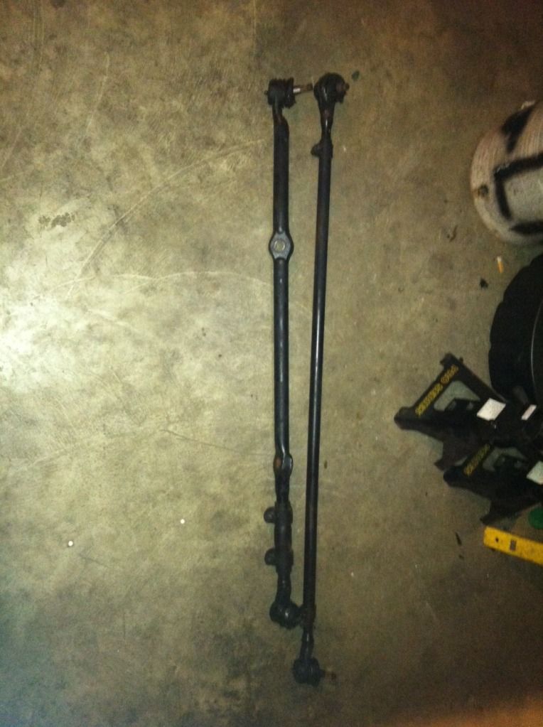

Did the alignment first, but never made it much beyond that. The steering gear box that had been leaking subtly for a while decided to spill it's pitiful life fluid all over the shop floor as the mechanic set up the alignment rack. I got a call, I bellowed a curse, then I picked up the Jeep and limped it home. Spent the next week soaking the bolts in PB Blaster and looking for a Durango box. Found one a few miles north at a junkyard. It was out of a 99 4x4 V8 with no plow and 60k miles. Paid like $75 or something for it. Brought it home and struggled for countless hours trying to get it installed. Had a very hard time with the pitman arms on both even after days of soaking in PB Blaster and WD-40. Ended up trading a single shot shotgun to my mechanic friend to swap them out for me. Had the Jeep back up and running and got rid of a pointless gun I less-than-liked. All told, the Jeep sat around for a couple weeks and I rode the Nighthawk to get around.
Eventually, the death wobble reared its pug-fugly head and I had to get drastic. I had an adjustable front trac bar laying around so I installed that. The old trac bar was totally shot on both ends, so I'm inclined to say it was an easy fix. Had the trac bar I put in laying around with a pile of parts I had picked up. Jeep drives perfectly up the road, no hands on the wheel, no pull, no dead space. Just tightness.

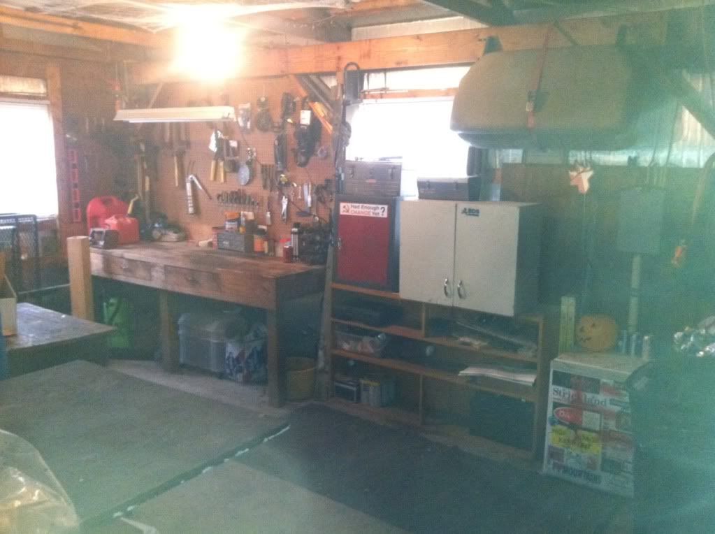

Then one day I got into one of those super duper OCD modes I swing into from time to time and cleaned the holy hell out of my garage and reorganized my workbench area (note the all-important beer fridge to the lower right):

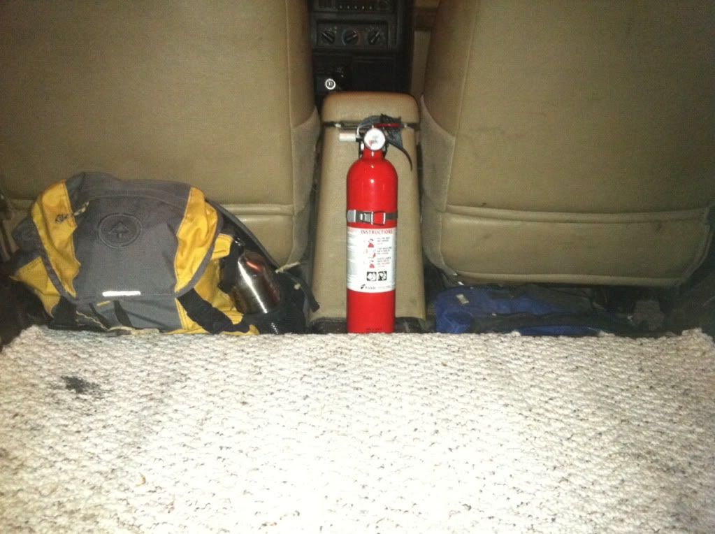

Cleaned and organized the rear area of the Jeep, tools and recovery on the left, straps on the right, fire extinguisher mounted. I had bedlined the rear cargo area with the spray-on stuff a while ago. It held up awesome. Still looks perfect. Cut out a section of some carpet I had laying around and laid it in there for noise dampening and in anticipation of an eventual dog.
Yup:

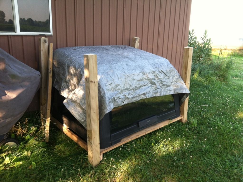

2 pc. Steel Horse Hard top for $200, built a little rack for storage outside:

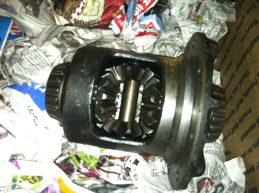

Factory LSD for the D44 rear:

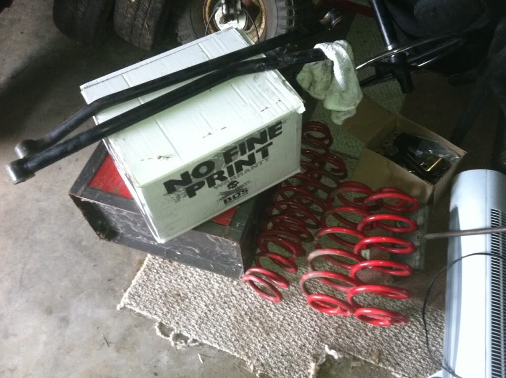

Rancho 3.5" Suspension lift, used, no sag, all hardware/TC drop, fixed lower CA's, extended rear trac bar, adjustable front trac bar:

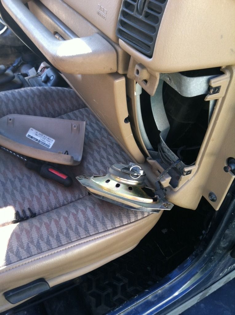

More recently, I traded work for a set of rollbar/wheelwell speaker wedges. They have crappy Pioneers in them and some cheap tweeters. In the end, the goal was to get a little more sound out of the stock radio until I set aside enough money to upgrade the entire setup. I'm not sure that I like the wedges but they work. Decided to wire them in with the front speakers given the generally crappy sound coming out of them. When I pulled everything apart, I found the following:
I contacted Matt, the previous owner. He says he has no idea. Not his key. He never had that apart but he did know that the Jeep was originally owned by someone down in West Virginia. Seems whoever that was has been missing a key for quite a while now. If you're reading this, recognize this Jeep, this key, or whatever, PM me and I'll get it sorted out with you.

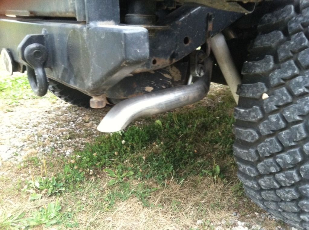

The exhaust finally took a massive crap. I could hear stuff jangling around in there and it sounded like trolls playing the steel girders of a bridge with large rocks. I went to my favorite muffler shop and had them install a Flowmaster copy muffler and custom bent pipe. I've used this same type of muffler before on a couple different vehicles. Really impressed with how long they last and even more impressed with the sound. The old tailpipe hung low and at a strange angle (can be seen in previously posted pics). Out with the old in with the new.
Inexpensive and a win:

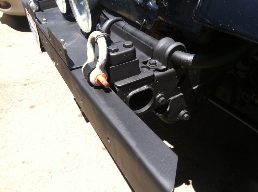

I need to pick up some Ground Pounder Fab bumper tie-in brackets from Eddie, a pair of Brown Dog MML/mounts, a UCF lopro tranny mount, and a Novak shifter cable. The last two things are in anticipation of installing the 3.5" Rancho lift I have collecting dust. The idea here is to maintain the stock skid without a drop and without a SYE. This is because I get hung up enough on my stock shovel, lowering it does not help me at all. On the other hand, it will take me a while to save up enough for the SYE/DS/Flat skid. It should get me by until then.
