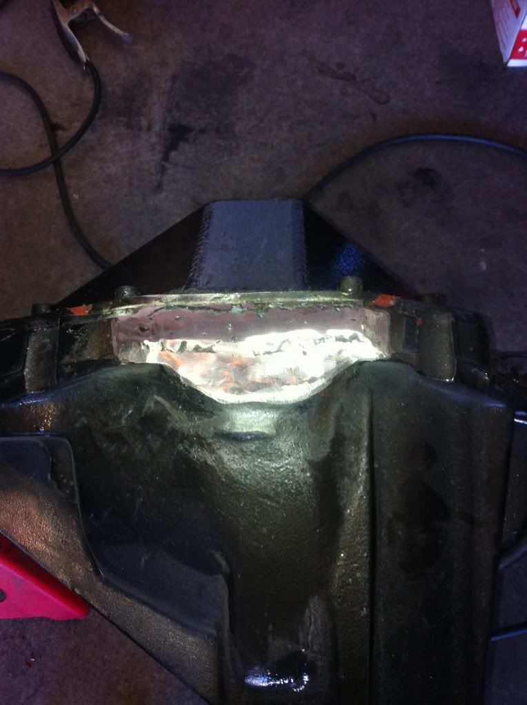

I built up about 1/8" with weld and ground it down.
So, when's this thing going in?

If the 1/8" plate was welded around the circumference of the cut except for at the bolt surface where it would extend past the surface and preferably follow the angle of the diff cover for about a 1/4" and cut slits for more welds, would that damage to housing if it was ripped off?
You can see that there is about 2mm of the housing below the diff cover.
Or, just add a bunch of weld and grind smooth.
Get you some hard facing rods, run a few stringer beads that will last you awhile.
Thanks for the idea.
