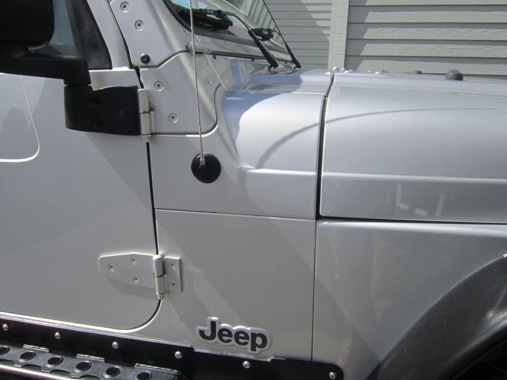

While I was in Moab a buddy told me I should remove the "Sport" decal from the Jeep since the model badge didn't mean much anymore. He had a point.

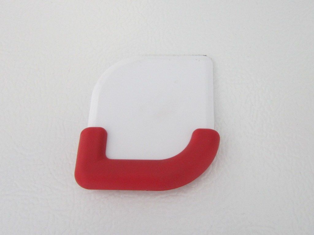

I used a head gun set to 600 degrees and hit each letter for a few seconds. Then I used my wifed pan scraper to scrape off the letters. They came off easily.
I used Goo Gone to remove the remaining adhesive.
New clean look.

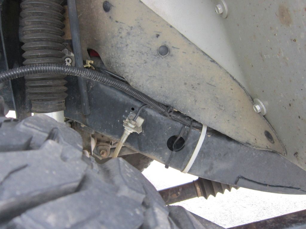

Securing the OX Cable

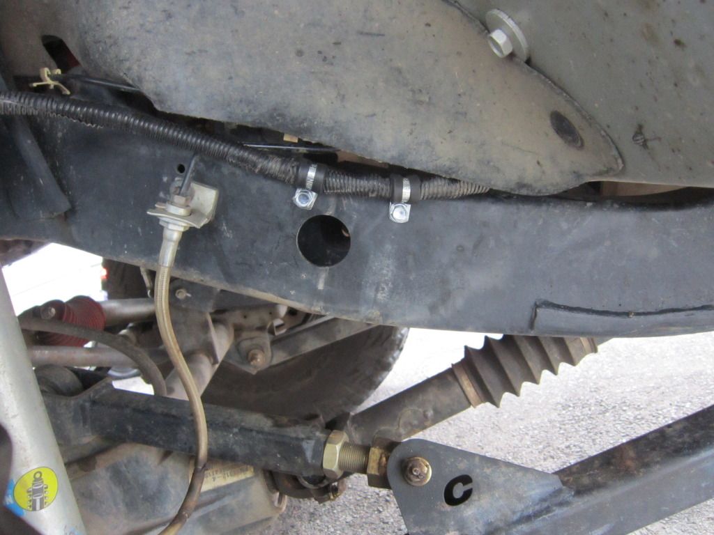

Since the OX locker was installed I have used tie wrap to hold the cable to the frame. I have used several renditions of tie wrap. Once I had it secured to the shock tube, I used double loops, single strands of heavy wrap securing it to the frame...they all have the same problem...it's plastic and it snaps over time. It does not hold up to the elements.
Today I secured the cable to the frame with some clamps I got from NAPA. The clamps were in the electrical isle, but I have used them for a number of different things.
The end product.
Hopefully this is the last time I have to worry about this cable.

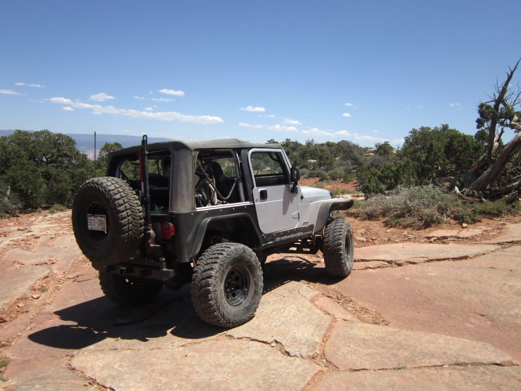

Some poser shots from my May trip to Moab, UT
