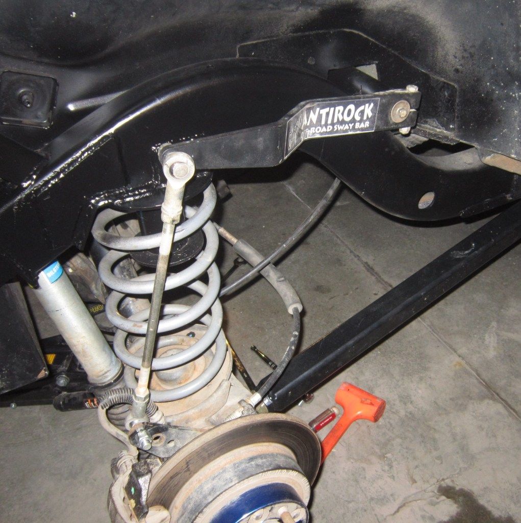

Yesterday I worked on some clean up items. I fixed up some electrical issues, brake lines, etc... I think I have my rear AntiRock dialed in. It is pretty tight back there, but I put the arms above the tire. The upper heim is on the outside and the lower heim is on the inside.
As the tire drops, so will the arm at the same rate right? It shouldn't touch?
We will see.

Setup looks nice man. Just wondering why you didn't locate the lower heim bracket in front of the axle instead of behind?

The AntiRock started as a TJ bolt on kit. The bolt on brackets for the torsion bar mounted on the frame near the rear crossmember with the torsion bar passing between the tub and frame over the gas tank. The arms faced the front of the Jeep.
I couldn't keep it in the same spot. The fuel filler tube and breather tube on the GenRight tank were in the way of where the of the torsion bar needed to be. I recently read an article in JP Magazine where they used both the GenRight tank and the TJ bolt on kit (in its intended location) and made it work. Of course there was no picture though.
Back when I originally installed it I did the frame side and had a local 4x4 shop weld on the bracket. That is where they located it.
As I figure out what to do about axle assembly's down the road I will keep in mind moving that bracket to the front of the axle.
