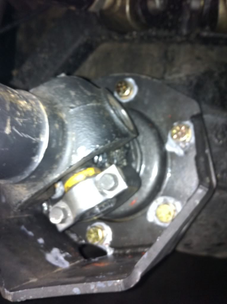

Help my understand he slow gear oil weep I am having from the pinion retainer ring bolts. The majority of the weep is coming through the bolt threads and causing a small, really small drip, to collect on the pinion guard. There is a very small amount of oil showing up on the housing between the center chunk, the shim, and the pinion retainer. Is this due to too much gear oil. There is 4 quarts in there now.
On the all knowing web I found info from 2.8 qts to as much as more than 5 qts is the CUCV manuals. I went with 4 on this fill. It is about 1/2 inch below the fill plug.
I drive this beast to the trail. It is not a commuter, but she does see highway use a couple of days a week.
So the pinion guard comes with 1.5 long 7/16x14 bolts. I swapped in some 2" bolts and doubled up the lock washers and they didn't bottom out. I slathered on some oil resistant RTV as well.
In past observations I re-torqued the bolts to the 65 lbs in the CUCV manual. They seem to backing off of that. With the previous 1.5" bolt and lock washer and the 2" bolt and dual lock washer.
Why is the torque loosening?
The other day I re-set the pinion angle. After everything had a chance to settle. Right now the pinion and the drive shaft are both at 19 degrees based on an analogue dial. I don't feel any driveline vibes (which I am used to feeling in the previous phases of the build so I THINK I can recognize them).
Is it a bad pinion angle causing the bolts to work loose? I can't find anything on Google about the pinion guard, and or pinion retainer bolts coming loose.

With the pinion guard on and its welded it may not be flat after it got welded, the pinion guard.
So if its dished ( the guard ) where the bolts are suppose to touch flat the torque may not be enough to flatten the guard out and keep proper torque on the pinion.
Hence the leak and the backing off of the pinion bolts.
Your torqueing specs are correct, 65LBs, but you changed the idea behind the spec, the guard. GM never thought of a round dish attached to the pinion, which if it were flat it wouldn't matter, but I bet it wrapped from welding and its dished.
So a over torque on those bolts is what's needed or studs to over compensate for the guard being dished.
You could try removing the guard and see If the torque specs hold and the leak go's away.
If it still leaks a shim might be pinched causing a small drip. I ran mine for 8 years and would check those bolts often and trust me they loosing up.
We are asking these axle's to thing they were not designed to do, they can take it that's not the question, but we are way out the specs of what they were intended to do.
So more maintance is needed to preserve them outside there intended use.

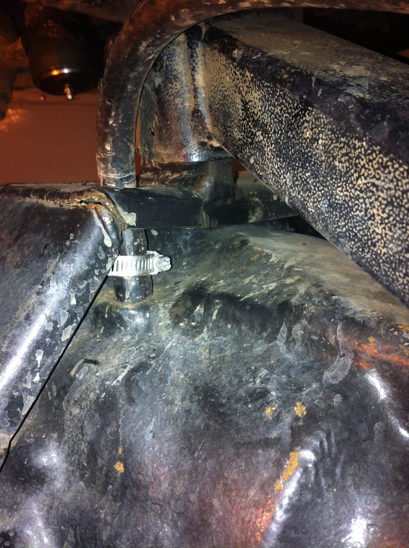

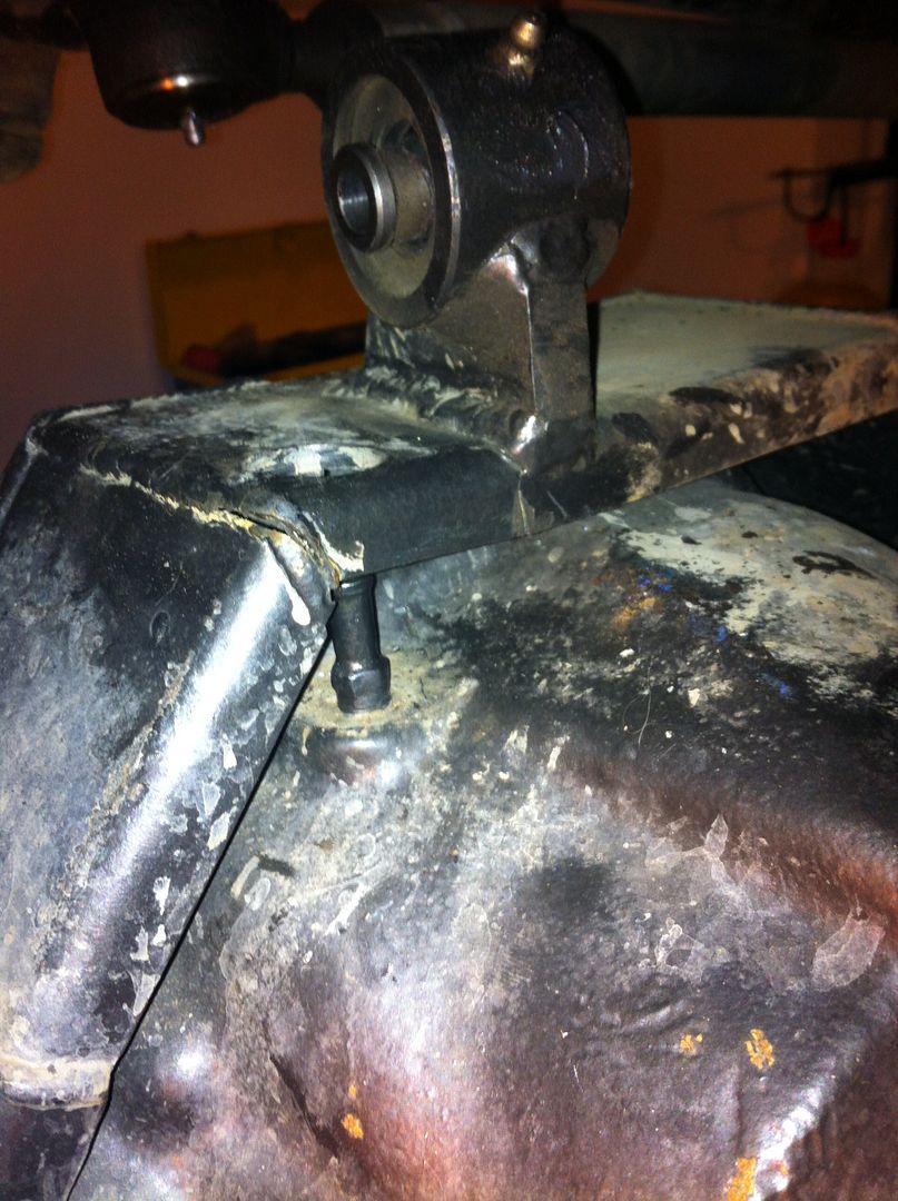

I haven't had a chance to re-torque the pinion guard as a clunk developed on the front end and a hub issue developed after this weekend.
On the way out of Holy Cross I noticed a clunk coming from the front end while driving the long dirt road out. I stopped several times and pushed and pulled on parts and couldn't find the problem. I chalked it up to a new and relatively un driven new rig. I figured there may be new some new sounds that the old rig didn't make. The sound continued this last weekend.
So I did some further inspection tonight. I checked every bolt and every weld on the front end. I discovered that the exhaust was loose and the bolts near the two cats below the manifold. I could shake it easily. Tightened those up and couldn't move it anymore.
Then I found a larger problem. A cracked weld on the bridge over the pumpkin and a crack in the plate.
This bridge was built out of 3/16" rect tube. The the radius arm comes over the top and meets its mount on the bridge. The main purpose of the bridge was to weld steel t steel instead of welding to cast. However the bridge crosses the pumpkin and ties into steel plate on the other side. That radius arm has Johnny Joints at both ends.
Radius arms and binding! Even with Johnny Joints at the both ends of the radius arm, the weld went. Chicken or the egg... I don't know if the weld where the bridge bends went first causing the plate to crack by the radius arm mount, or other way around.
I should be able to reach the crack with the stick welder I have at my house. Hopefully I will get home early enough tomorrow to clean up the area and throw down a new bead and patch the crack. I am not sure can hit the crack with a grinder, but it would be nice to burn on another layer of some welding steel there.
I hope this doesn't become a problem that will cause me to pull that front axle and build a new bridge/truss
