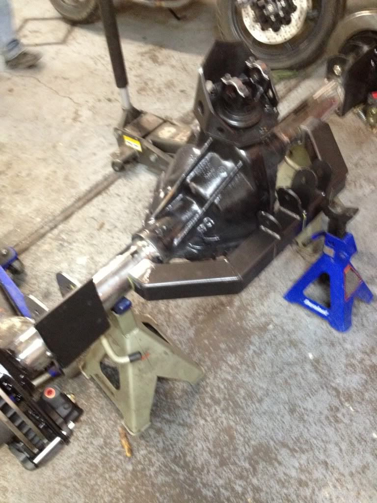

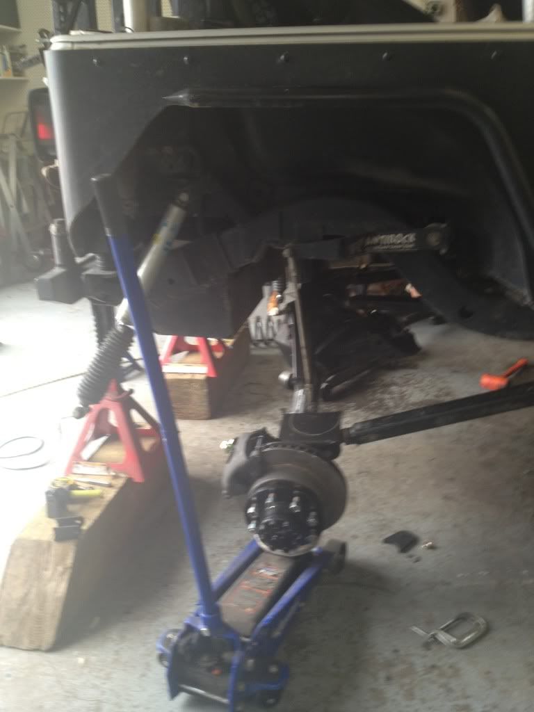

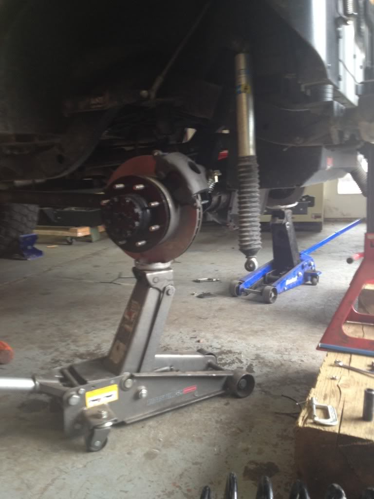

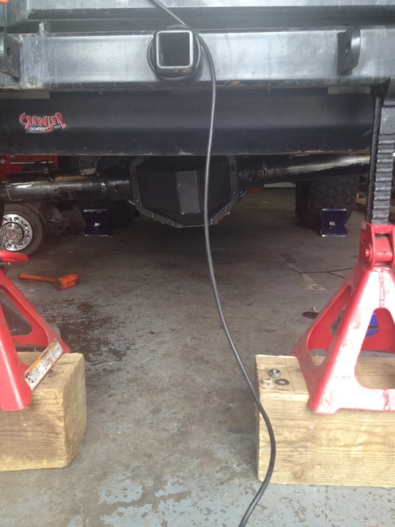

I got the 14 Bolt slung under the Jeep today. I still have a 101" wheel base. I have more room between the diff cover and the tank. I had to pull about an inch out of the slip in the drive shaft. I gotta call Tom Woods and see if it needs to be lengthended or if it is fine.
Testing fit at full compression without springs and such. Making sure I am not hitting the tank.
I was always puzzled as to why the pumpkin on the 60 never appeared centered in the notch on the GenRight tank. I knew the axle was centered and the tank can only go where it goes. I couldn't figure it out, but it certainly didn't keep me up at night. Now I know why...GenRight must assume you are using a 14 bolt, not a stinking 60. The 14 bolt fits nicely in the notch in the tank.
Cycled the suspension. No binding or issues observed.

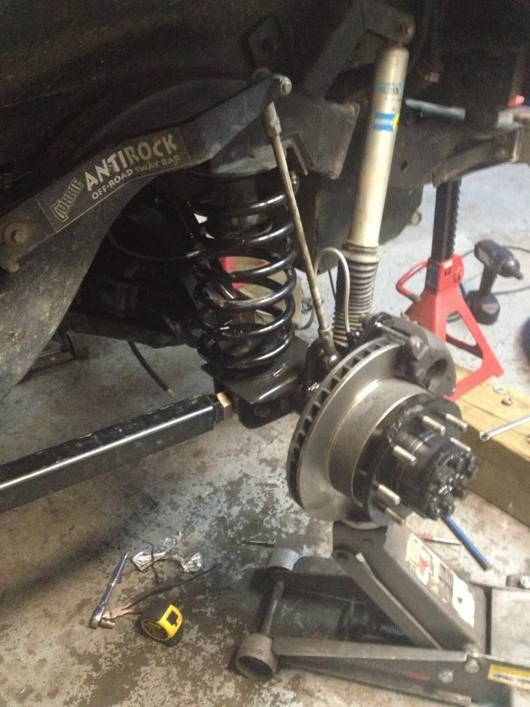

There was plenty of room for the AntiRock, shock perches, etc...The tube length/spindle length of the 14 bolt is different than the 60. Things are a bit crowded on the 14 bolt but all fits well. The brake lines are on, but I may revisit these. I used a 30" and 8" premade line with the soft lines. The drivers side has a huge bow in the soft line but it doesn't rub, at least on anything I could see.
14 bolt

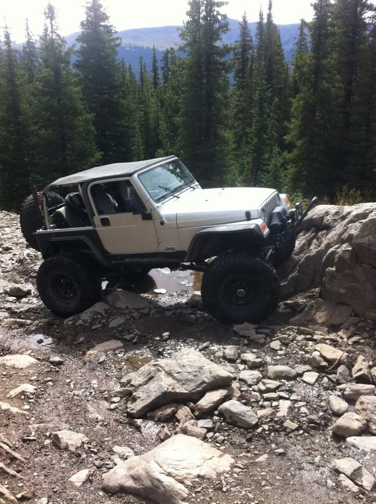

Went out and ran Holy Cross today. Everything worked well.
I walked right up the ledge.
Made it through French Creek
Most everything worked. The P-Brake is still not hooked up and my pumpkin was hot. The diff cover was hot to the touch. Gotta look into that.

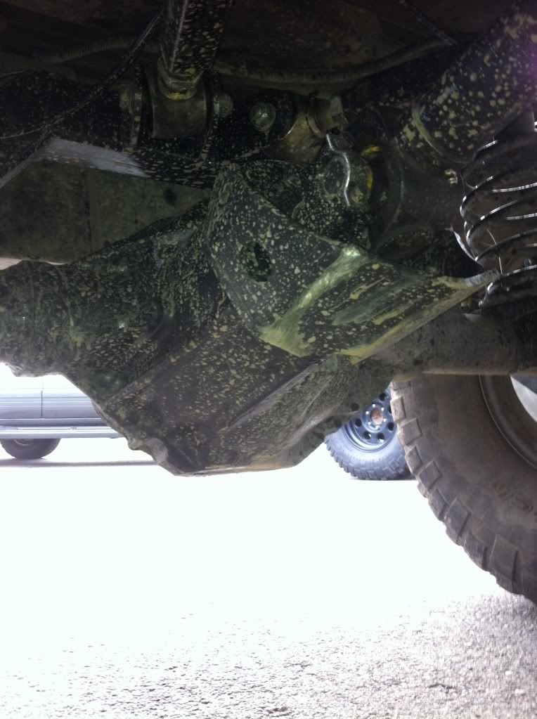

I was not kind to the rig today. I put it bad situations on purpose. It was a "first day out" of sorts. If you ever ask if there is junk you buy because you heard it was needed...the pinion guard proved it's worth.
