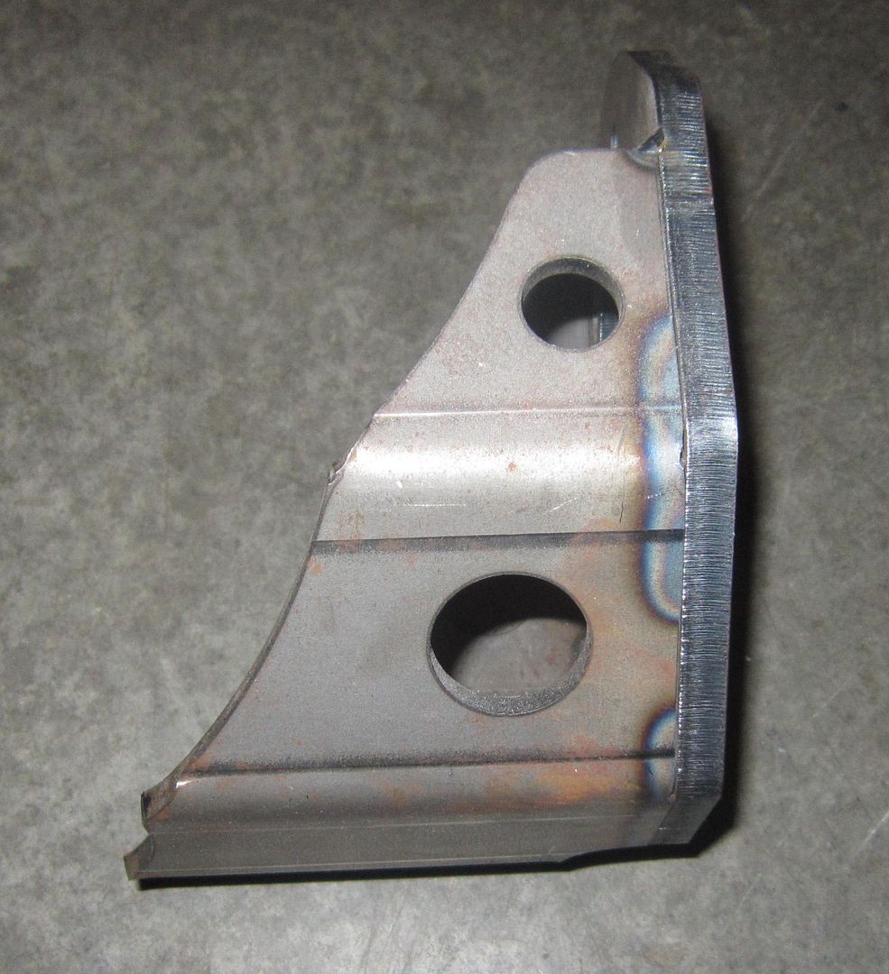

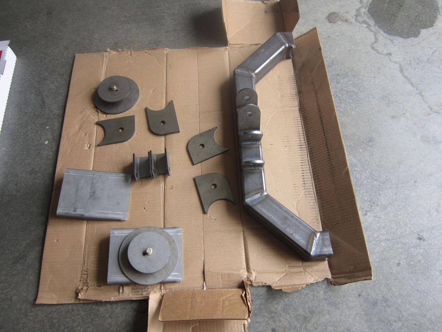

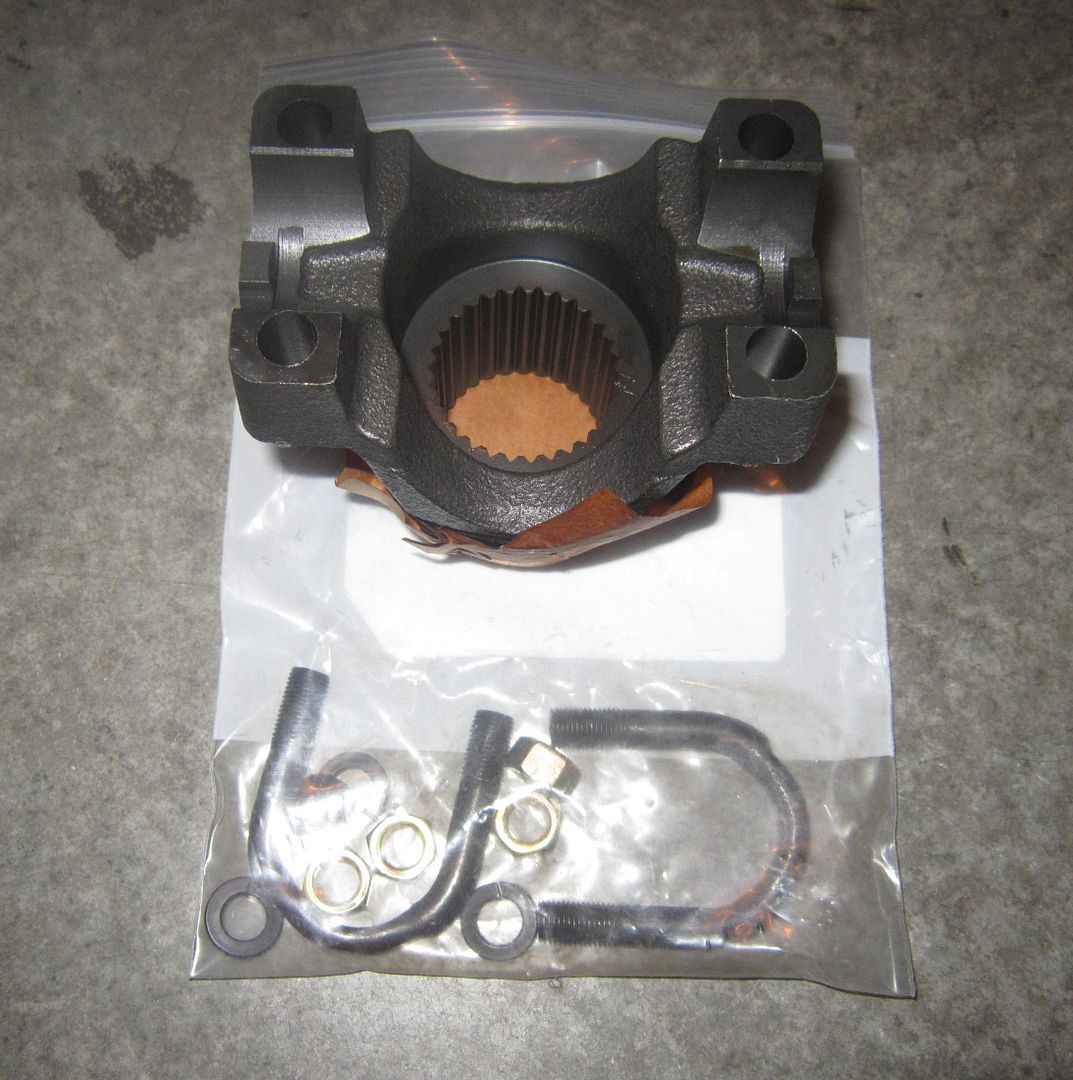

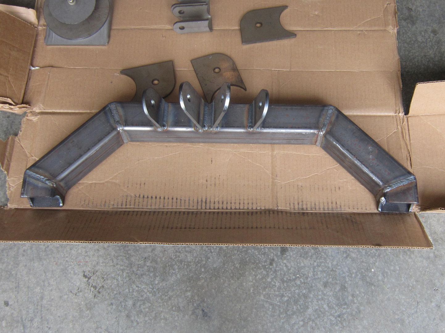

I figured out how to fix the broken hub, get rid of it! Yeah, not the obvious way.
I bought a SRW 14 bolt from Boyce Equipment. I am tired of wrenching on bearings and such and having no idea if what I am doing will make any difference. I know this axle will be true. Completely rebuilt, geared and locked, e-brake calipers and rotors, and tubes free of any old perches and shock tabs. It was far cheaper than their on-line calculator.
Only a few brackets to get and burn them in.
Blue Torch Fabworks pinion guard
Off Road Designs u-bolt style yoke

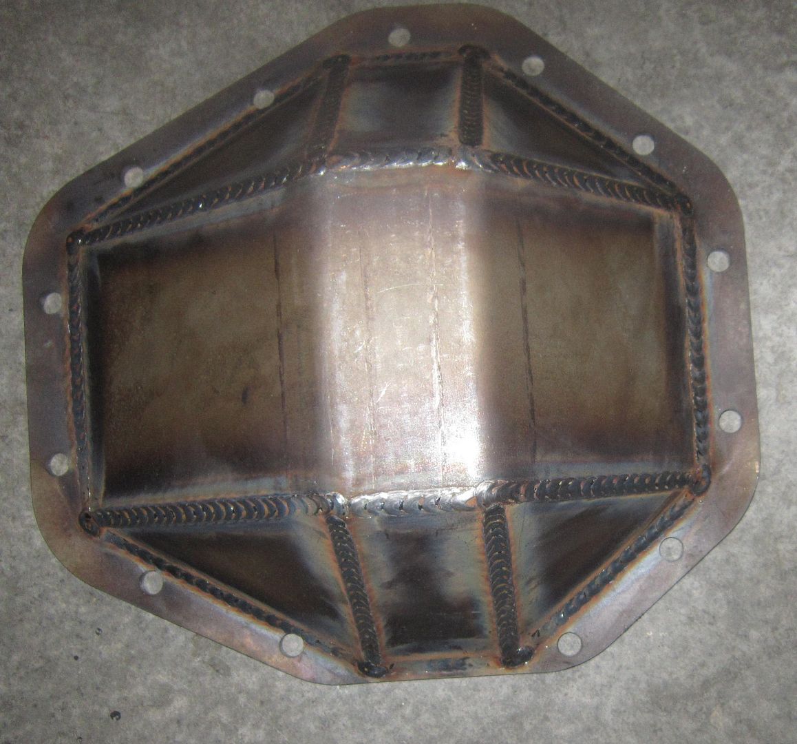

Undercover Fabworks shaved 14 Bolt diff cover
Clayton rear axle brackets
These will all be set up as high clearance just like on the 60. These are parts from a larger kit. I spoke with Adam at Clayton and he was more than happy to work with me on what I needed and not the whole kit. Once again, not but exceptional customer service from Clayton. I also learned that I was one of only about 10 people to ever get a 14 bolt truss from them.
We talked about my rear 60 and the 14 bolt for a bit. It was cool that Adam even cared about the build and where I was going and why. Once again, props to Clayton. As usual, all of Claytons stuff is 1/4" plate.
I don't have the axle in my hands yet, but I expect it soon. I may try and sell the rear 60...or use it as a project. Once the heep is back on its way, maybe I will tackle a spindle swap.

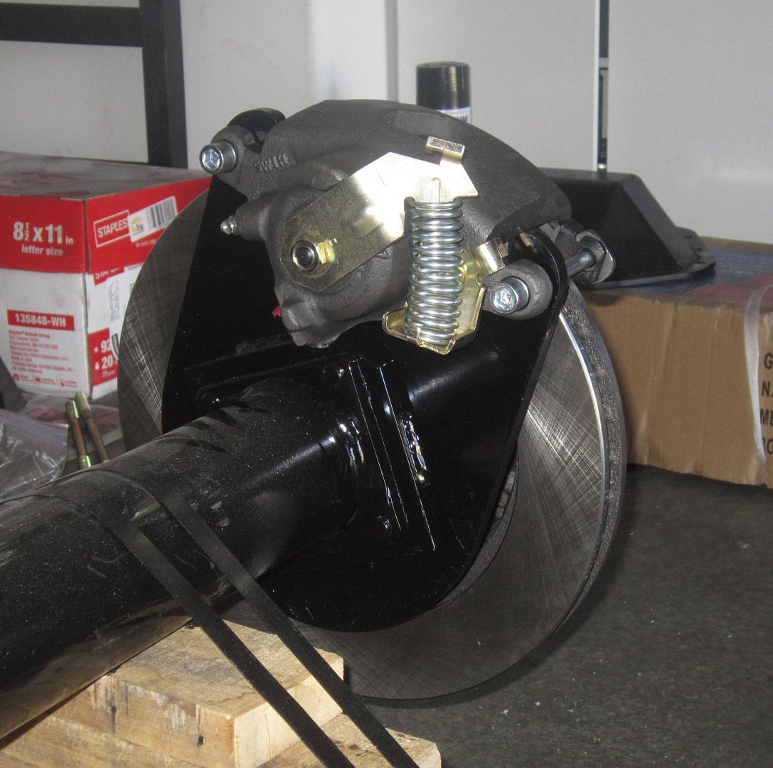

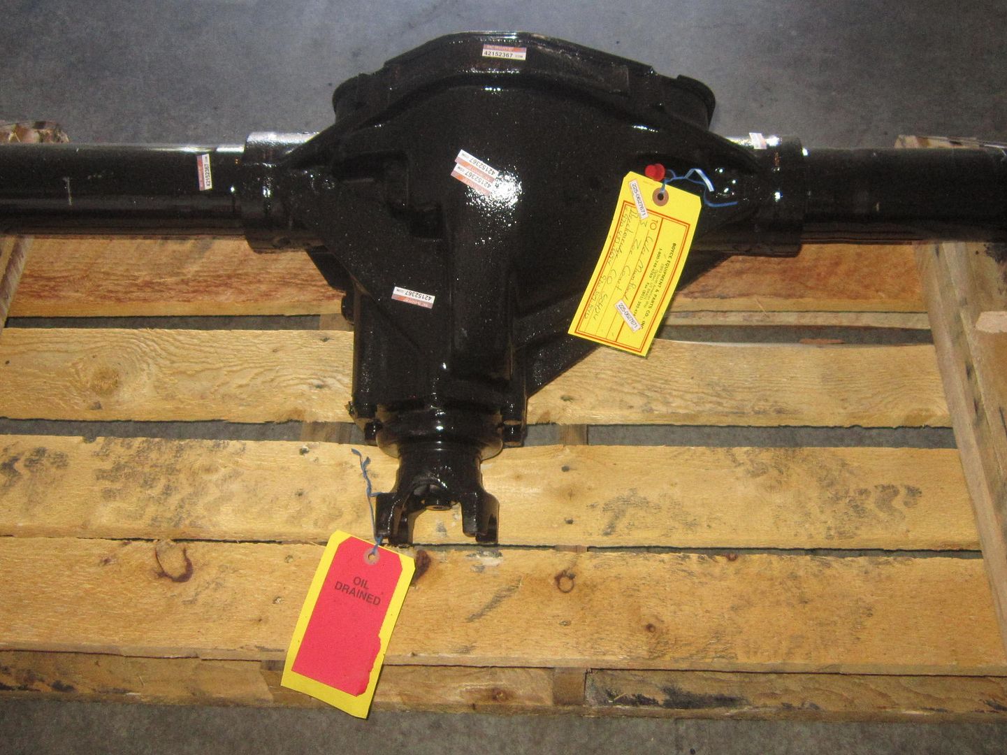

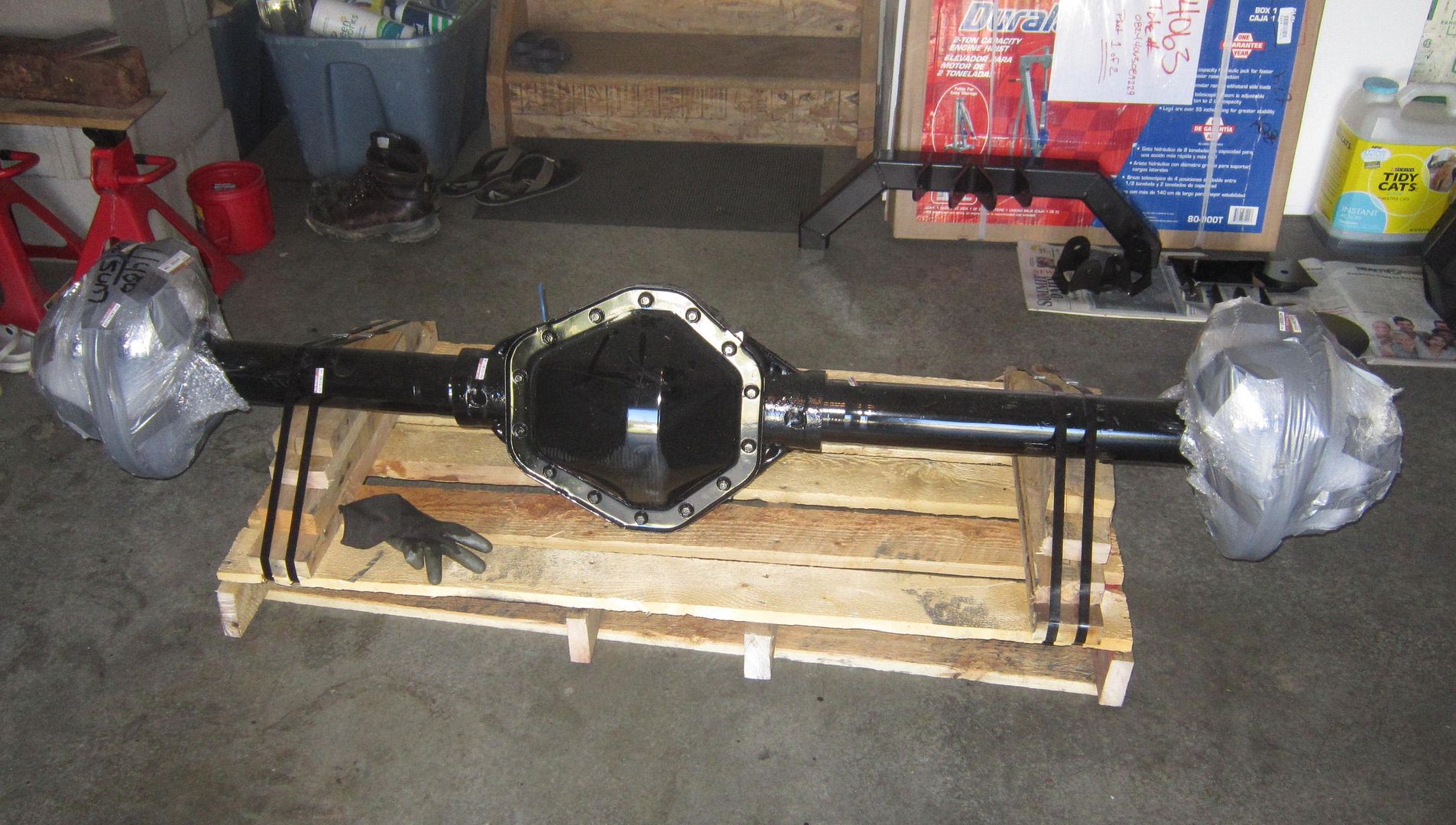

The 14 bolt showed up today! Boyce sent it via RAC Trucking. At my request, they sent it on a truck with a lift gate and a pallet jack. Score. I was not responsible for getting it off of the truck.
It was shipped in high gloss black, The rotors and calipers were packed in bubble wrap and shrink wrap.
When I spoke with Boyce on the phone when I ordered the beast, I was told I would get a build sheet. Part numbers and such. I don't have that in hand at this point. Granted it may be in the mail or something. I will call tomorrow.
Big thing at this point is the calipers. I want to get the right soft lines and hope for an opportunity to start burning in brackets soon.

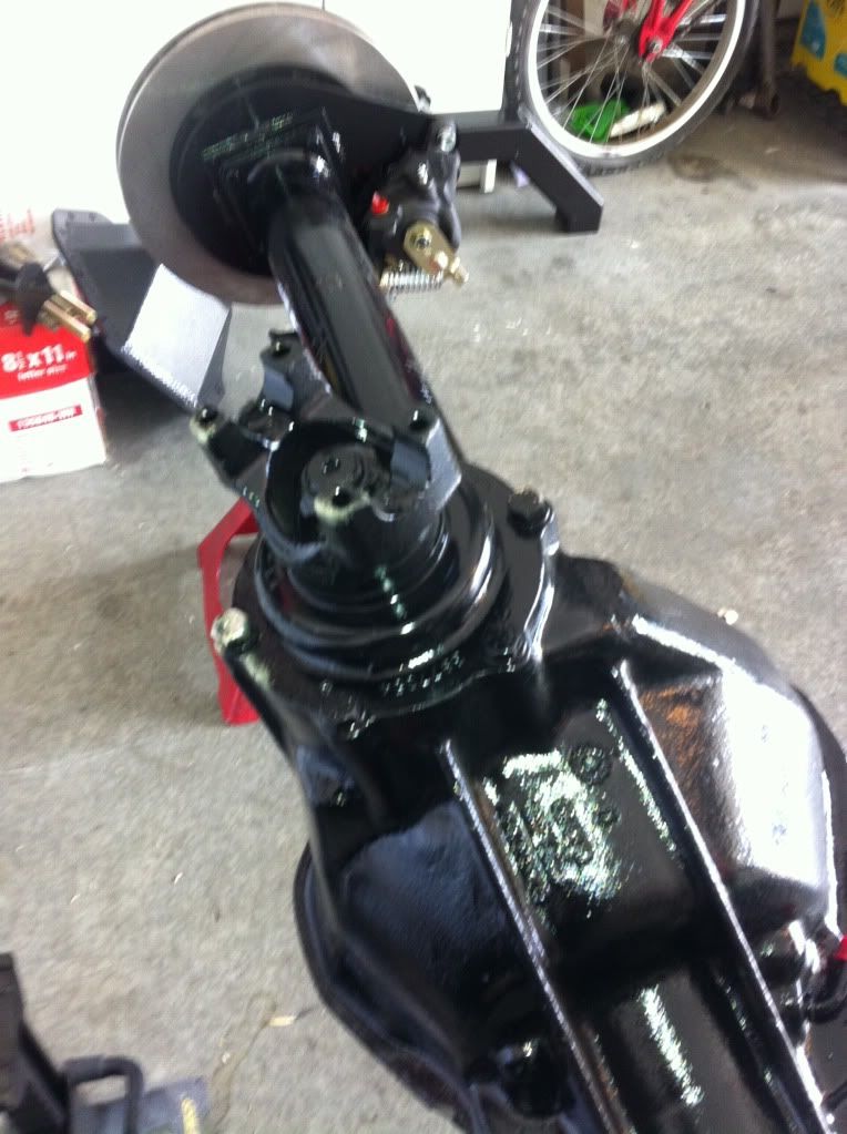

I haven't got much done with the axle. The same OT that has been such a boone is now hindering my ability to do the swap My wife wanted to go wheeling today so I didn't have the wrench time I thought I would. I planned on doing the shave today, and that didn't happen.
We spent a long day in the Golden Horseshoe on the bewildering unmapped trails. I must admit, I thought I'd done nearly every trail in the county, and today I found a number of trails I'd never been on before. That also means....LOST!

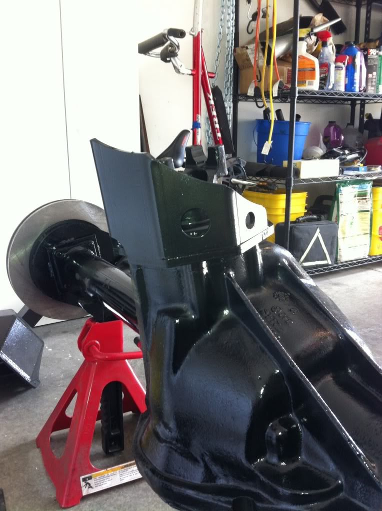

Blue Torch Fab pinion guard. Comes with hardware, but all the hardware on this axle is new, so I just re-used it.

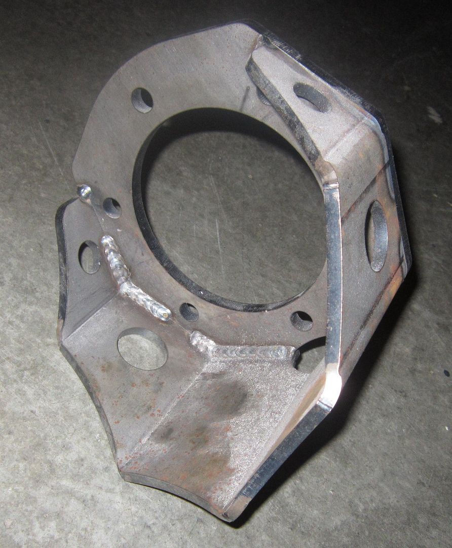

I've ordered some braided stainless steel soft brake lines that should work. I will run a hard line over the truss.
I think the e-brake cable I need is a LJ cable. Seems to be what is being run by those with e-brake caliper, stretch, and 14Bolt. I will hit up NAPA soon. The next two days I might not be able to get there.
Just sitting the brackets on the axle I don't think there will have to be much improv. I want to build the lower coil bucket up to match the height of the one's coming off. There is about 1/4" difference between the Ruff Stuff buckets and the new Clayton buckets. The Clayton bucket will let me position the coil where ever I see fit. The Ruff Stuff offset bucket came pre drilled.
