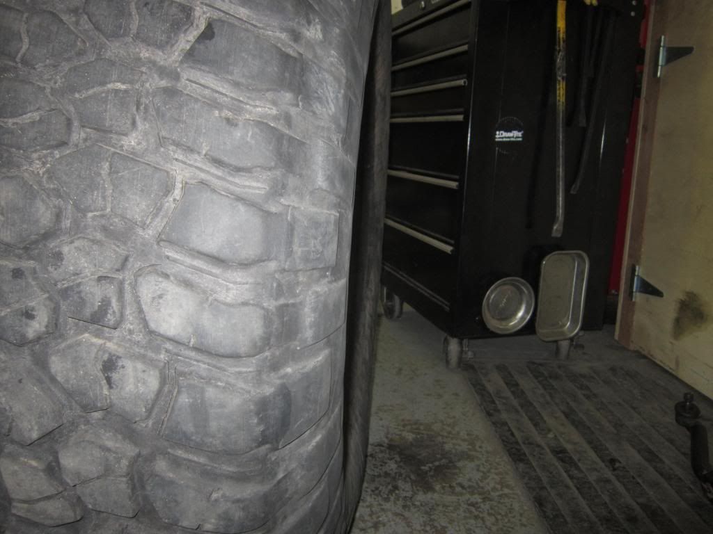

Thanks guys. I am waiting for Monday with nervous anticipation. Hopefully, the steering goes in without an issue. Last night I was able to back it out of the shop and forward, reverse, and 4wd worked.

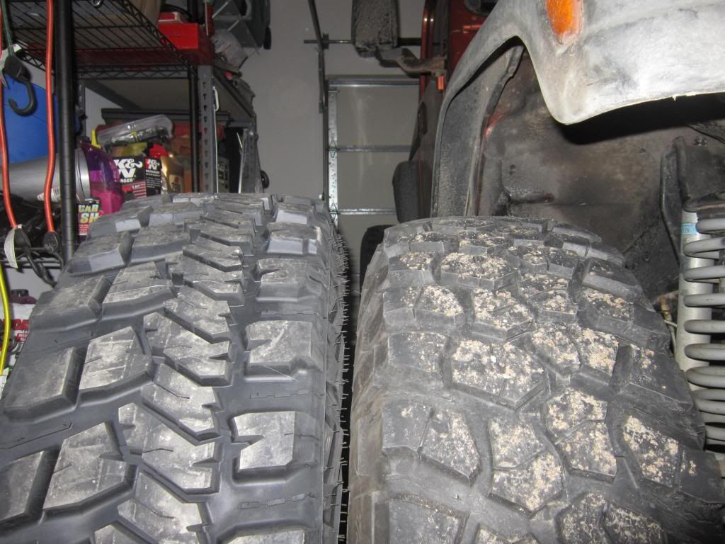

I got my spare tire the other day. I am planning on running 40" Goodyear MTR's.
I scored four used BFG KM2's for a decent price so I will run those till they die since I am out of money. I will keep the MTR as a spare and work on a four tire rotation.
Here is a 40" MTR next to a 40" BFG. The MTR is almost two inches taller. Granted it is not mounted, inflated, or under load. Both are listed as 39.8" by Tire Rack.

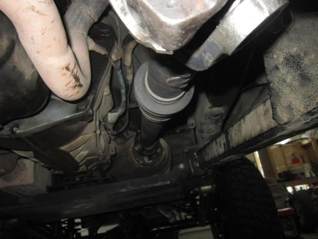

Rear drive shaft fit nicely. It is at 19 degrees.
What is the old adage about "assume"... I never put any calipers to the pinion yoke on the front 60. I always assumed it was a 1350 u-joint. Well, it's not! Much to my surprise the yoke that came on it was a 1330. I will address that when I get around to ordering a new front drive shaft.
I used a Dana Spicer 5-134x u-joint to go from 1310 to 1330.
When I was researching the build, I read about people who had front drive shaft issues and had to clearance their tunnel. I also read about pumpkin and oil pan problems with the famed 78-79 Dana 60. I did not run into either of those problems. You can see the drive shaft fits nicely in the tunnel.

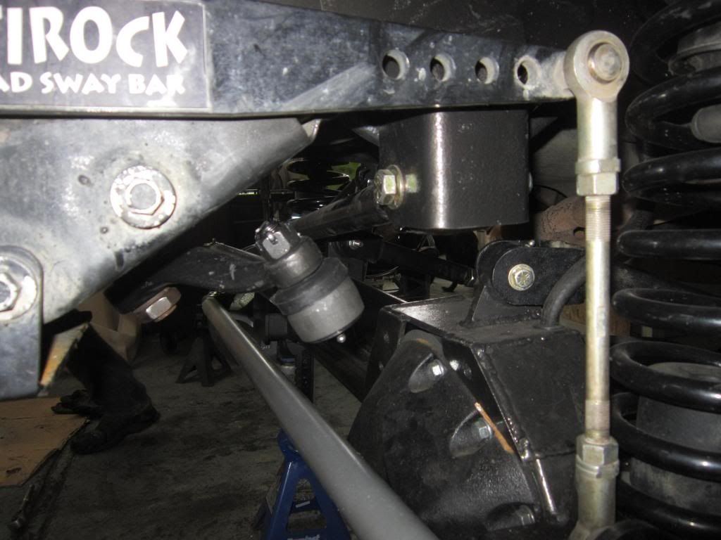

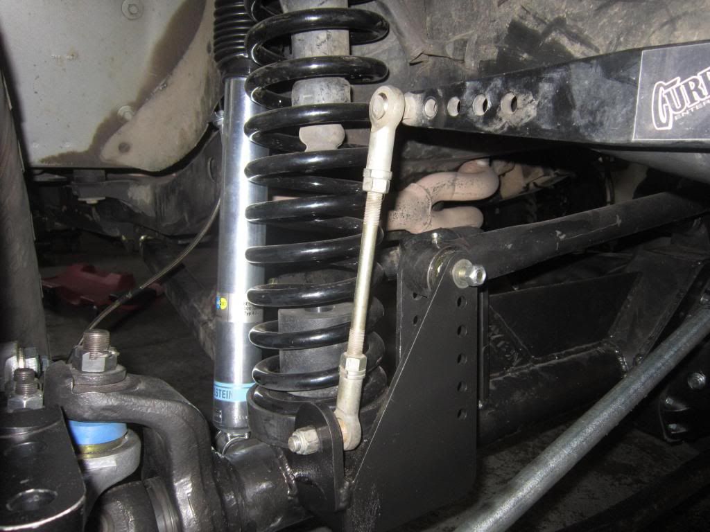

How I did the front AntiRock. I didn't use the antisway bar tabs supplied by Clayton. They were going to interfere with the draglink.

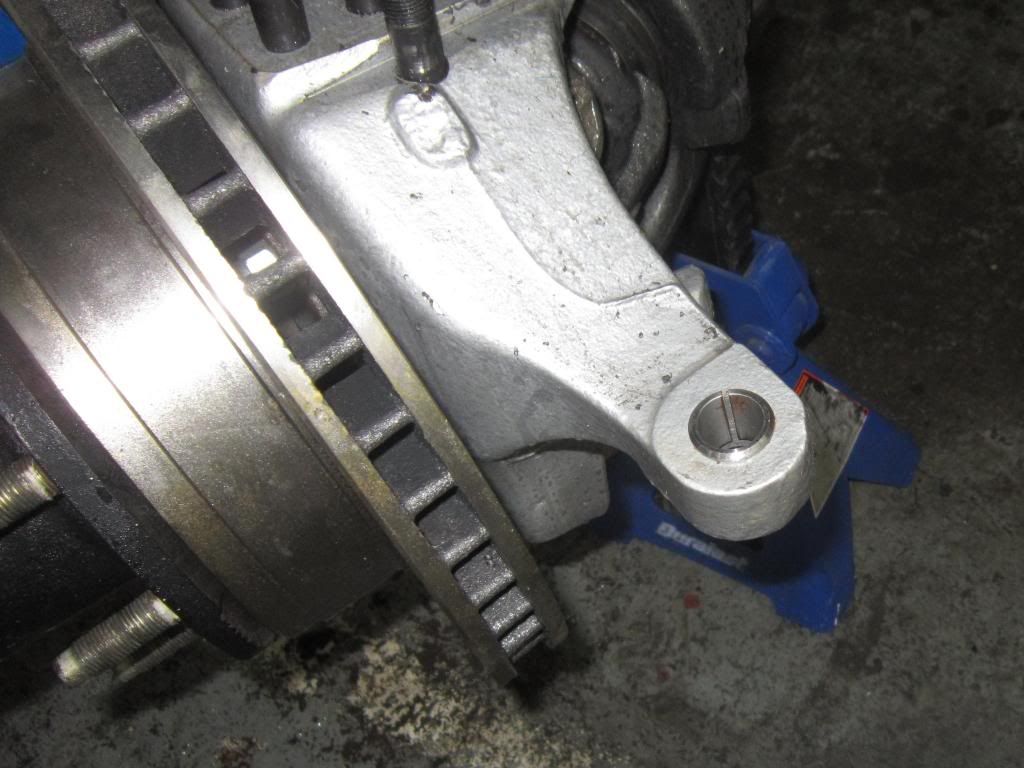

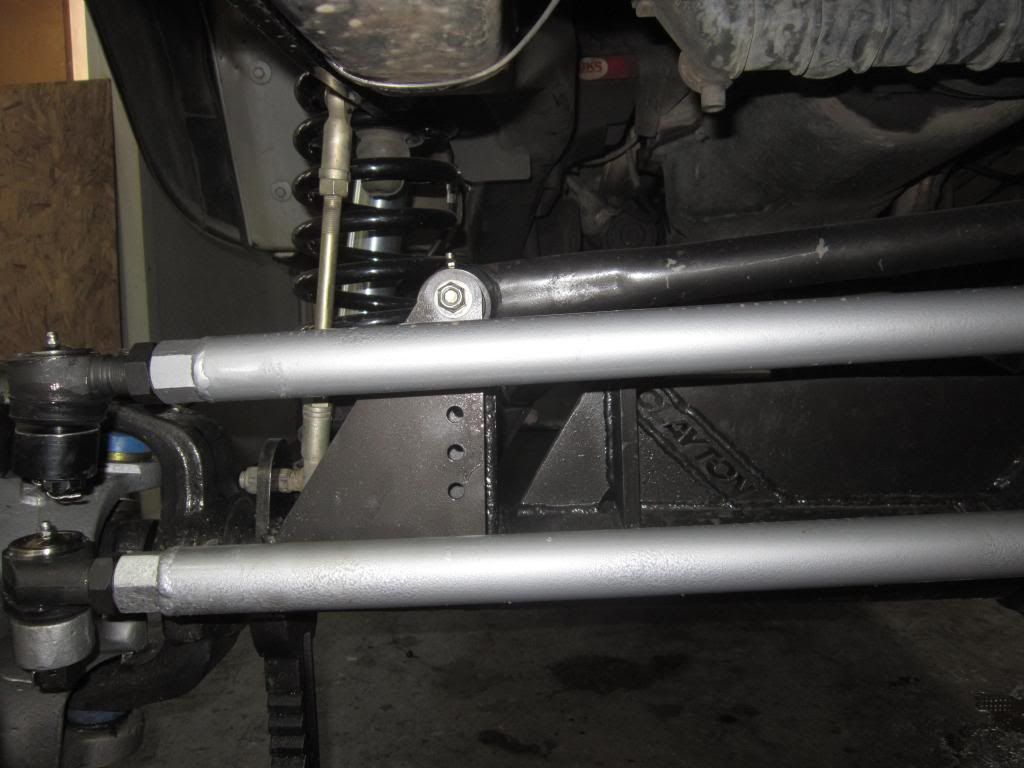

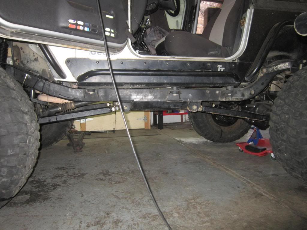

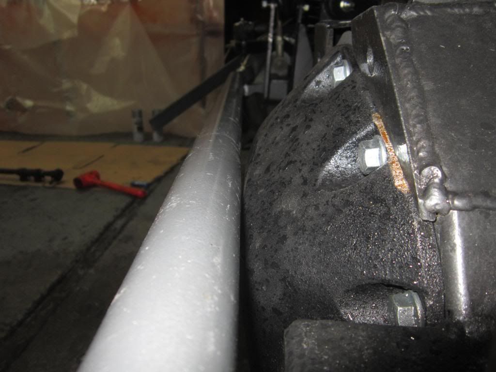

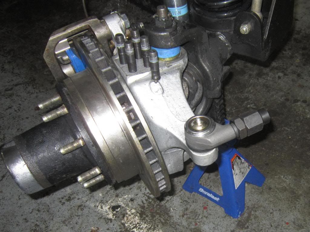

This morning I got the tie rod and drag link built. I used a Ruff Stuff crossover kit. Two GM one ton TRE's for the drag link and two GM one ton offset TRE's for the tie rod. Two 54 inch sticks of DOM and bungs. This stuff is beefy 1/4 inch wall.
I also got their GM tapered inserts. I drilled the knuckles out with a 7/8" bit and dropped the tapered insert in.
With an offset TRE in place.
I am so glad I ordered the offset TRE's. I have about a 1/8" from the tie rod to the diff cover at full lock.

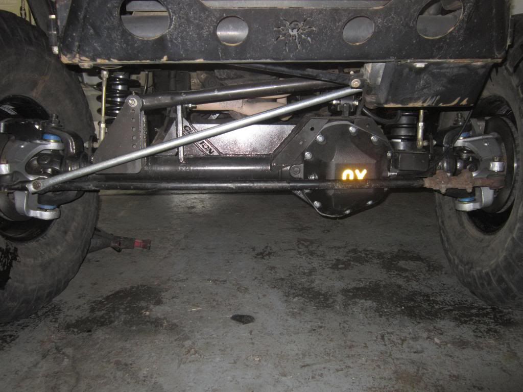

The set up:
I am not happy with the drag link and the track bar. When we mocked it up I liked what saw a lot better.
I think I might get a waggy pitman arm to bring that end of the drag link up.
Maiden voyage:
As you can see mother nature was punishing those of that live in the Colorado Rockies today. I never got the Jeep above 40, but the steering and tracking worked fine. Maybe the trackbar/draglink don't need a change?
What I can is the brakes stink. I did the MC swap, but I still don't like the brakes. I have to mash them to get the rig to stop. As I recall, most report a stiff pedal after this swap. I want to tinker a bit more before I post more about this.
I drove it two hours home today. I have no complaints (other than the brakes). Since the interstate was closed due to a massive amount of snow, even for us, I had a long drive to get accuanted with the rig. The Detroit in the rear didn't bother me at all.
It drives better in 4WD than before due to the high pinion front. I knew I had bad angles up front before. I didn't do much to address them since at trail speeds it was fine and I knew that polished turdy was going sooner than later.
A bit of luck: Apparently the speedo gear for 4.88's and 35 is the same one for 5.13's and 40's! Drove past a couple of those radar speed limit signs today, I am spot on!
