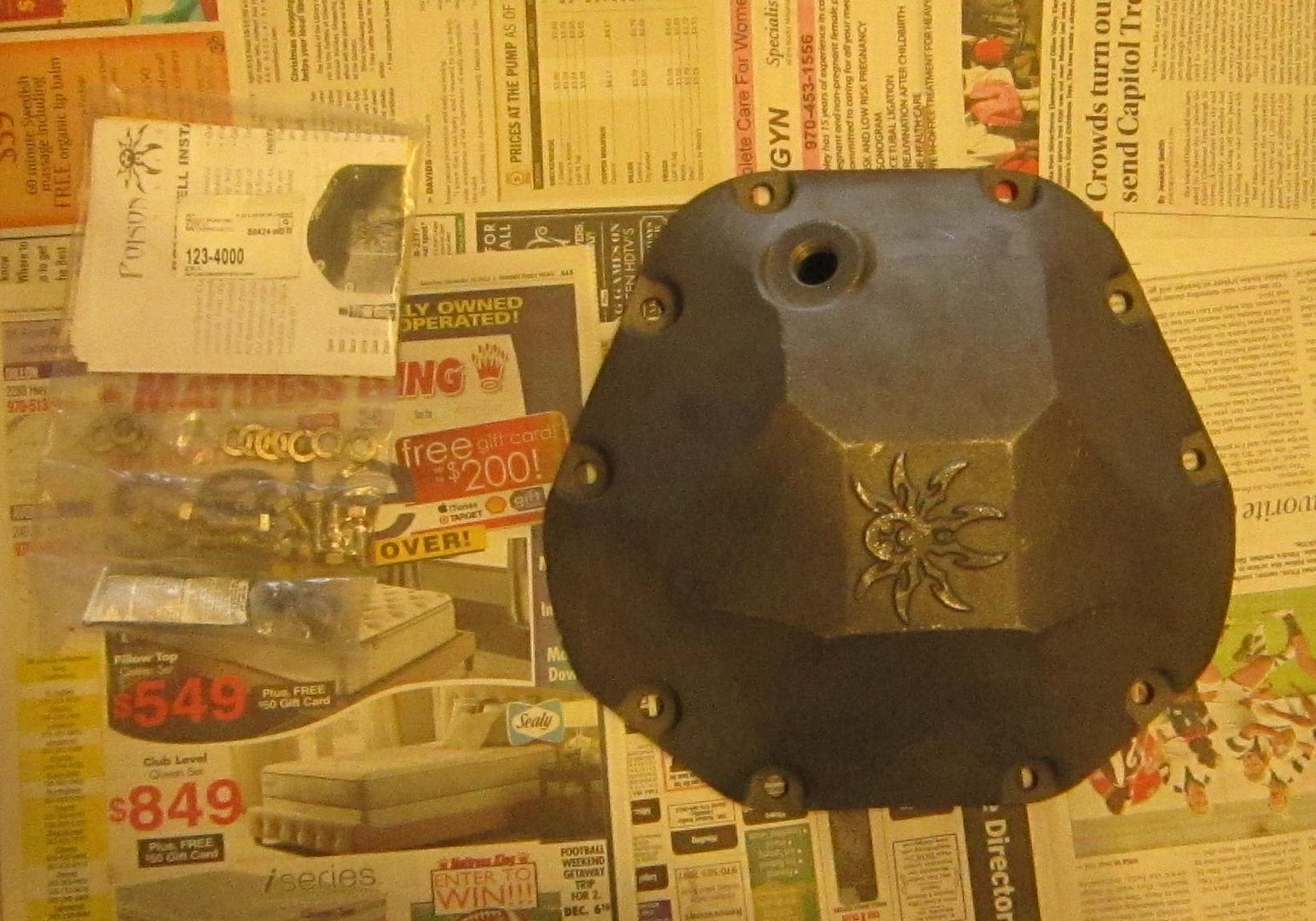

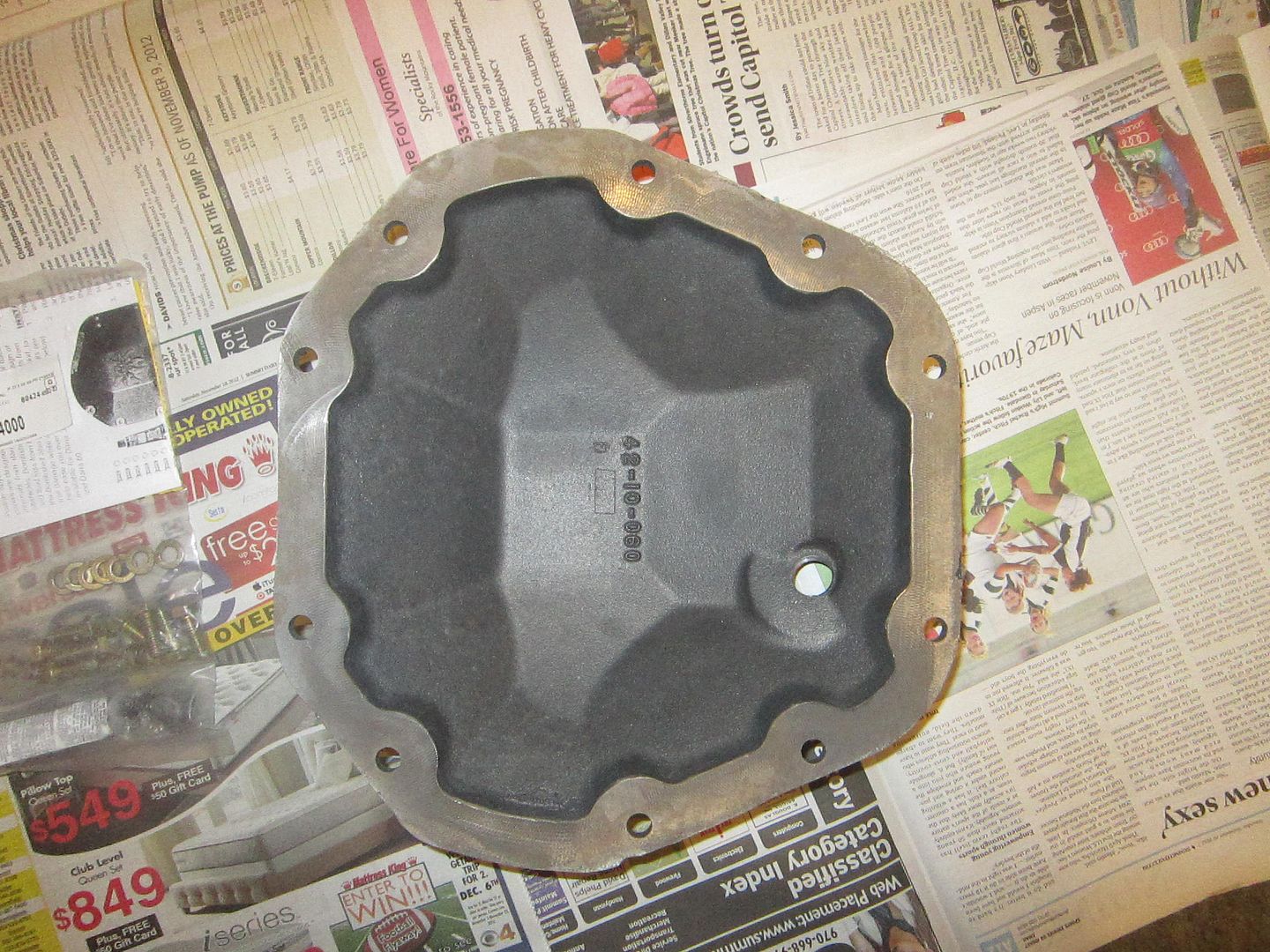

Poison Spyder Customs Bombshell Dana 60 Differential Cover
Packaging was lack luster. The box was split when it arrived. Does that matter This hunk of metal is stout.
I decided on the Bombshell because it had the rounded edeges for sliding. The bolts were some what protected in the couter sunk holes. It came with grade 8 hex head hardware (six point). I drive like crap so sometimes I need to bash my way back ward through rocks and this diff cover offers that opportunity!

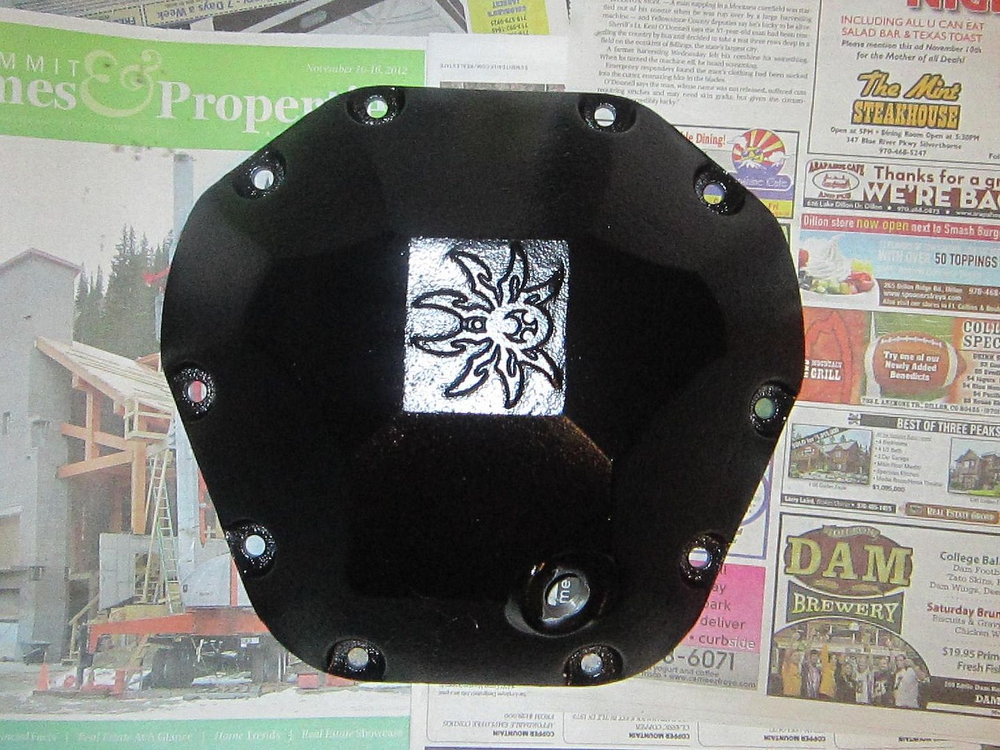

Bombshell
After some prep, primer and Semi Gloss Black.

I like the new diff cover. Beefy.

Hopefully this piece of machined "high ductile iron" will keep my gears safe when I can't.

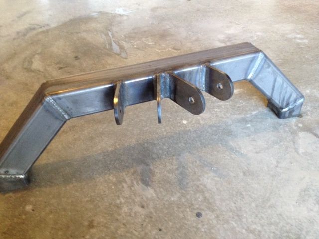

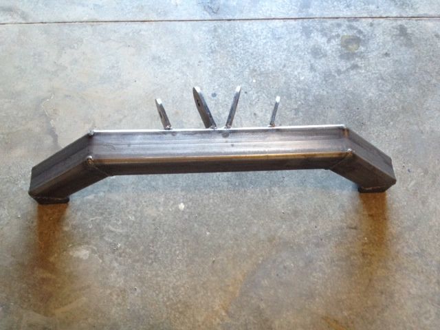

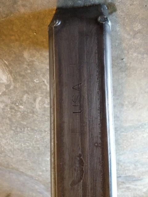

Clayton 4-Link Truss
So I pulled the Clayton Truss out of the box today. Clayton changed their truss from round tube to square. I guess to match the arms
