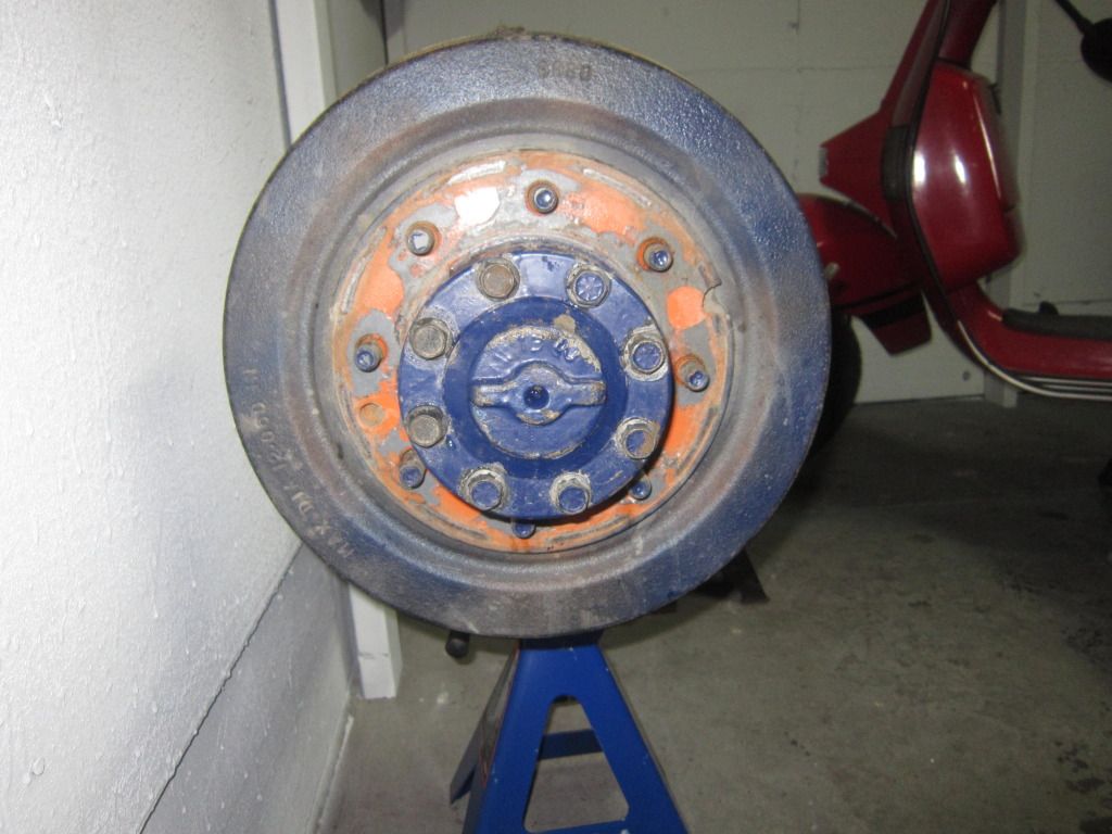

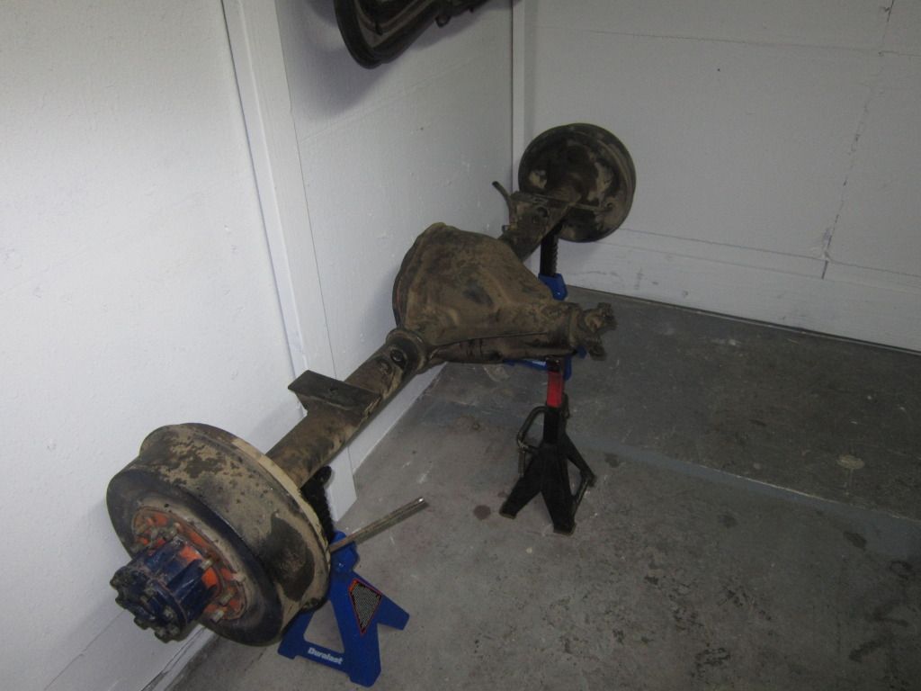

Today I brought home my new to me Dana 60 Full Floater. This beast came out of a 79 Dodge. Right now it has the 30 spline full floaters, 5.13's, 1350 u-joints, and a Detroit Locker.
I have plans to do a disk brake conversion, truss, and more before it is slung under the Jeep. Of course I still have to find some rolling stock, and a front 60!
