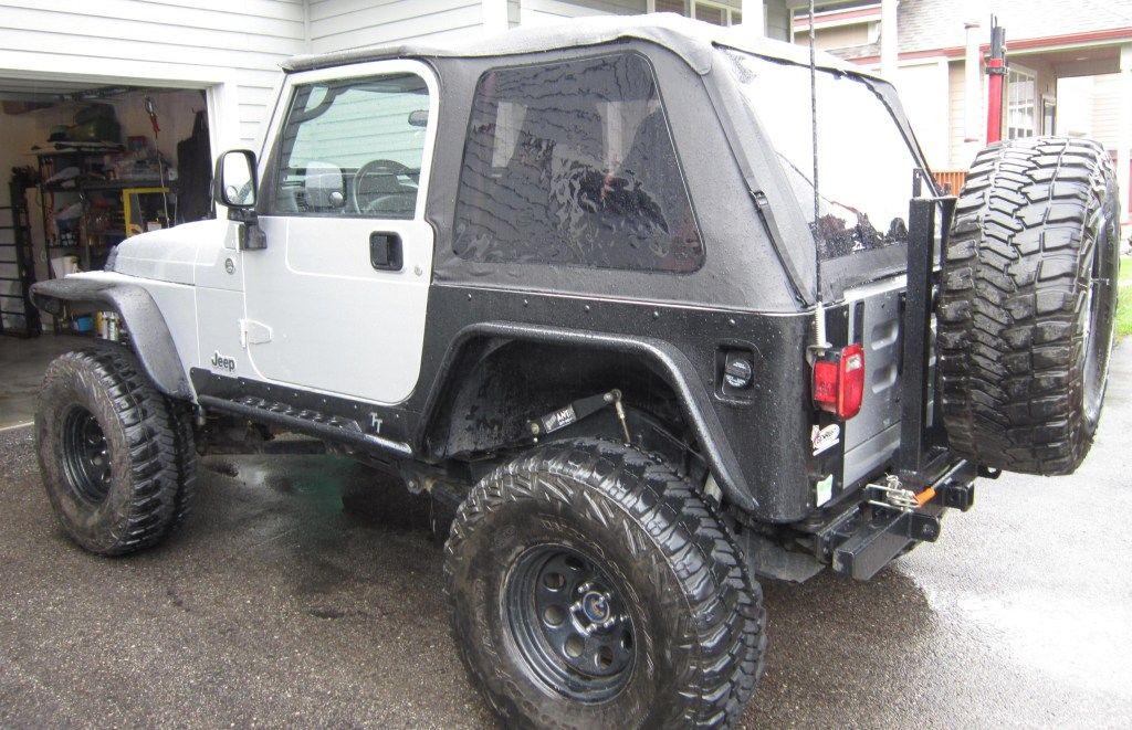

Can't help but laugh at the leverage that rack would put on the stock tailgate in that pic. Something like that would likely work well for this purpose... on a stout tire carrier.

Based on Hoovails pic I decided I would try to build my own rack for the tire Garvin Industries Wilderness Series swing out tire carrier. The system is meant to have a rack, can mounts, and a shovel and axe mount attached. For more money of course. It is bolted to the rear cross-member and I also had it welded for added strength years ago when I put it on.

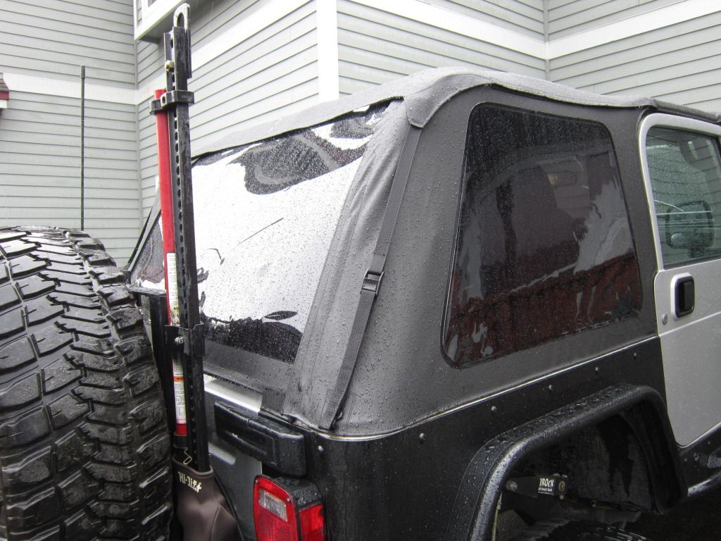

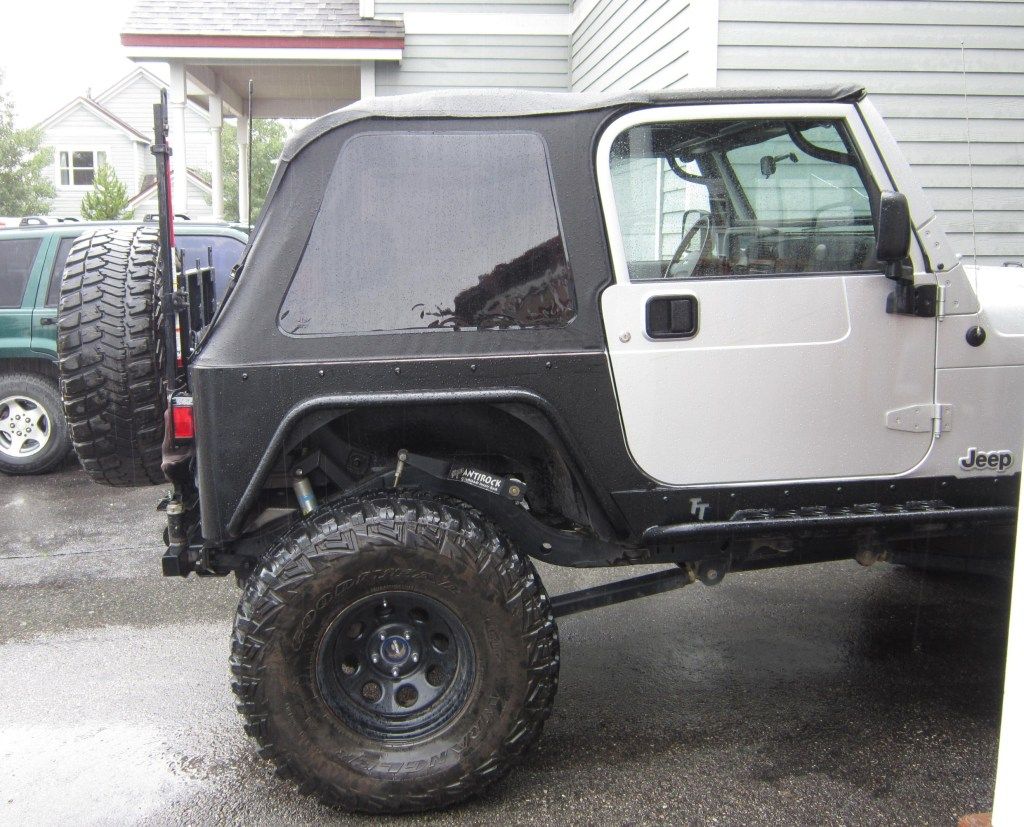

Rampage Frameless Soft Top
Easy to install. Heavy zippers. Huge windows. Dark tint. Gear pockets. Overall, I am impressed.
The only existing part I had to change was the location of my rear spreader bar. The buckles for the rear window were right where I had the spreader. It worked, but I didn't like how taught the top was on top of the bar and buckles. It moved the bar forward about a centimeter and all was well.

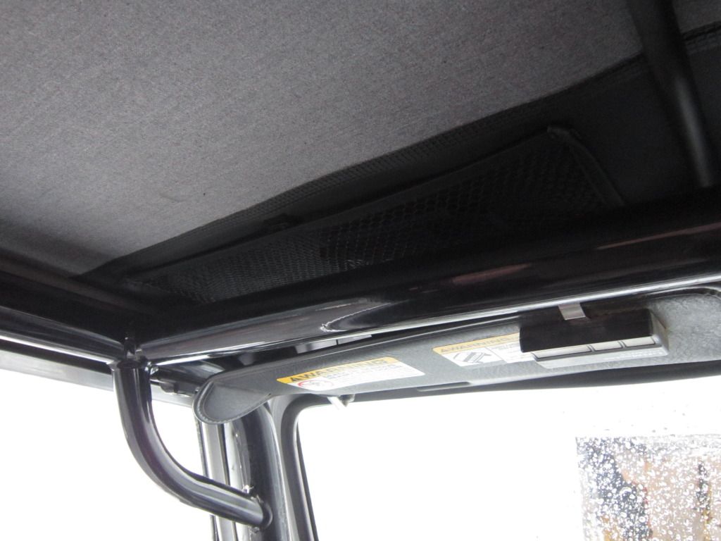

Gear Pocket

That rear spreader may come in useful down the road if the top starts to sag!

Very nice. Does it look like it will work with the rack?
Do you have a pic from the inside?

Yes it should work with the rack fine. Since there is no B bow the rack will sit high enough. Since there are no forward bows the front clamp will work as well. Now I haven't lifted it up there yet...
I won't need it on this trip since I have the fugly. It looks like all the gear will fit without it.
A couple of years ago we had to take two cars to Moab to camp for a week. I don't think we will for next family run.
The rear spreader absolutely is keeping the top tight.
