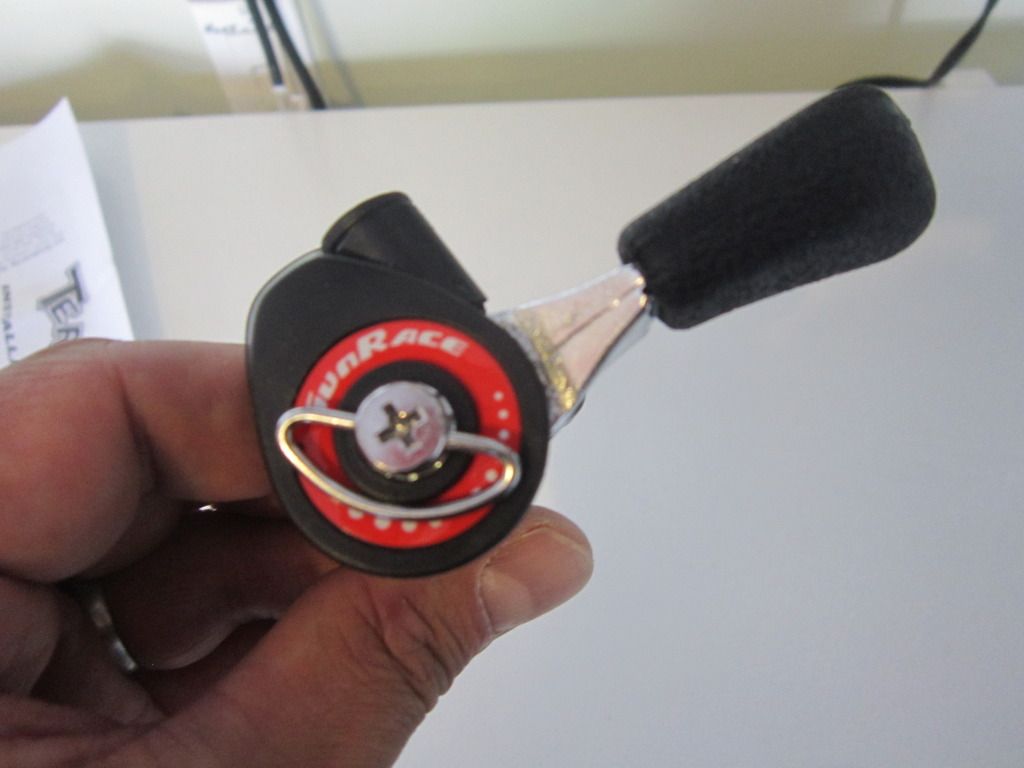

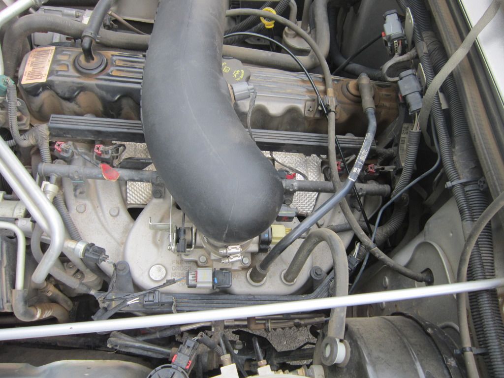

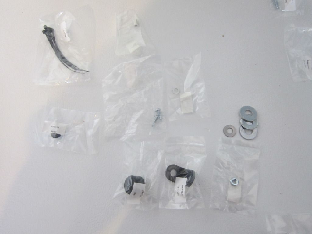

Teraflex Hand Throttle
Today I installed my Terafelx hand throttle. You can piece this together yourself. I bought my kit for $36.00. You decide if its worth it for yourself.

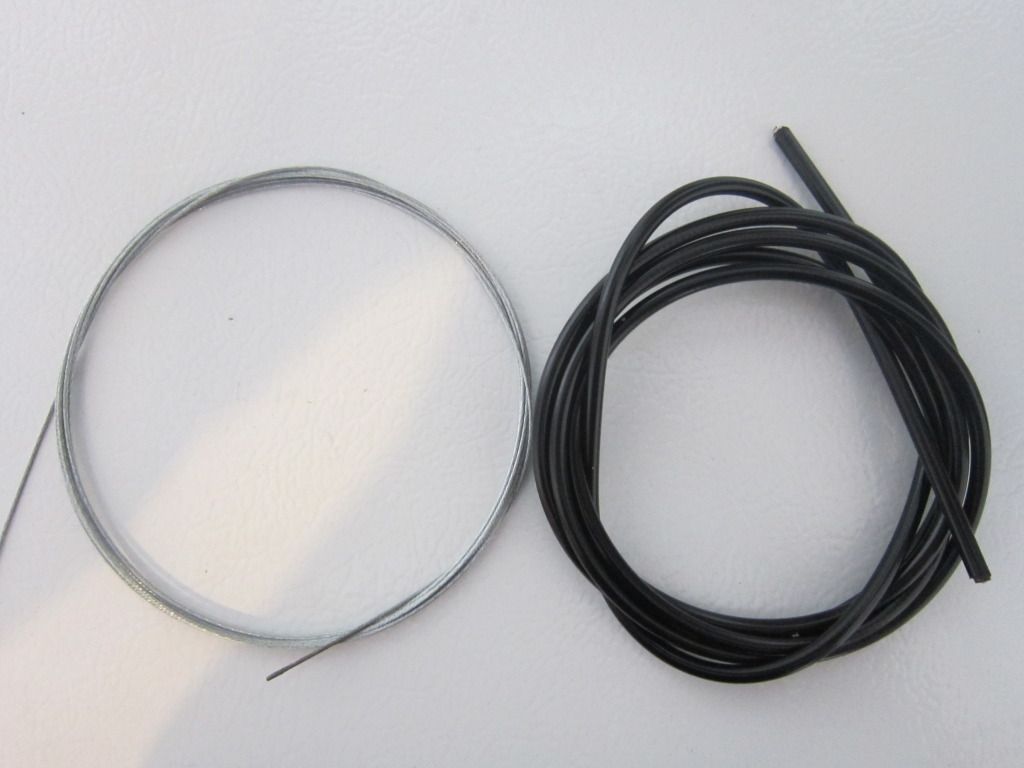

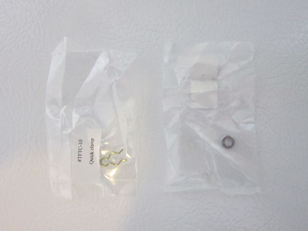

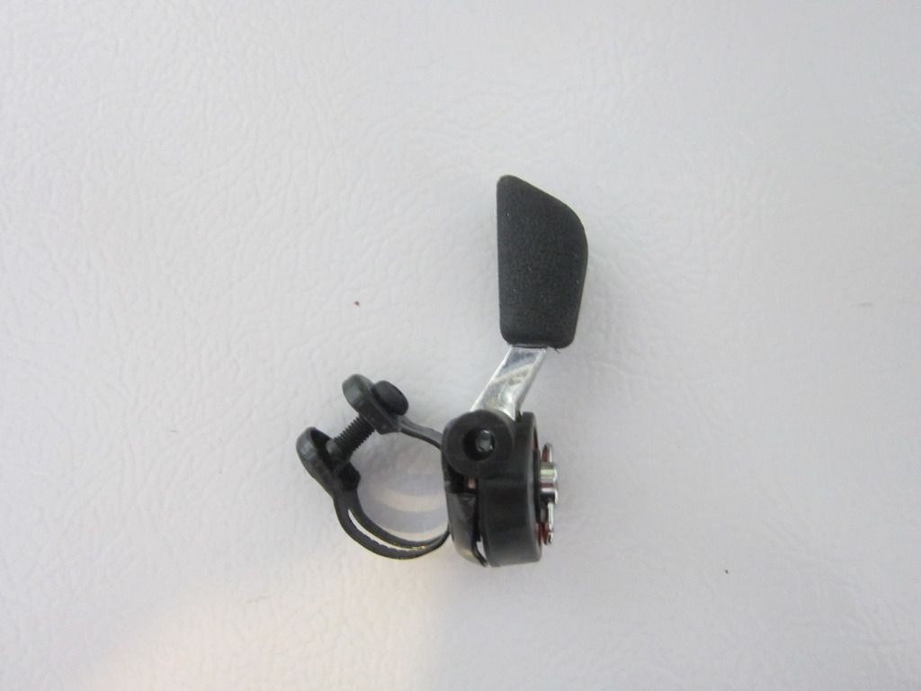

Its basic components are a bike shifter, cable, a bracket, and a clamp. Pretty simple. I took shots of the part Teraflex sent so if you want to build your own you can see what they send. Truth be told, I had extra parts, I am guessing they may have been needed if I had cruise control
Cable and Housing
Shifter
Parts

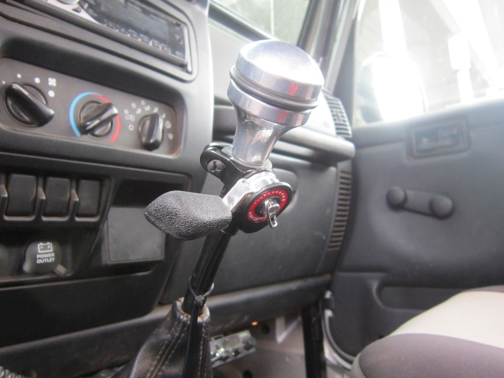

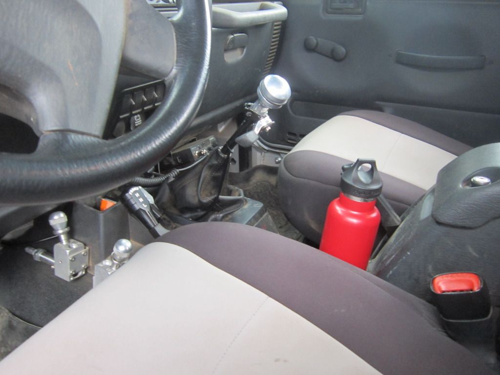

In Cab
It works well thumb actuated. I originally set it up to be index finger actuated but the lever was hitting my heater controls.
Throttle
Cable routing
I ran the cable through a hole in the tunnel I already had for the Ox cable. It was in the tunnel just below the firewall. It worked well and did not kink the cable and gave me a direct route to the throttle with gradual bends.
Works so far on pavement test

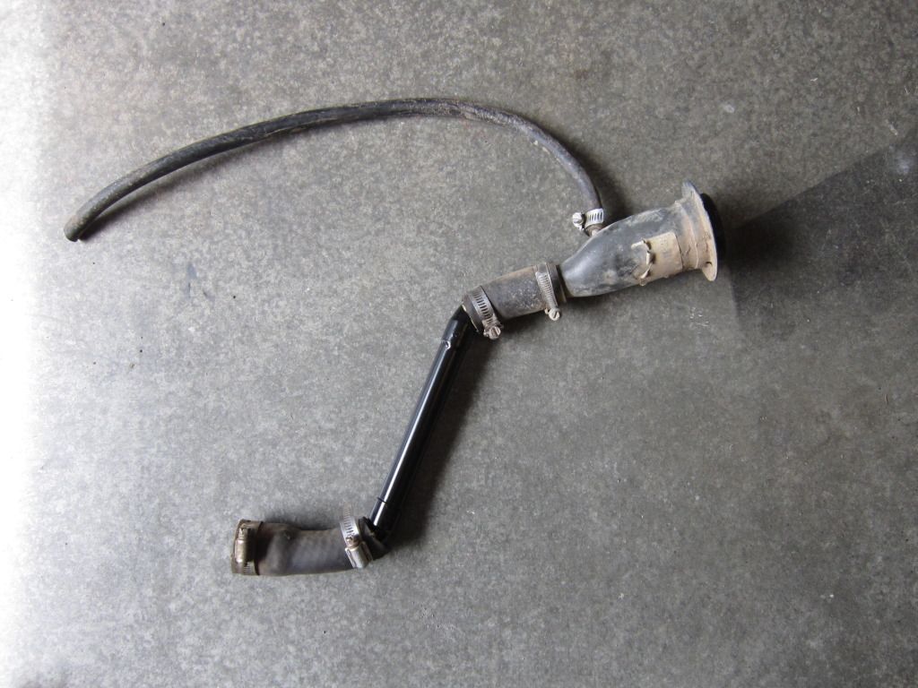

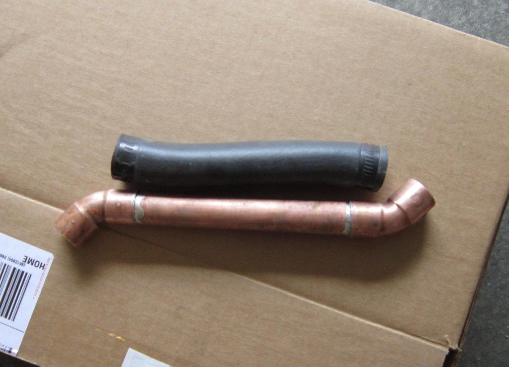

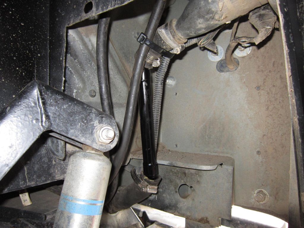

TnT Customs - YJ Style Bezel
From the day I finally was able to fill my tank with the system I rigged I was not happy. I did not like using the drain tube one bit, but it worked. I worried about the tube degrading after exposure to fuel over time and ending up with plastic bits in tank, lines, etc... What a nightmare that would be.
I have heard of people using PVC tube, but I couldn't find any around here. So I decided to go with copper. I got a stick of 3/4" copper tube, a couple of elbows, some flux, and some solder and went to town. Once I got the hang of soldering copper tube, I was rolling.
Here is what I came up with to replace the drain hose:
I ended up using to 45 degree elbows. They fit well with the tank and the bezel.
Installed:
Now I am not worried...

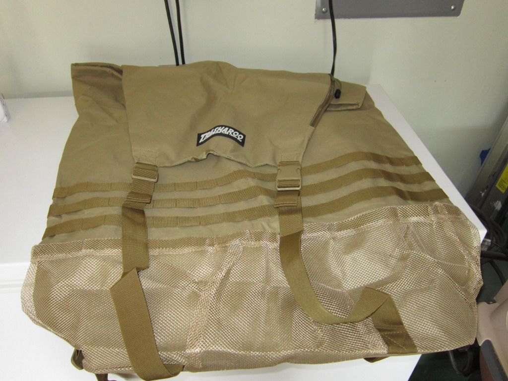

Trasharoo
In preparation for an upcoming camping and wheeling adventure to southwest Colorado I figured I needed to do something about trash hauling. I will be traveling with the family, to include a kiddo still in diapers. I really can't fit a trash sack in the Jeep and really don't want to, diapers and all...
Several years ago I learned the hard way that Hefty yard bags will not make it down the trail to the next Forest Service dumpster. A bag tore and spilled trash all over Kane Creek Road in Moab. That was FUN to pick up...
So, I got the Trasharoo. I can put my trash bag inside it and it will support the bag on the rear tire carrier.

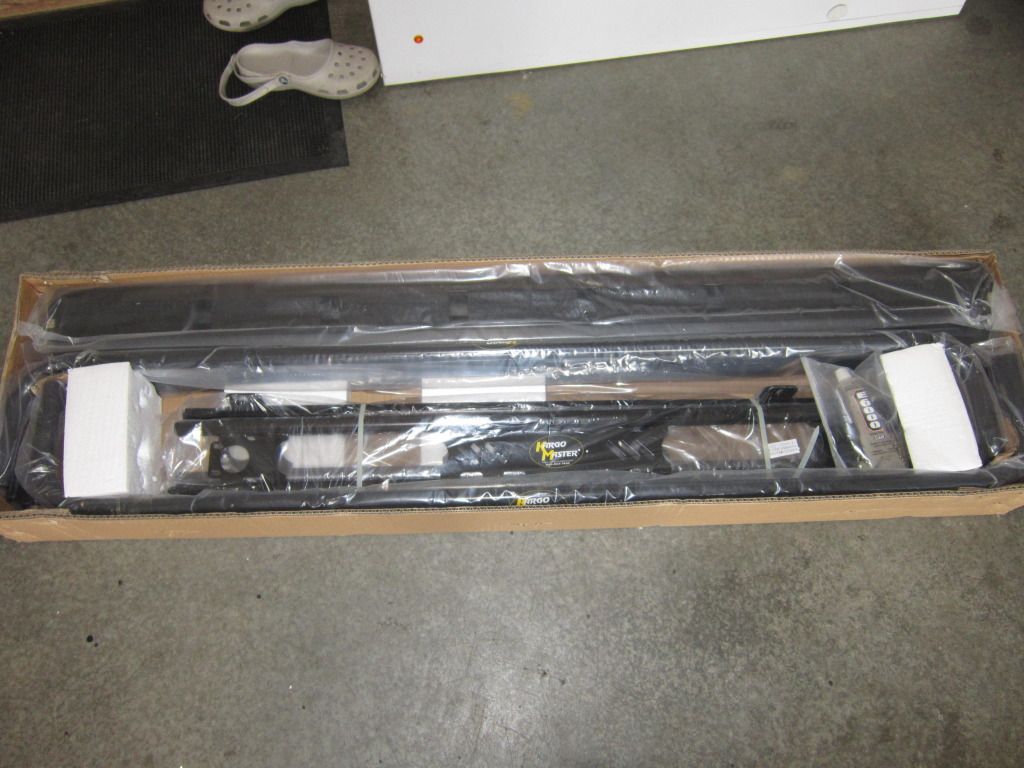

Kargo Master Sport Bar Safari Rack
As I said above we have an upcoming camping and wheeling adventure. With the family in the rig there is just not much room to fit camping gear, food, beer, etc...
It has to go up top. Yes, I could get the rack system that goes with my Garvin tire carrier, but I don't want to. I see myself trashing that thing and going toward a GenRight or Poison Spyder carrier in the future as the meats get bigger.
I DO NOT want a roof rack that ties into the corners and windshield etc... That is retarded. Sorry if you have one, just not my style.

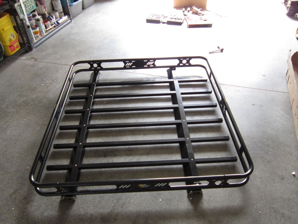

This Kargo Master system will bolt via brackets onto the sport bar. It should, and intitial mock looks like it will, allow me to keep my top on and have the roof rack. The system is supposed to work with bikini and safari tops. I am going to keep my top on and just loose the door surrounds.
I won't be completely water tight, but it will be good enough to travel 6-8 hours away in the Colorado Rockies and not freeze to death
The rack assembled
More to come, had to quit for the day...
