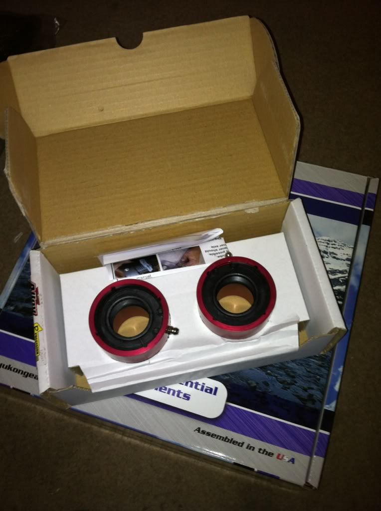

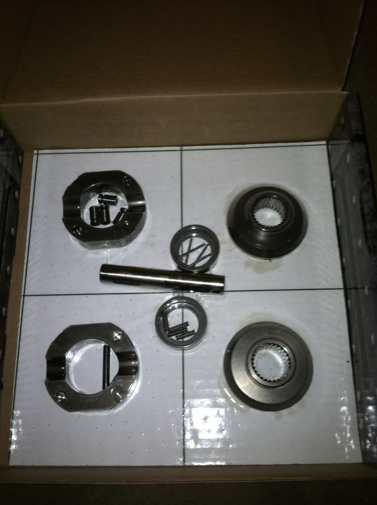

parts came in!!!!

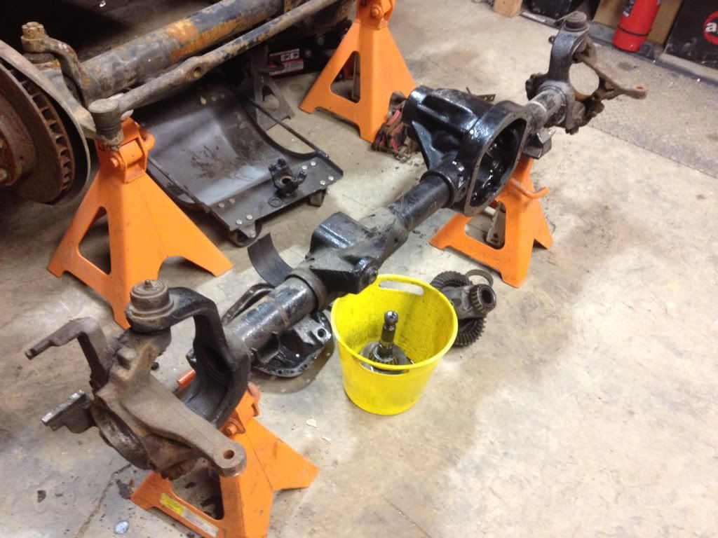

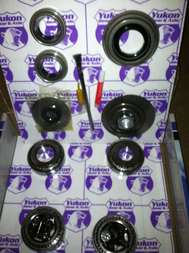

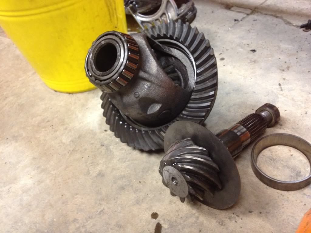

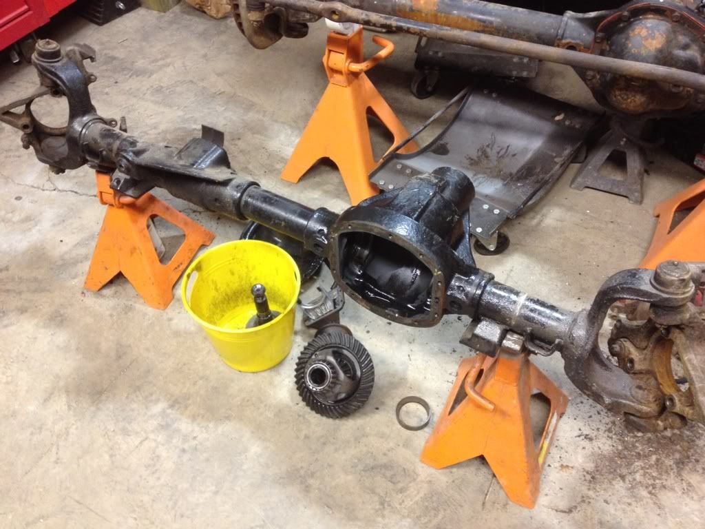

i got in the shop for a little last night. i got my old dana 30 apart to get the 4.10's out of it.

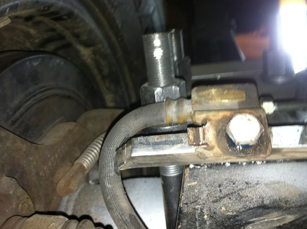

finished up the hydraulic breaks this weekend on the 8.8 my buddie and i came up with a realy cool idea. we took the u bolt spring plate drilled a hole and tapped it for the soft lines and just bolted them on. CHECK IT OUT
