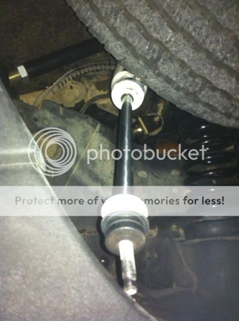

Leeroy is finally lifted! With the help of 949702jeeps (Chris) and our friend Brandon, we were able to put the lift on in 2 days with a little over 20 hours of work in Chris's garage. These last three days have been anything but uneventful with Leeroy.
Friday morning we started to tear into him. We started with the front and had little problems replacing the control arms. We had already broken many of the bolts loose earlier in the week. Old vs. New..
[IMG][/IMG]
I'm not exactly sure what he was doing, but no more than an hour into the take down, Chris had already put us down one pair of channel locks.

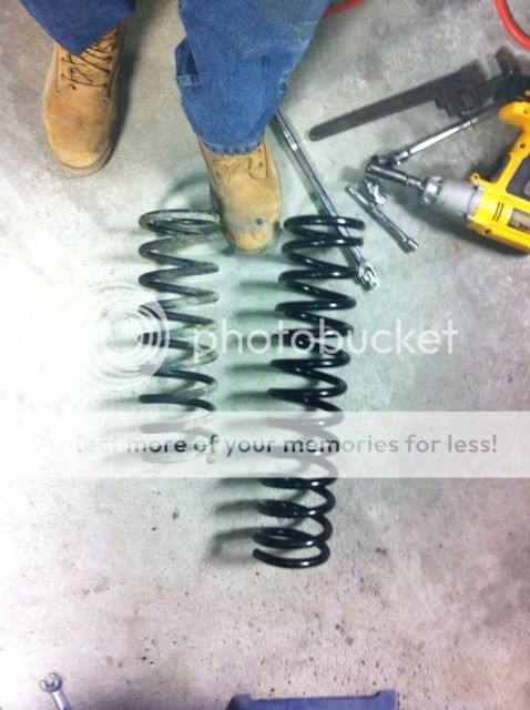

The springs were a bit of hassle to get in, even with the spring compressor. Old vs. New again..
[IMG][/IMG]
