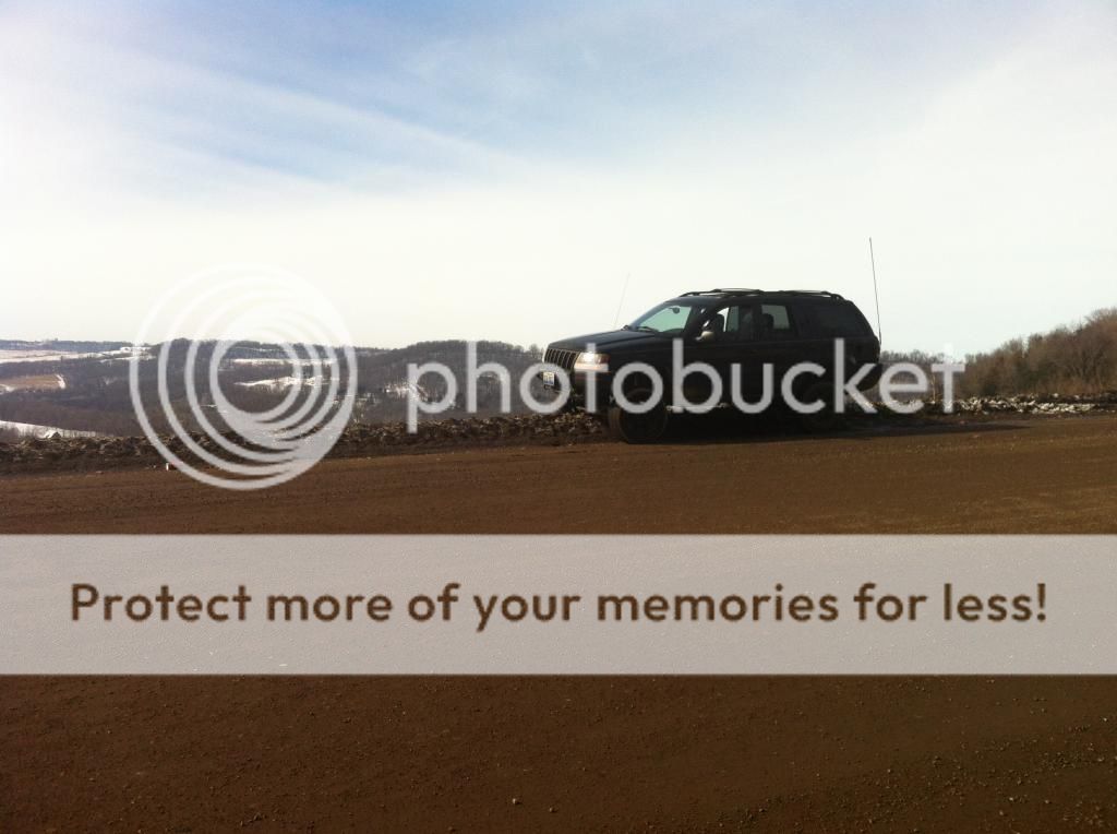

On another note, I was able to take some decent pictures before work yesterday on a dirt road I found. I've also included some pictures I took of the sunset here at work. I work at a ski hill here in Dubuque and this is one of the treats I get to see almost every night.
