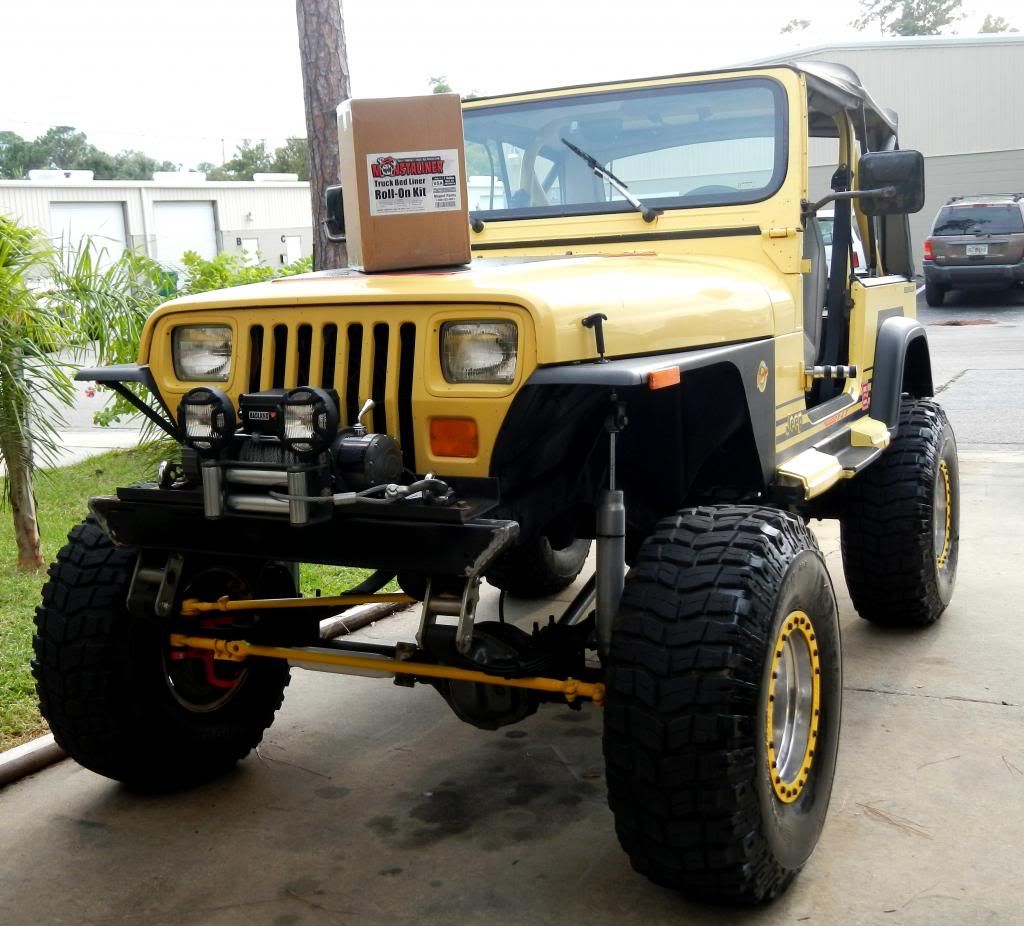

ALSO this just showed up about 15 minutes ago! Guess in the next few weeks I will be prepping and putting down some Monstaliner in the tub and will redo the hood going up into the windshield. Should look really tight once the yellow is laid down with it and the OEM striping.

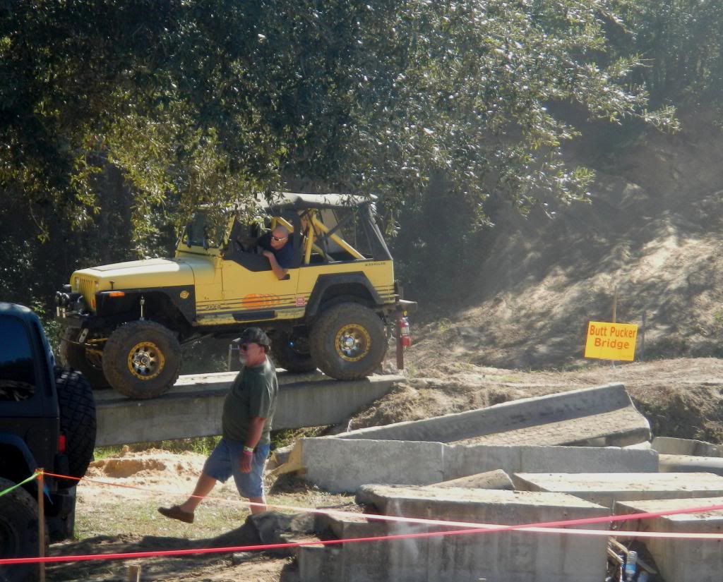

Ok I guess I can now take "mall crawler" out of the equation! I mean it's no Moab, but Jeeptoberfest was pretty damn cool and the YJ performed nicely.
BTW, the Edelbrock Offroad carb kit did an excellent job off camber...yes, I did stall her out a few times on some hard drops, but I am satisfied....I see no need to go propane at all.

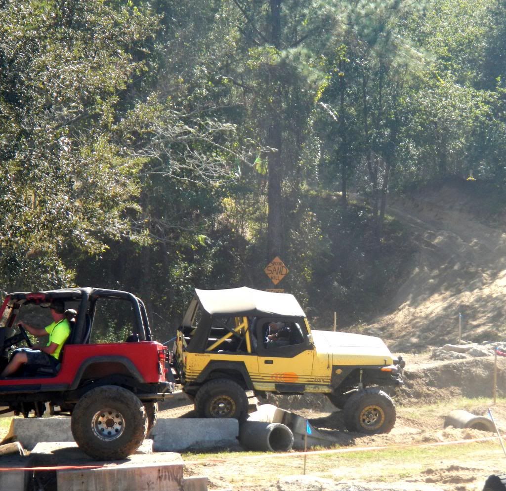

...just a few more....

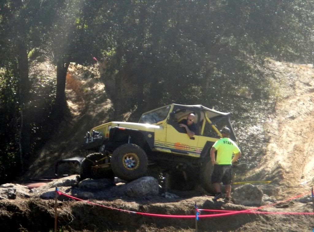

..all the pretty paint underneath is gone!
You can bet you a$$ I am not repainting and yellow under there again! Screw that man! Gonna' just stay black!
..and with that said, because I am so proud of her I am going to show her love by NOT WASHING her. Let her whore around with some gaudy makeup for a while!!
BTW, wasn't a lot of mud there...which was fine by me!

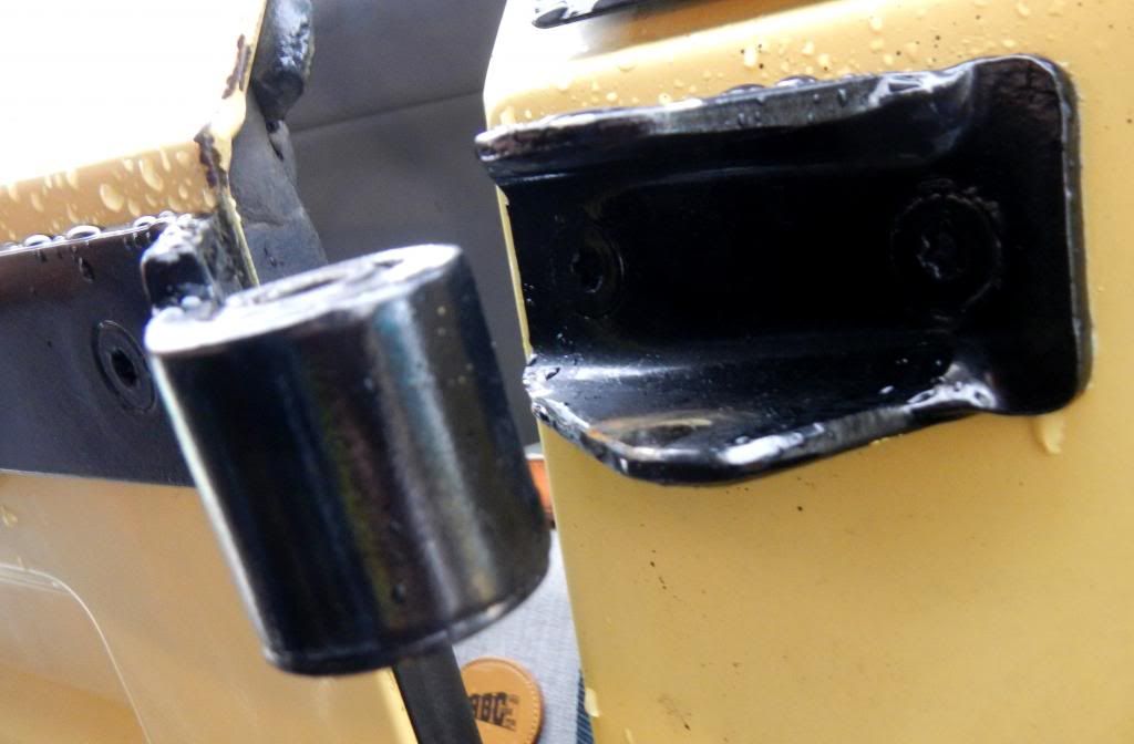

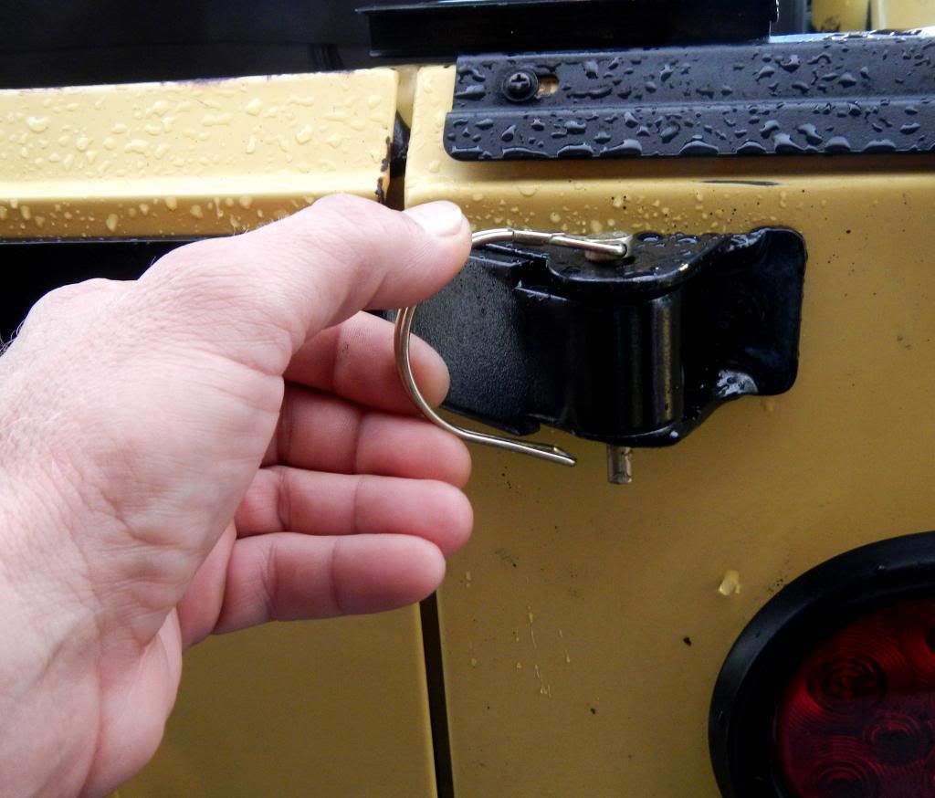

jawasan what did you do for a latch on your tailgate on the pass. side been thinking about doing the same also does it rattle at all

I used the existing hinge as a latch itself. I will post up some more pictures...I finally got around to attaching the cables and finishing it off. One of the most useful things I have done to 'er.

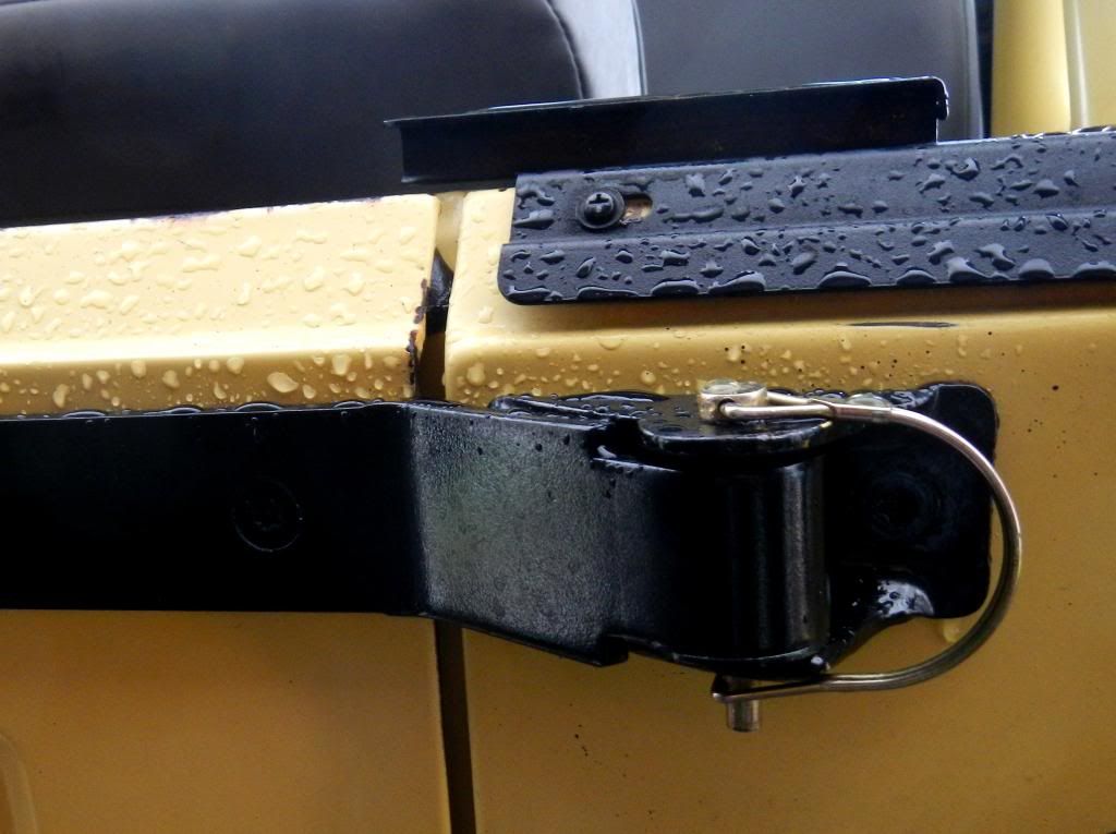

Here are a couple close-ups. I did cut off some of the lower hinge tab so when closing it goes in easy....the swing/arch will cause it to rub when closing and opening, so I trimmed it. The drop in pin works fine since I am in and out of the tailgate area OFTEN and I do have a t-handle hitch lock that fits perfectly and is not too big and gaudy.

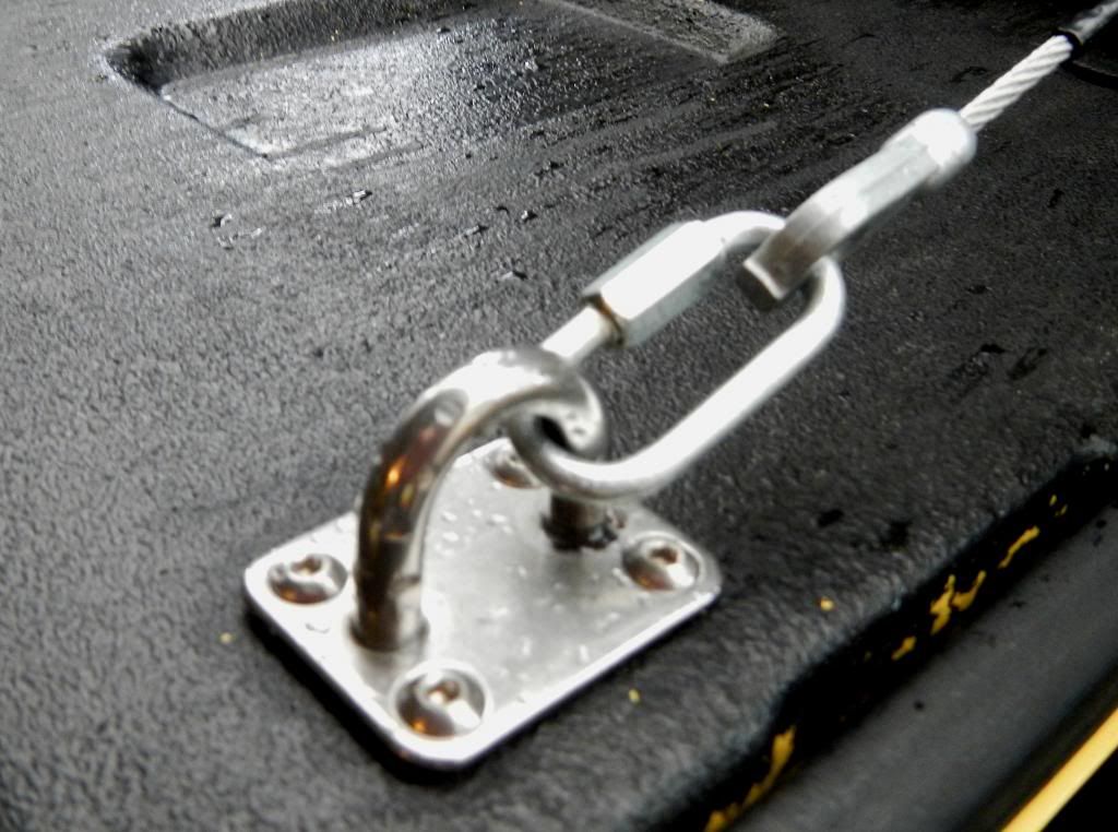

- just a couple more of the straps in place and hardware I used (nutserts/rivnuts)....
