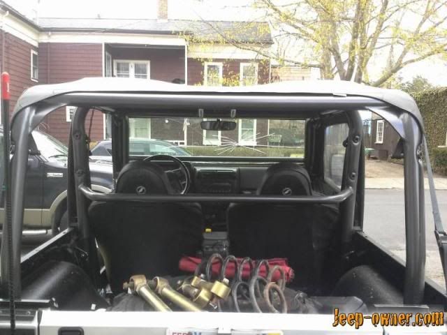

Over the weekend got the cage all painted:
And after ripping out the airline/sensor the other week and the fitting is all rotted out, I decided since it would be easier to remove the axle to drill out the fitting. That way I can just run the airline thru the pumpkin like my buddy has done instead of the airline on either side. Since its out, now is the time to drag the axles over to my buddy for a regear/chromo axle upgrade!

Welp just picked up these guys. Found someone looking to trade for stock seats plus $50. A couple years old but ever since the kid put them in, the Jeep mostly sat in the driveway, so not worn at all, just a bit faded from the sun. We swapped full seats/brackets so they just bolted right up no problem. Couldn't pass that up..
Pretty comfy and definitely hold you in. A little short since they are the SS's but good enough for me as I mostly just use the Jeep for wheelin'. Down the road I'll tie them into the cage, but for now they will do.
What kind of control arms do you have in your Jeep there?

Looks like Cloaks to me!

Ya, Bob got it.. Have em off since the rear axle is out for regear. Buddy just got started on it, so a little longer. He told me last night the carrier bearings are all f'd up. Asked if the rear was noisy, but the rig has been quiet/smooth as can be.. Weird. So perfect timing on my end.
Then the front has to come out. Can't wait to drive it!
