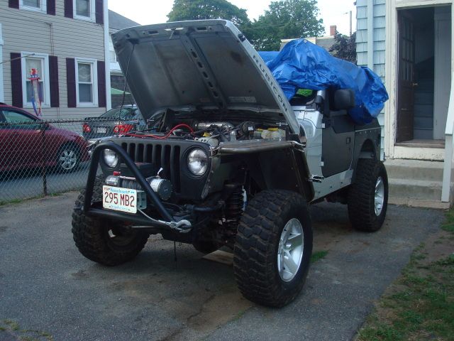

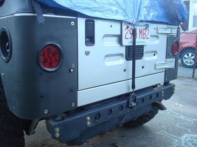

Got a shot of the reverse LED's that I installed to stay legal and make sure I don't back into sh*t. Copied B2CARPEN with these, since they were super bright. No night shots til I get the battery back in after highline install...
Edit: Here is the link to the lights: http://www.amazon.com/Custom-Anodize.../dp/B007PBPI68
Or just copy/paste the item description in amazon:
6500K Xenon White 4.5W LED Eagle Eye Lamps Back Up Reverse Parking Tail Light
03' Rubi: 2" BDS, 1.25" BL/MML, Hylined rollin' on 35" MTR's

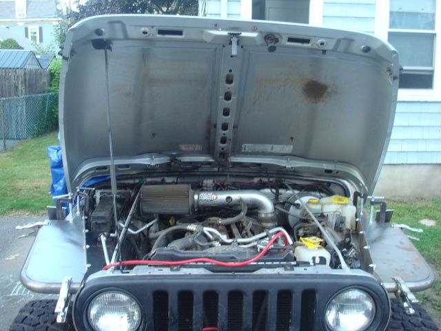

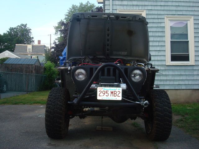

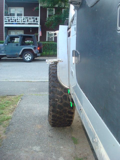

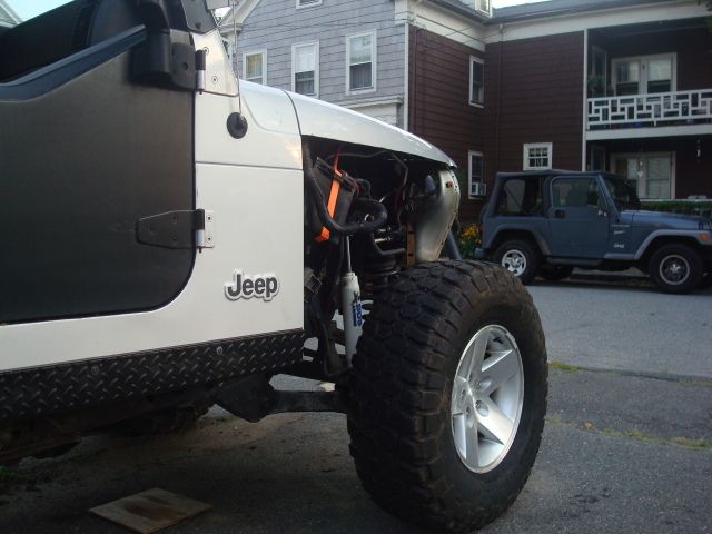

Got the passenger side highline in place, so this weekend its all set up to be welded! Man these are bada$s! Definitely need to find some cheap 35/37's or get around to selling my Trailblazer that is just sitting in the parents driveway... Then I could put that to some new MTR's and regear. That would be tit.
While I was at it I checked for where I'll be placing all the under the hood items that bolted to the inner fenders, should be all set, just will have to extend the washer bottle wiring, but fits nicely next to the brake fluid. Also cut down the CAI tube so that'll fit. It's getting there!

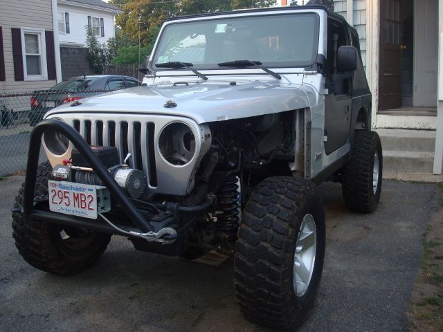

Finally got around and cut my hood. Not as bad as I thought it would be, just went at it. Came out pretty good and nice and straight. Still waiting on the fenders, hopefully I'll get em back from my neighbor today/tomorrow, as I'd like to rap this prject up this weekend. At the latest I need to be done by next Thurs as I got a weekend of camping and wheelin'!

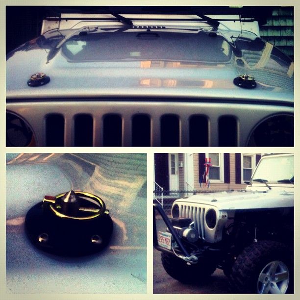

Also got some hood pins in the mail yesterday, might throw them on today, just need to find some hole saws that wont break the bank.

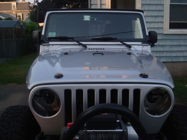

post #75 of 842 Old 08-30-2012, 04:45 PM Thread Starter
janesy86
Location: Beverly
Posts: 1,446
Stil waiting on the fenders... But in the meantime I got the hood pins installed and battery tray/battery back in. So hopefully I should get the fenders back late tonite and this weekend they will get some paint and then its just as easy as bolting them up!
And some pics of the hood chop!
