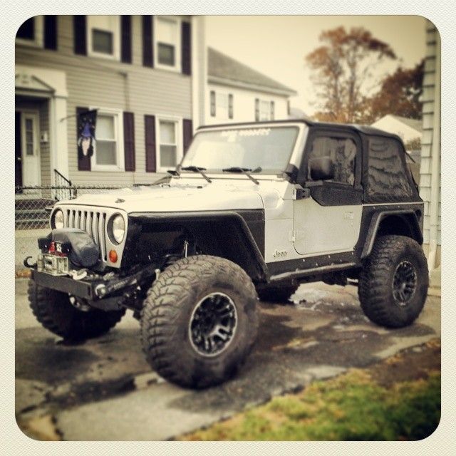

Well its that time of year again....
Decided to button up the top now that its been in the 40/50's and take her in for a bath.
And I love how it looks like the wheels have a silver lip, but from the rock rash!

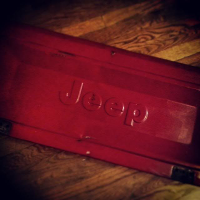

Picked this guy up the other day, super cheap. A bit of a dent running up thru the first 'e' but not bad enough for me to not want it. Its not a show Jeep anyway..
Otherwise its in great shape, unlike most of the ones I've seen around me. No rot, just a little surface rust where the hinges were and it came with the cables and hinges too, which most are missing around here.

Originally Posted by Moabrubi View Post
Thats gonna look sweet..
I think so too! Love the look with the stamped JEEP logo.

Its not that bad to install the CJ tailgate and looks awesome when its finished. The most difficult part to me was getting the reinforcements up into the rear channel without cutting a huge hole . For hardware I used Ford Explorer Sport Trac cables and bolts from the junkyard . The tailgate bolts from the sport trac required some trimming , but threaded right into the CJ tailgate . I did make spacers for the body side mounts , but it was also simple . And if your going to try and strip the tailgate , find someone who can blast it for you . I tried chemically stripping mine and it turned into a nightmare with all the edges on the tailgate.

Yea, I figured that getting the reinforcement pieces in the rear would be the hardest part, but I guess I'll find out once its go time.
As for the cables I got the stock CJ cables so I'll just use those... And from the few thread I've read on this mod, make it sound pretty easy, so not too worried, just waiting for either a warm garage to do this in or just wait til spring, unfortunately that may be the case.
I do know a couple sand blasters, so I may just go that route. Thanks for the tips tho!
