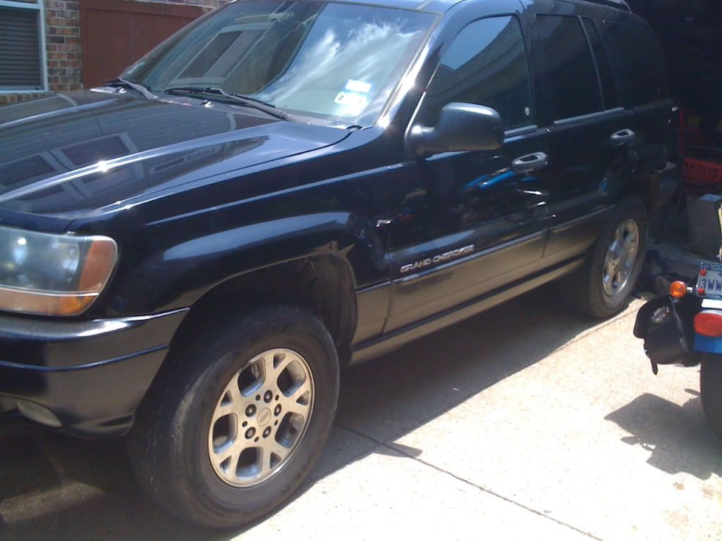

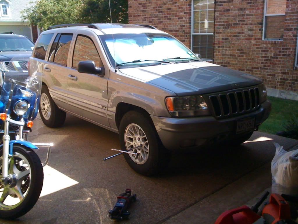

Well, I figured it's time to start my own build thread after enjoying and learning so much from other members here.
My WJ is a 2002 Limited with the 4.7L HO engine, quadra-drive system (NV247), 454RFE transmission and 135K miles. I've been very happy since I purchased it in September 2011.
Here she is:
I've kept up with all the maintainance, I bought it from the first owner who gave me all the records of previous maintainance. So far I've enjoyed very mild wheeling locally and it's amazing what it can do with street tires (245/70R17)

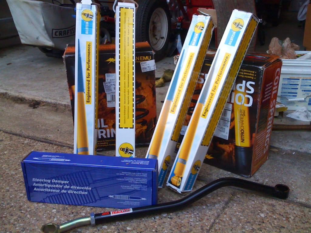

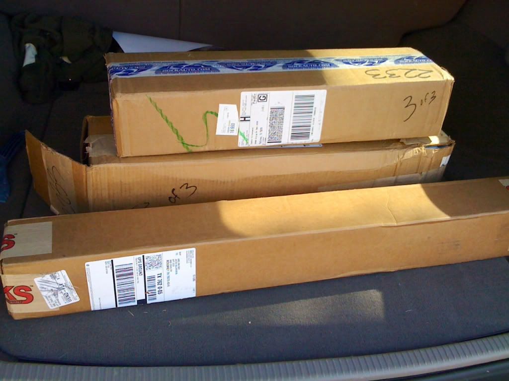

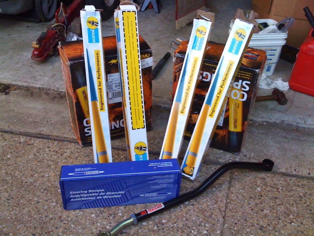

Ok, so finally got my lift all in the mail today, thanks to Kolak for the advice, pleasure doing business with him. I'll be working on it this weekend. Here are some pics:
Still in the shipping boxes
And I just arranged them like this to pump me up for this weekend. It makes me feel that I won all of this in a raffle or something lol

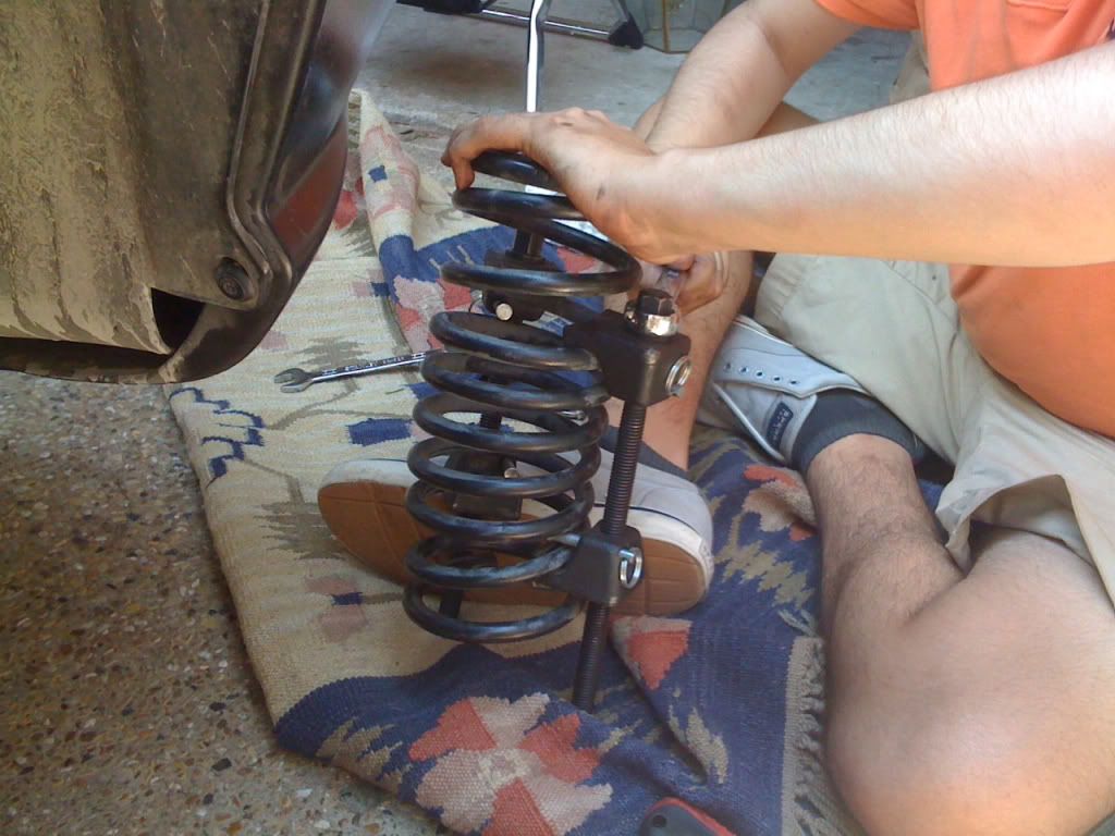

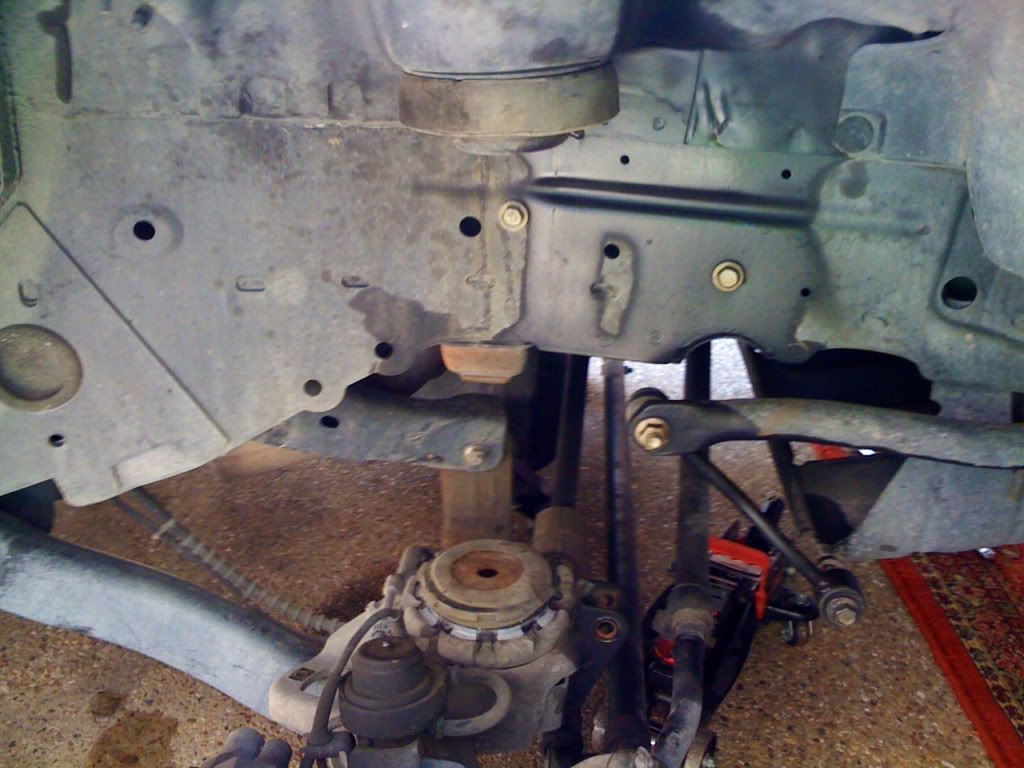

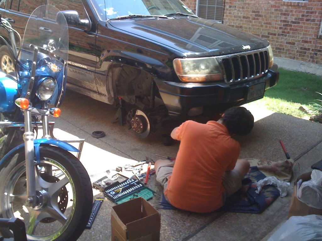

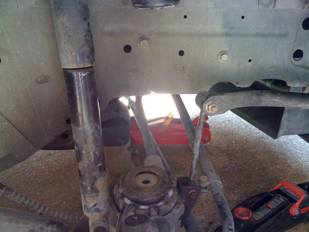

This is unrelated to my build but I found some pics of when we installed a bb from Fat Bob's Garage on my brother's WJ. We had fun doing it and it was good experience for the both of us.
Here is a pic of my brother disconnecting his sway bar:
Using a set of coil compressors that we rented from Autozone:
Front right spring removed:
Aftermath:
That was about 2 months ago, since then we've replaced the steering stabilizer and he got a different set of stock wheels and more aggresive tires. I wish we had taken more pics of the process but the bb was kicking our butts since it was the first time we tackled a lift. I'll do a better job at documenting the process when we install mine

awh man, took me awhile to figure out you can easily droop that axle enough to just let the coils fall out / put new ones in.

Yeah, you just have to jack it up high enough to be able to drop the axles low enough for the coil to "pop" out. They still need a little help after that and disconnecting sway bars also helps

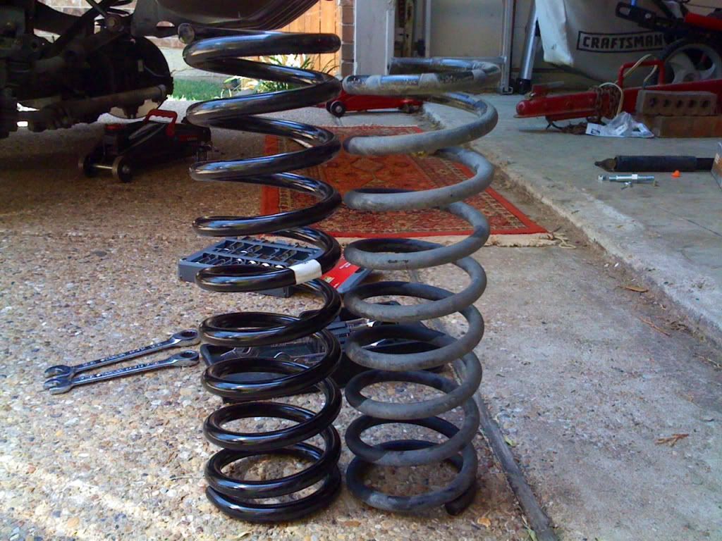

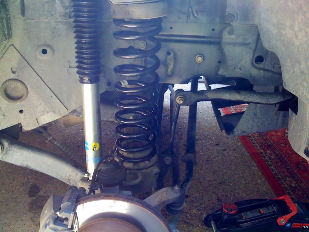

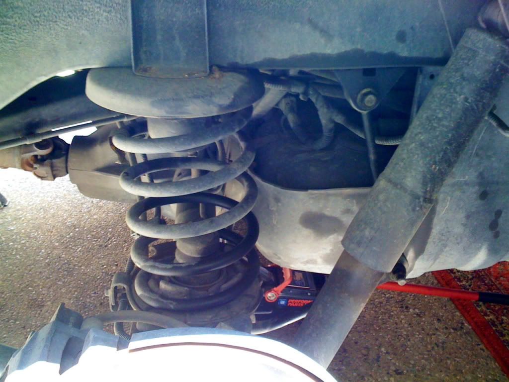

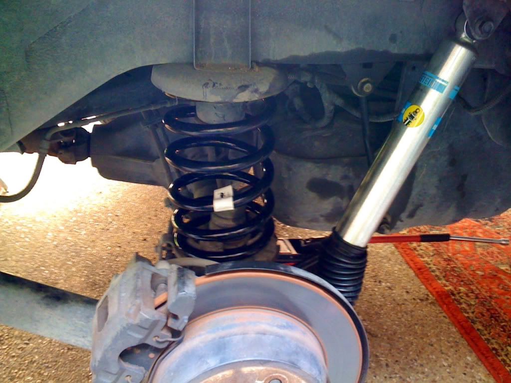

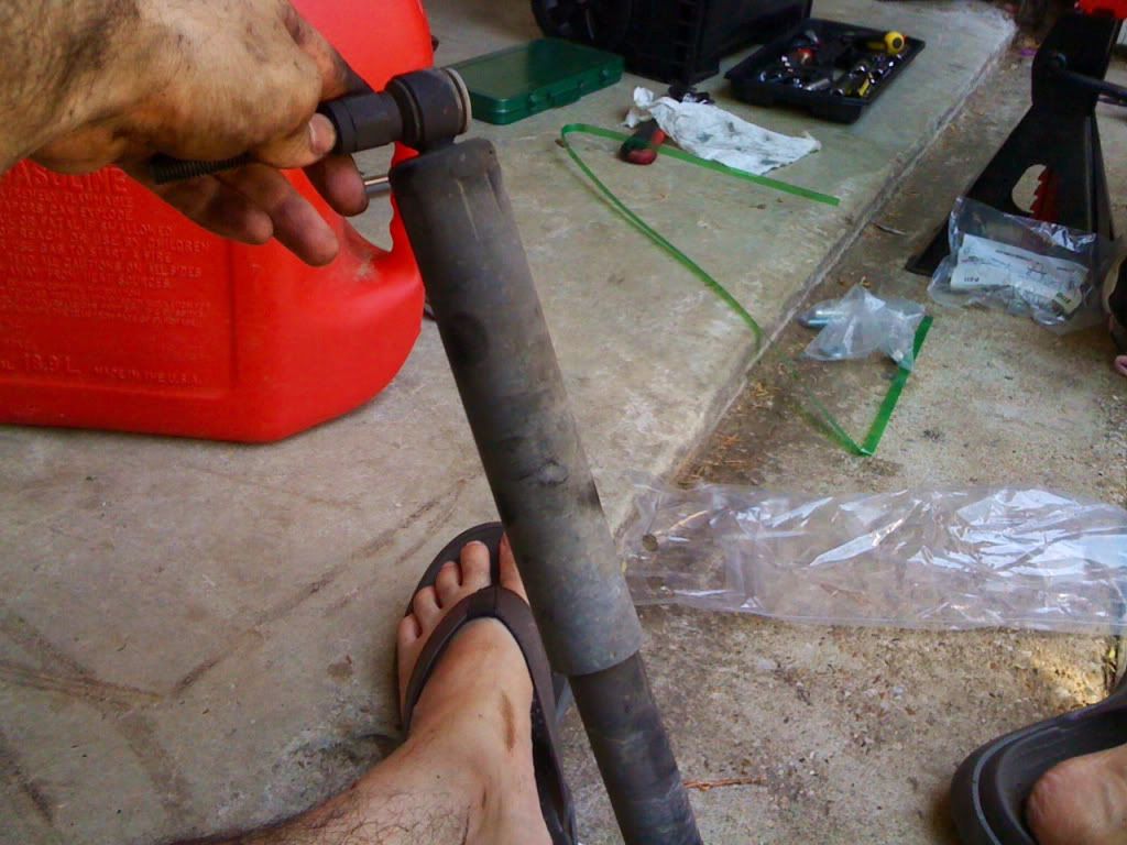

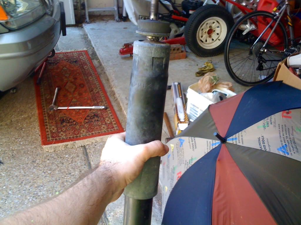

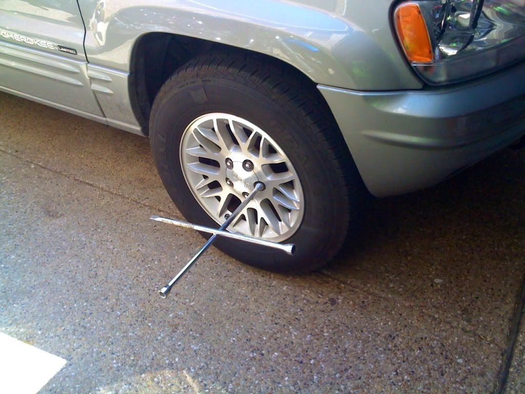

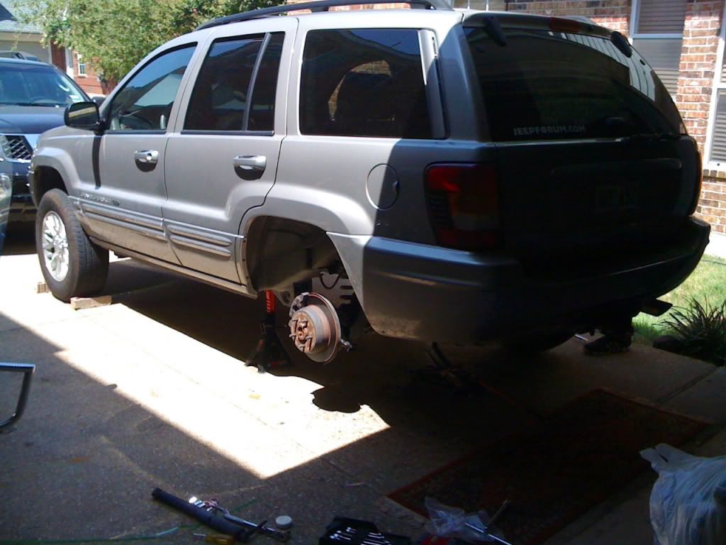

Well we finally got to install the lift today and for some reason it seemed easier than putting in my brother's bb. Maybe because we already knew what to do and what not to do.
Started by spraying some PB blaster the night before and the morning of, it helped quite a bit.
Here is a pic of the first task, removing lug nuts and front wheels
Old springs and shocks
First shock out
Coils, shocks removed and sway bar disconnected
Comparison of OME HD front spring and stock front spring
Coil and Bilstein 5100s shocks installed and sway bar reconnected
Old steering stabilizer out and new Moog one in
Ended up having to make an unplanned trip to the home depo because I forgot that the shocks don't come with hardware so I got 4 5/16 x 1/2 bolts, 8 washers and 4 nylon lock nuts
Front end finished and low end still sitting low
Rear wheels removed and ready to take out the old
Old shock and coil
New goodies in
Finished product
02 WJ Limited | 4.7L HO | quadra-drive | 3" KOLAK lift: Bilstein 5100s shocks, OME HD coils | Moog steering stabilizer | JKS adjustable track bar | 245/70R17 General Grabbers | 17" JK MOABS

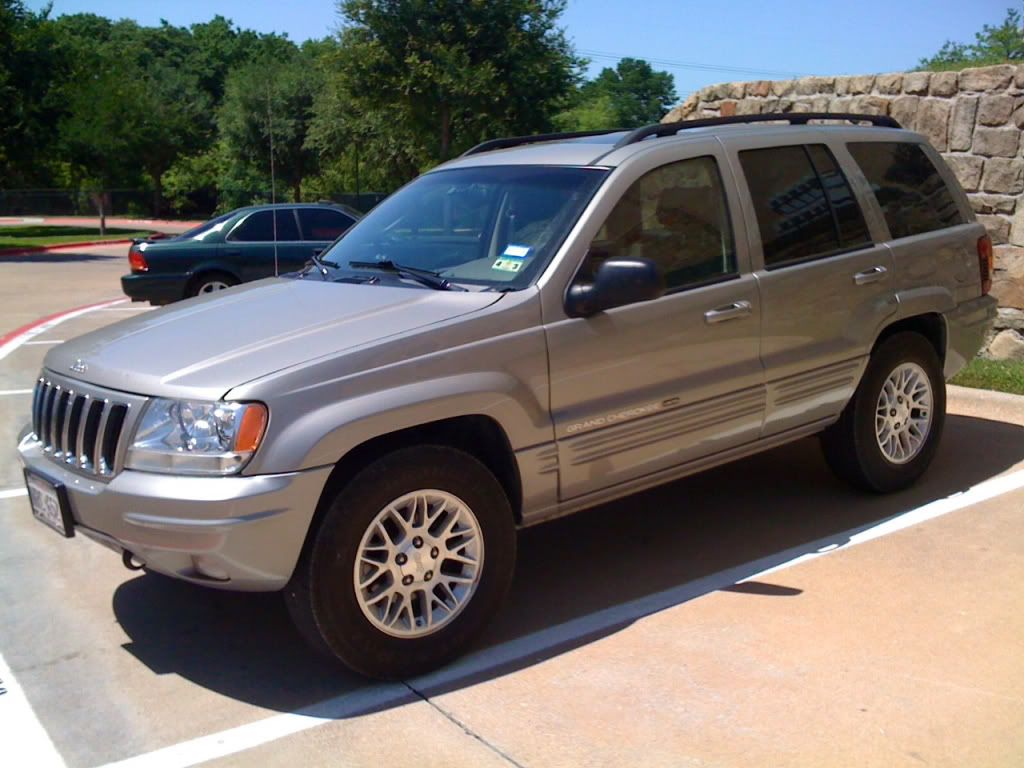

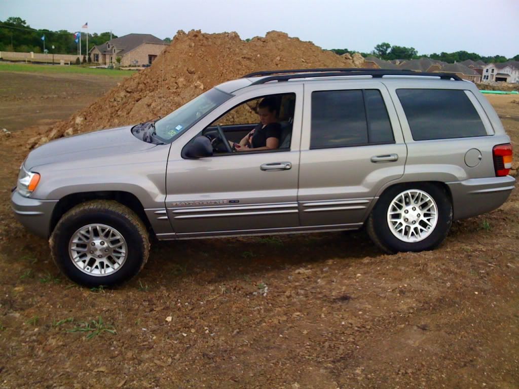

Took it around town for a test drive and it does ride softer and has a more "forgiving" feel to it but I gotta say, it feels a bit more bouncy, specially in the back. Here are the measurements prior to the lift:
FR: 18.5
FL: 18
RR: 18.5
RL: 19
After lift measurements:
FR: 21.5
FL: 21.5
RR: 21
RL: 21
So gained about 3" in the front and about 2.5" in the back. I did not replace the coil isolators at this time, I plan to do it next year as they were still in decent shape.
