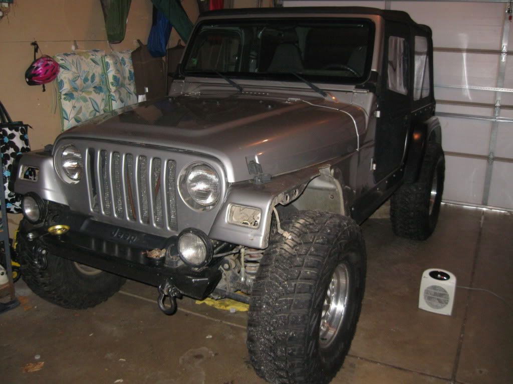

Ok well, small update. I had to stay home with my son today as he has another bout with strep. I decided to grow a pair and go work in the garage for a short time - IT'S 5 DEGREES TODAY!!
Fender flare removed, all the inner fender cuts unbolted and sitting there. Need to remove the rock slider, then just a few bolts and the drivers fender is out.
See the tiny little heater thing there next to the Jeep? Funny huh? I just about had to insert that into my rectum to get any warmth out of it - lol - otherwise it was a complete waste.
Tomorrow for my scheduled day off - 32nd birthday, I hope to have a portable salamander heater at my disposal - we'll see.

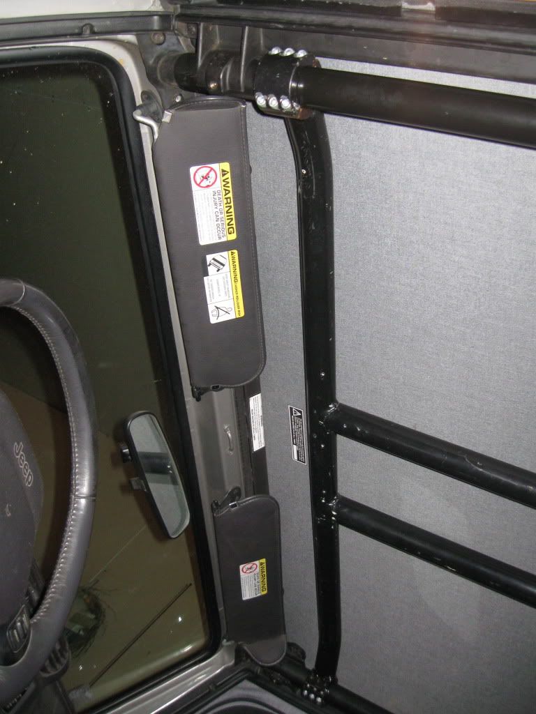

Just for giggles this was the last few weeks has gotten me - I tapped 12 holes so this cage thing could be bolted in.
Good day! My plan is to have both sliders and both fenders off tomorrow. We'll see!

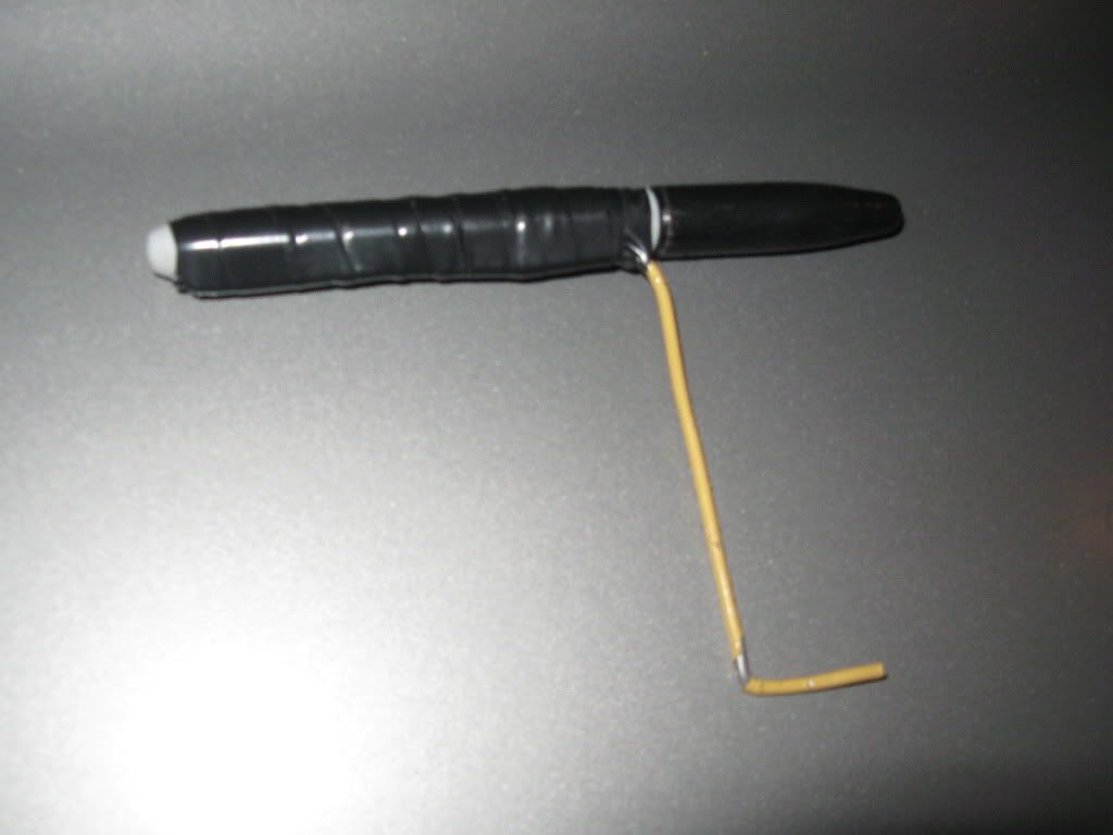

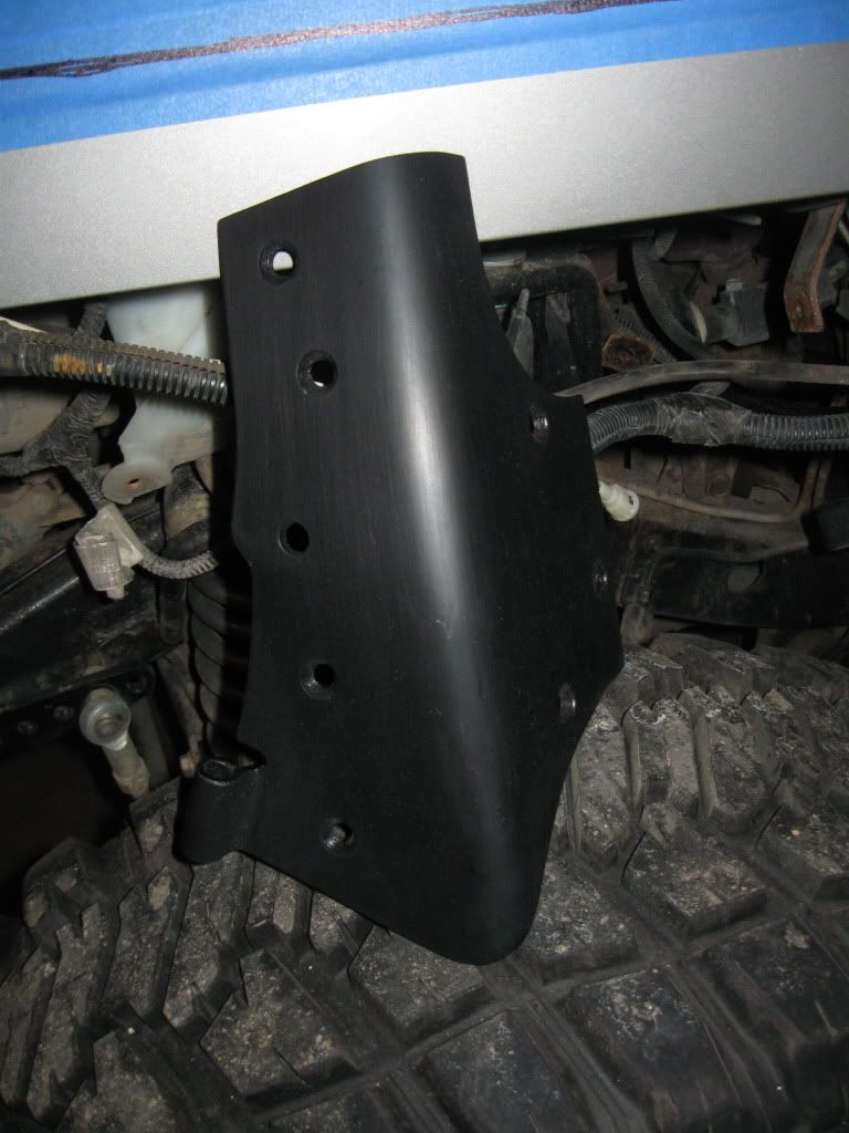

Who knew, tinkered with the Jeep for a couple minutes tonight. Made this goofy little tool set at 3.25" that I could run and make a semi-strait line for cutting - as you can tell I am still about as shakey as they come.. None the less, shes ready to get chopped. I may attempt that this weekend.

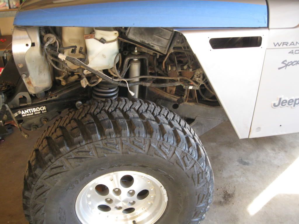

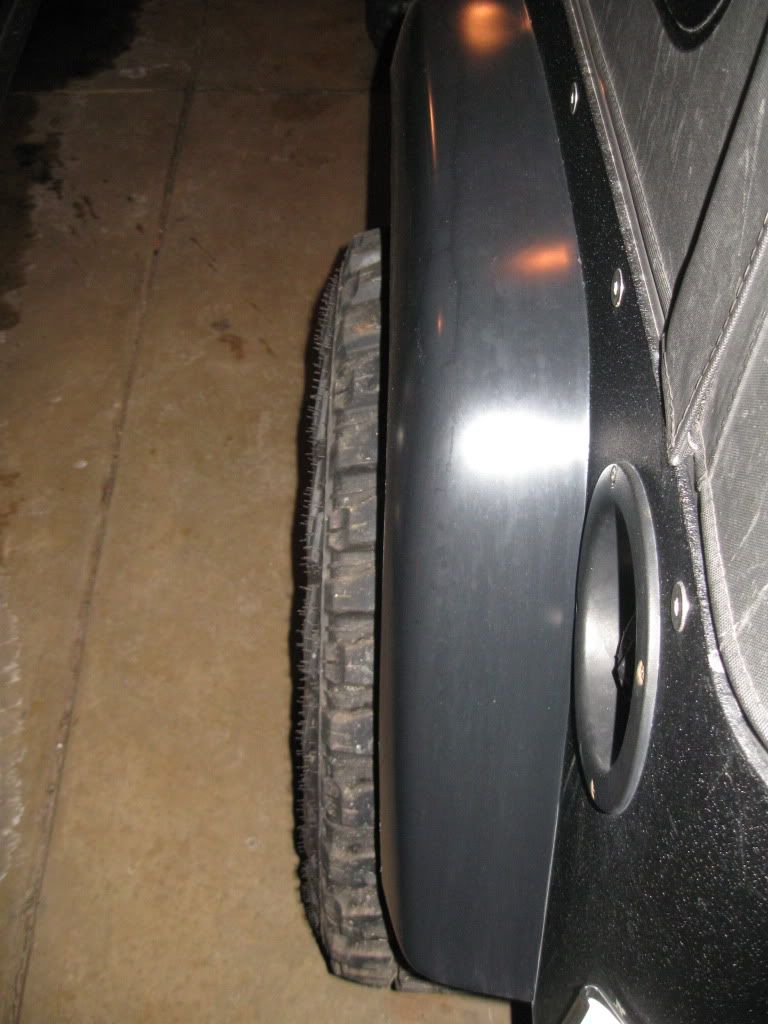

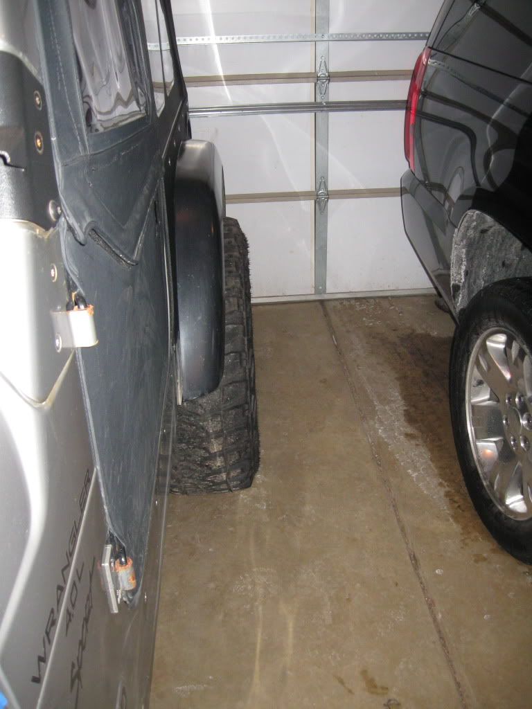

And because Janesy had me thinking - wanted to see where my tire coverage is/was. The factory Gambler wheel has 5.5" of backspace - minus 1.25" on the spidertrax spacers, I am at 4.25" of backspace. Rubi flare at 4" wide, I don't have a whole lot sticking out - which I like.
Lastly - a little JK'esq mod coming soon. A buddy of mine cut the hinges off the windshield brackets, then welded them shut(in no particular order of course). It will be painted the color of the body with the rest of items to be painted soon. He did it to his TJ and if you're good it will take a double take to figure it out.. Could be i'm living under a rock, but I've only noticed it on his Jeep. It's not like I fold my windshield down anyway..
