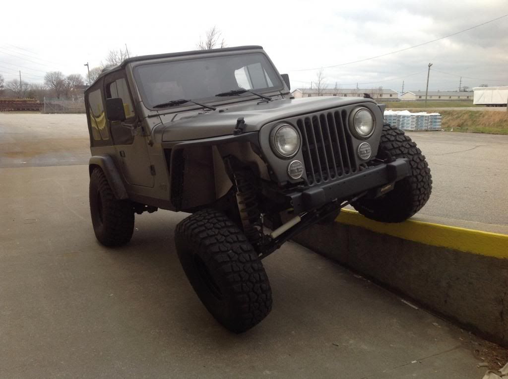

Thanks buddy! My buddy text me and let me know my side panels are done, so I'll pick those up on the way home tomorrow. "New" locker pump was in the mailbox today, so I'm excited to get that going.

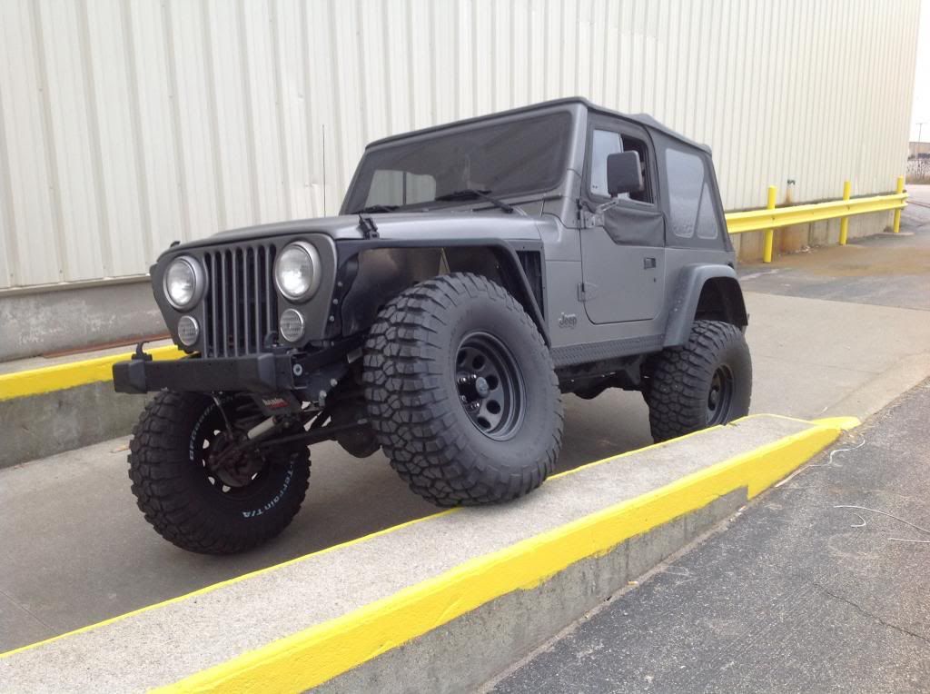

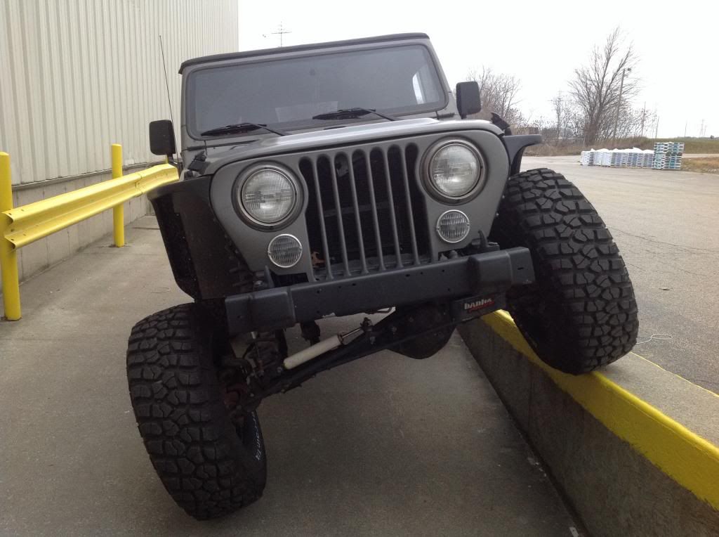

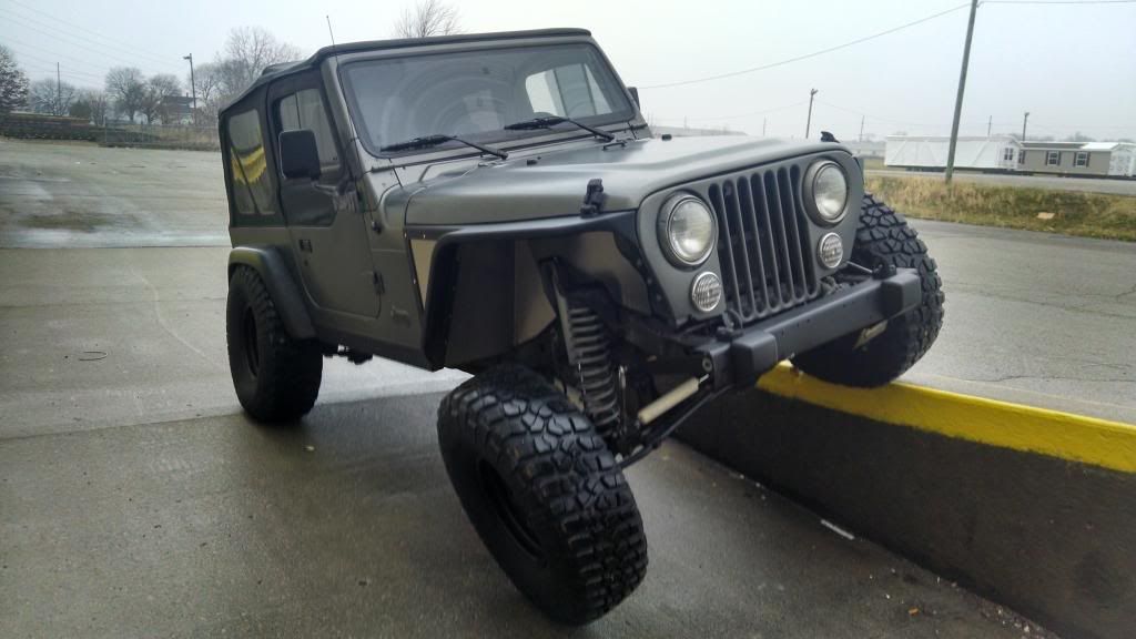

Antirock is installed, did a little testing, plenty more movement to go!
I like the grill even more now that the stock sway bar is gone.
On bump in this corner
More to go here
About 1" from hitting bump, current shock roughly 2" from full compression.
I just think this one is cute
With all that said and pictured, if I'm trying to calculate what needs to be done when it's roughly 2" lower.. In front I should be able to simply remove the bumps and have no clearance issues.
In back, I'll have to trim out the rear fender well, not sure about the bumps just yet. This wheel and tire combo has a smidge less backspace than my last LCG TJ so I may have to do something different with flares..
I've got the antirock links cut as far down as they go, so 2" lower I think I can keep them out of the inner fenders. If not, in the past I've had shorter links made by a local machine shop. My only clearance fear is the aftermarket welded on rear track bar bracket. I feel like its gonna want to pop through the floor, but I'll test the other side hopefully tomorrow in its current state.

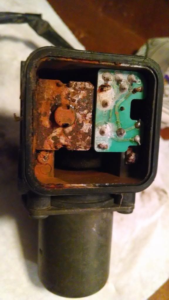

Guess who has a real live, fully functional rubicon? That's right...me! I'm so excited I could pee a little!
New pump actually wasn't plug and play, I had to grind a ear off the plug, but whatever it works!
Think this had something to do with the pump not working right?

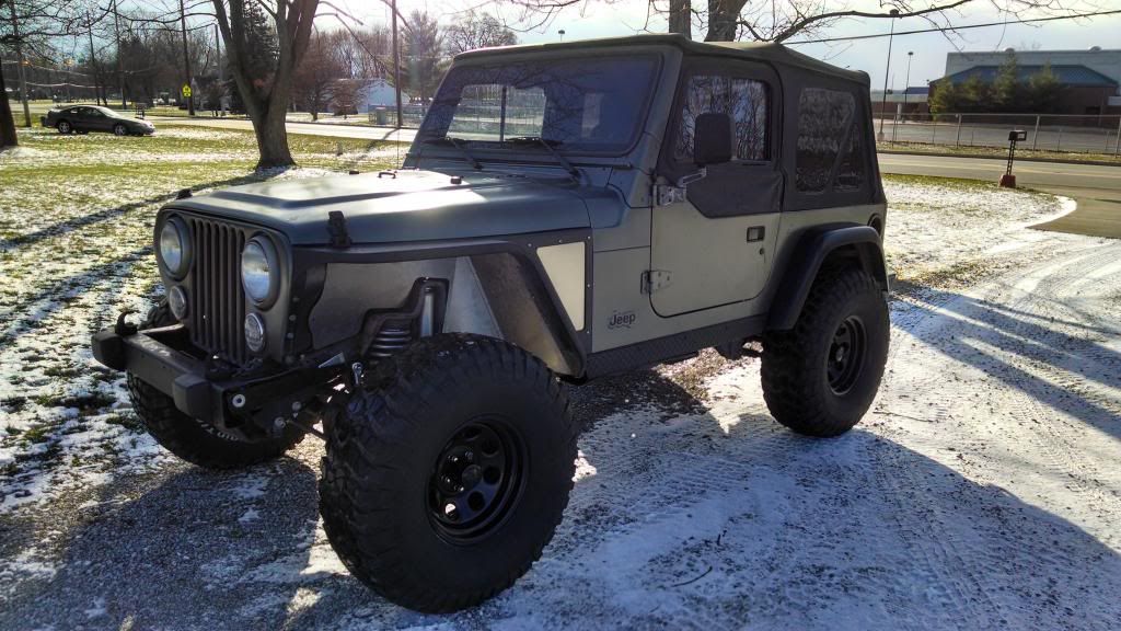

Temporary side panels are in:

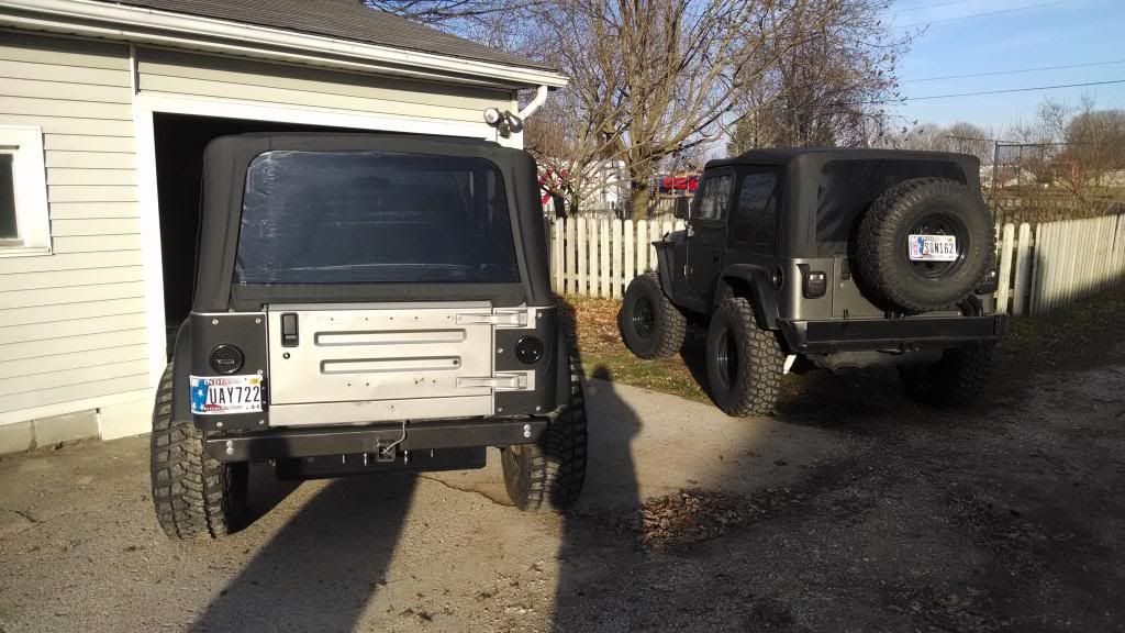

Stopped by a fellows house yesterday to see what he was up to - took a picture for irony.

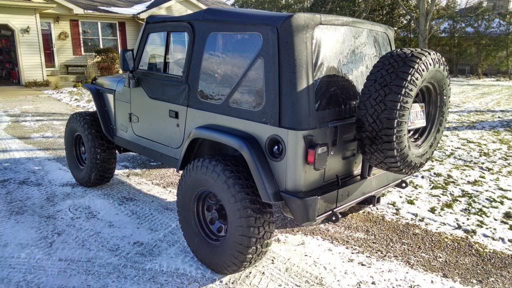

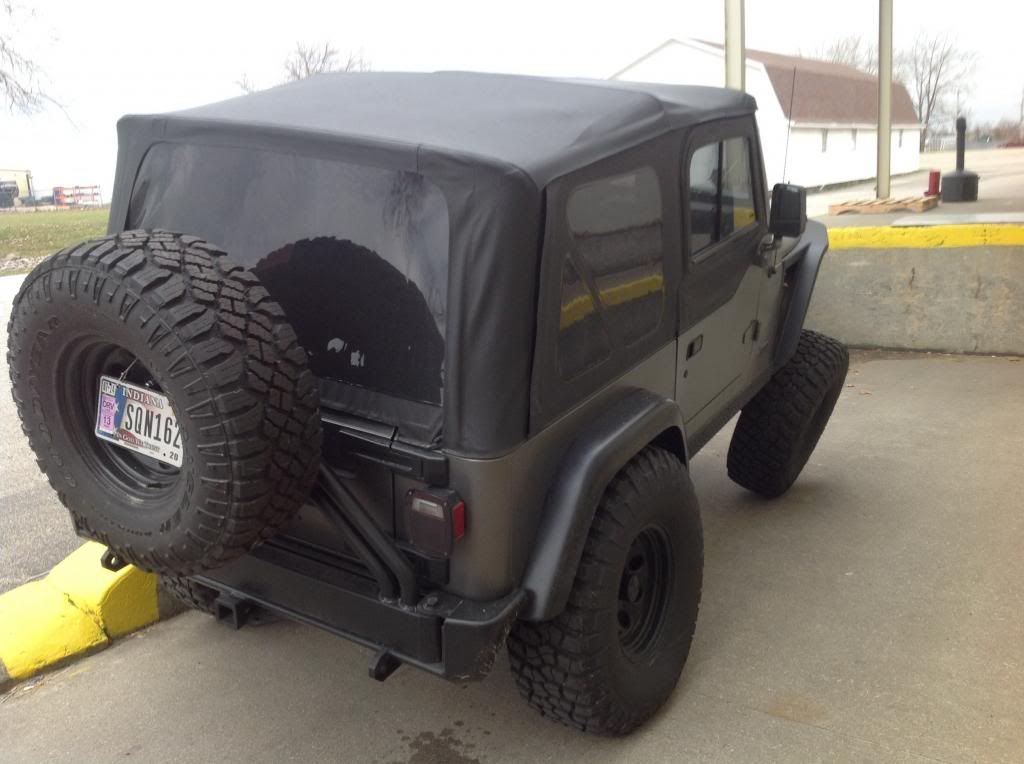

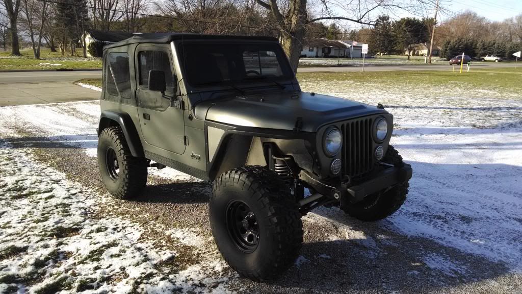

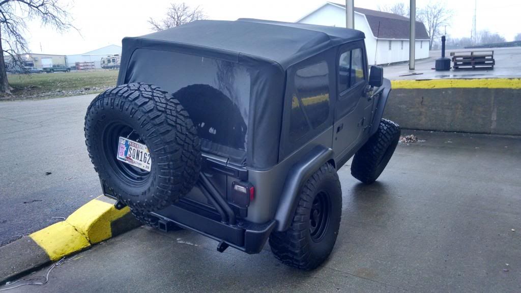

Roughly 2" lower, and it rides 13 million times better than it did. Next pics will be from the Badlands offroad park! Oh, and besides lowering it, we did that locker switch mod where the lockers can be used in any transfer case position! Thats just plain cool!
BEFORE:
AFTER: (can only really tell in the rear, IMO)

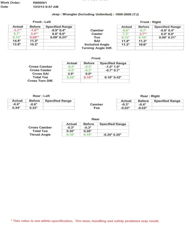

Thanks Greg! Ok, so I am back on 5.13's I guess. Havent purchased anything though. Found a great deal on all the fixin's on another site but now it appears the dude flaked out on me.
Those who know more about this, please help me disect.
So I had it aligned, obviously, and I knew ahead of time the caster was way out of wack because it was wondering badly. So I can look at the axle and see that is fine. However, some questions:
1. If at the bottom if it says in red "not within spec", why am I still seeing a value in red?
2. Vs. Right and Left. Why do the values not match? EVERYTHING in regards to my suspension is adjustable.
3. Is everything ok and I am just nit picking?

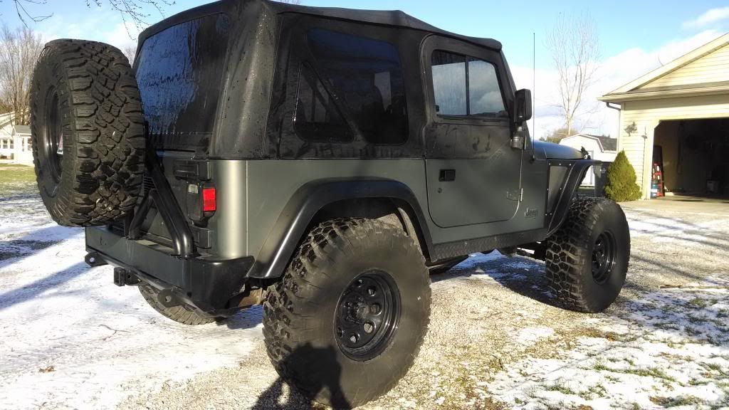

Some testing now that it has been lowered. Still more to go here, but the antirock gets into the inner fender. I "hope" to have time to try to trim the shaft down on the link before I go wheeling.
All good here. On bump, ever so slight rubbing.
I presume this is all she's got out of droop, which is fine by me
