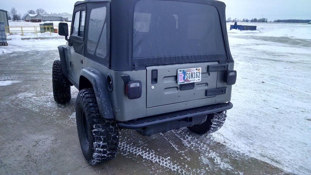

When you have very little going on, one small item can give quite a thrill. Potentially boring for some, but a small update. I am having some buyers remorse, but at least I finally have a tow point in the rear again.
Otherwise no new info. Still waiting on the front bumper. Turns out the brake bender thing didnt have the tooling to do the bends I wanted, so we had to change the design a bit. Still hoping that all gets lasered out yet today but I doubt it.
Probably wait until spring to do something with the tummy, and hopefully have a deal worked out with my new BFF and his Savvy GTS.

That rear bumper looks slick! What are you having buyers remorse over?
Buyers remorse ?
Eh, I'm just not thrilled about having $375 wrapped up in it when I could have built a stereotypical box tube bumper for less than $100. Could have used that extra money elsewhere - Defender rear flares, gears, GTS, etc. Nevertheless it does look good, and I'm the only one in the area with one like it..

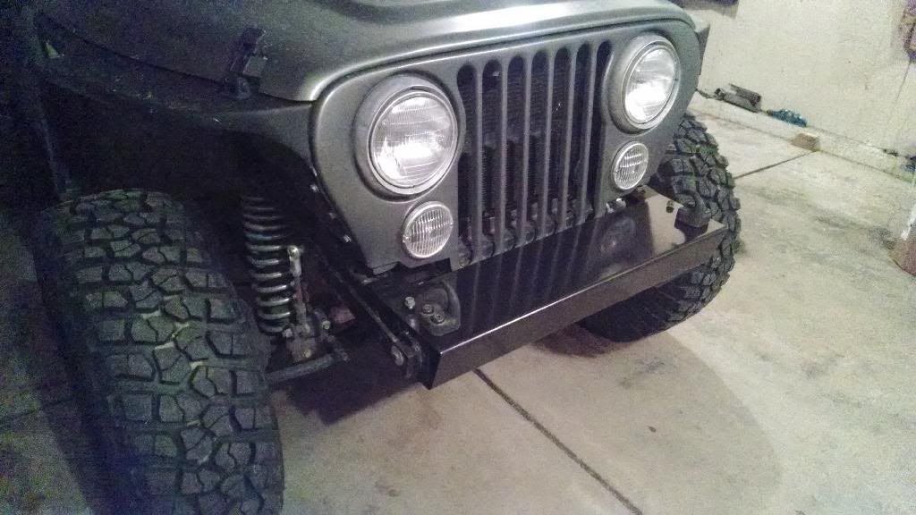

Only temporary, but finally rid of that awful stock bumper. My laser buddy still hasn't whipped up my permanent one, AND turns out he can't do acute angles, so the design will change a smidge.. It's still sans d-ring mounts, capped ends, and tube work.(grill hoop and small winch bar)
I'll snap a few more pictures later today when I can get the jeep out..
Figured out my passenger side antirock arm was loose. I fear one or both of those items is stripped. That my force my hand to purchase the aluminum arms quicker than I would have liked. We'll see.
